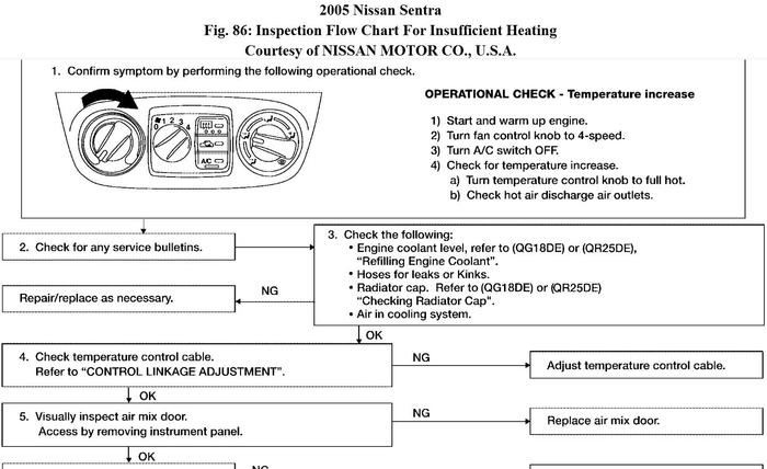

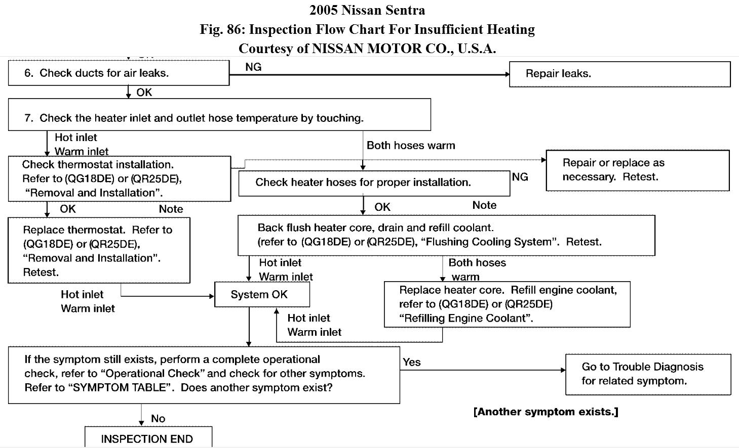

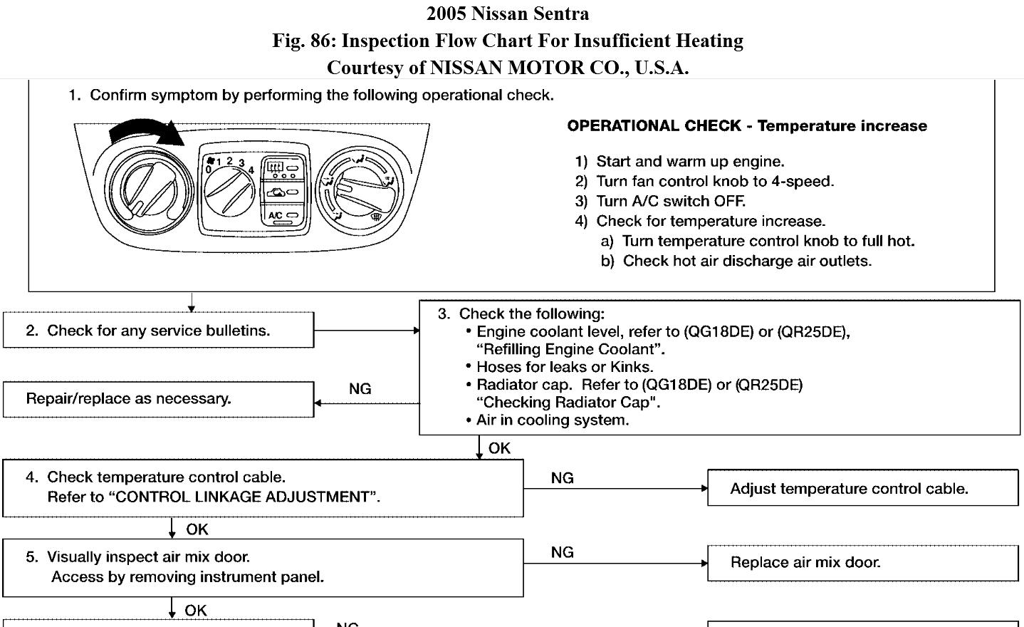

KHLOW2008
  • 41,814 POSTS
Refer to chart for basic diagnostic procedures.
