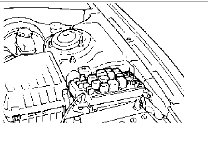

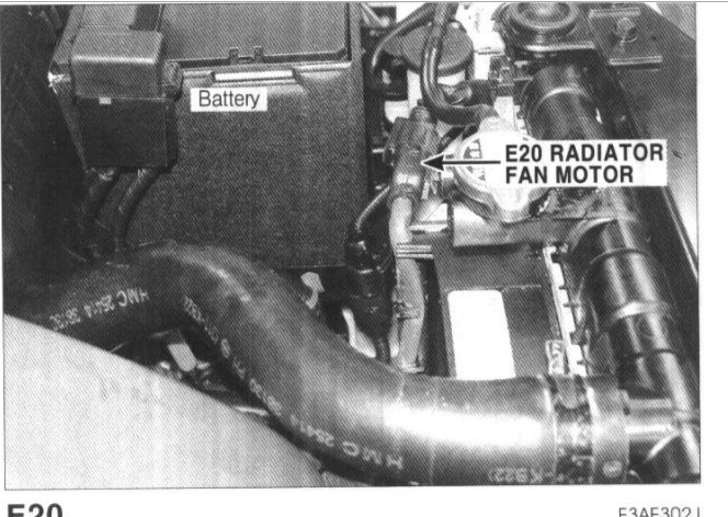

It sounds to me like you have an intermittent fan issue which can be caused by the radiator fan motor or relay. Here is a guide that that will help us do some testing.
and
https://www.2carpros.com/articles/replace-electric-fan-motor
Here are the diagrams for your car (below)
This guide can help as well.
https://www.2carpros.com/articles/engine-overheating-or-running-hot

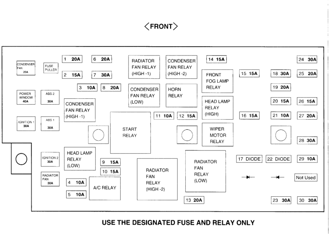

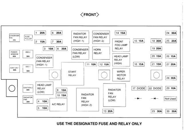

Your car has three different fan speeds possible. There is a separate relay for each one. The PCM activates each speed at different coolant temperatures. They're all in the underhood power center/fuse box. You can swap them out and see if the behavior changes. If it does then just replace them. They appear to be pretty standard relays that should be available at AutoZone for a decent price.

Again I say, check the relays. The low speed one should be kicking on well before 207.
