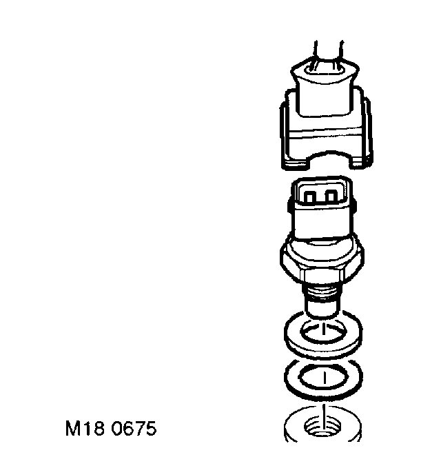

Most likely the coolant temperature sensor. Here are the directions for replacement. The attached picture correlates with these directions.

picture 1

Happy to help. Let me know if it takes care of the issue. Also, when you are doing the work, make sure there are no damaged wires to the sensor and when disconnected, make sure there is no damage in the connector. I recommend using a dielectric grease on the connector to prevent corrosion and improve contact. By the way, since the engine really isn't overheating but the gauge says it is, the sensor should take care of the problem.
