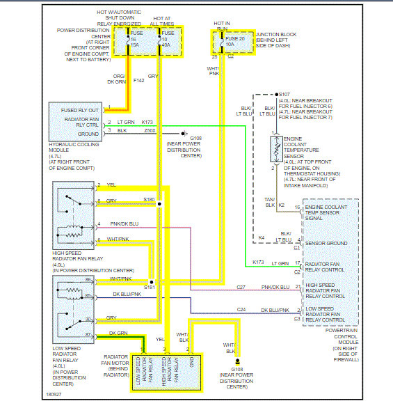

If there is air in the system from a leaking head gasket, the fan will not work long as it needs to be in coolant to send the proper signal to the relay for turning on the fan.
I attached the wire diagram for you to view. Check the fuses for power with the key on to be sure power is sent to the relays.
