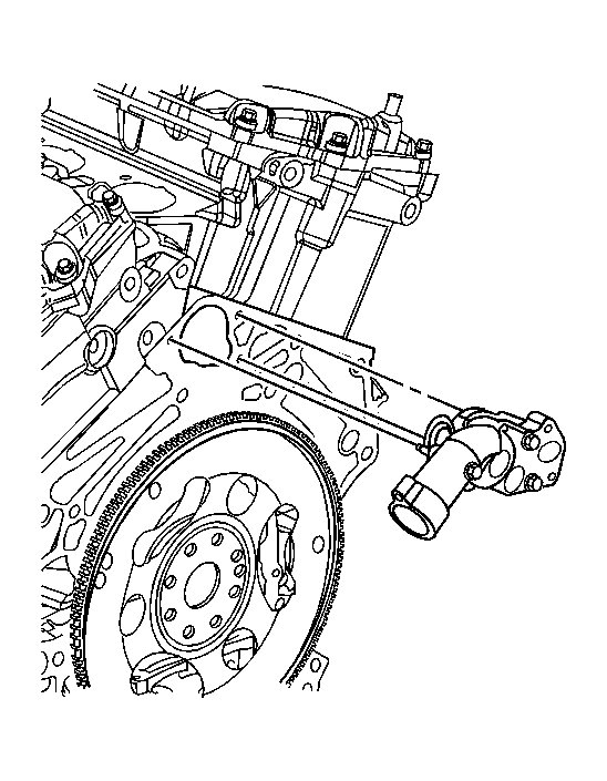

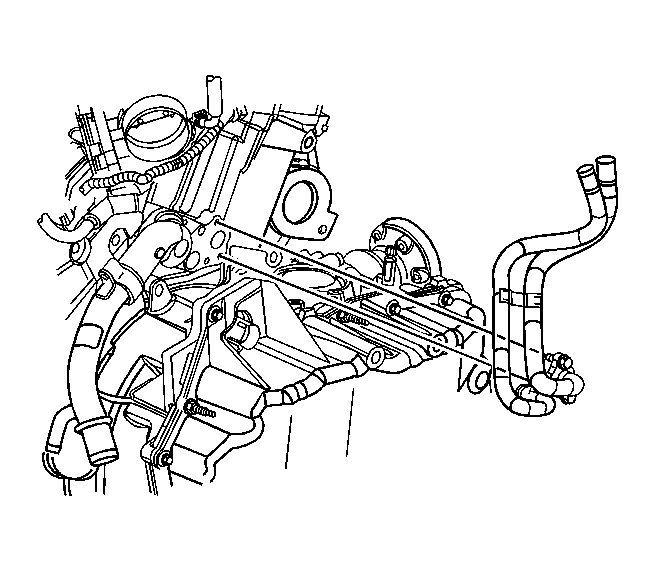

Okay, so the problem should not be air related. That points to the thermostat being the issue even more. The pictures show the thermostat location on that engine. Basically right over the flywheel. The first picture shows the heater pipes that have to be removed to get the thermostat off. Testing the fans involves using a scan tool to verify the temperature they switch on at based on the output of the coolant temperature sensor (which I would probably replace while you have the coolant drained, just as a preventative item).
