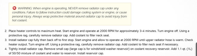

make sure tstat is in correctly and not upside down. try bleeding system see pic. also when hot feel radiator for cold spots if you feel any rad may be bad. finally have coolant system pressure checked for a bad head /intake gasket.
