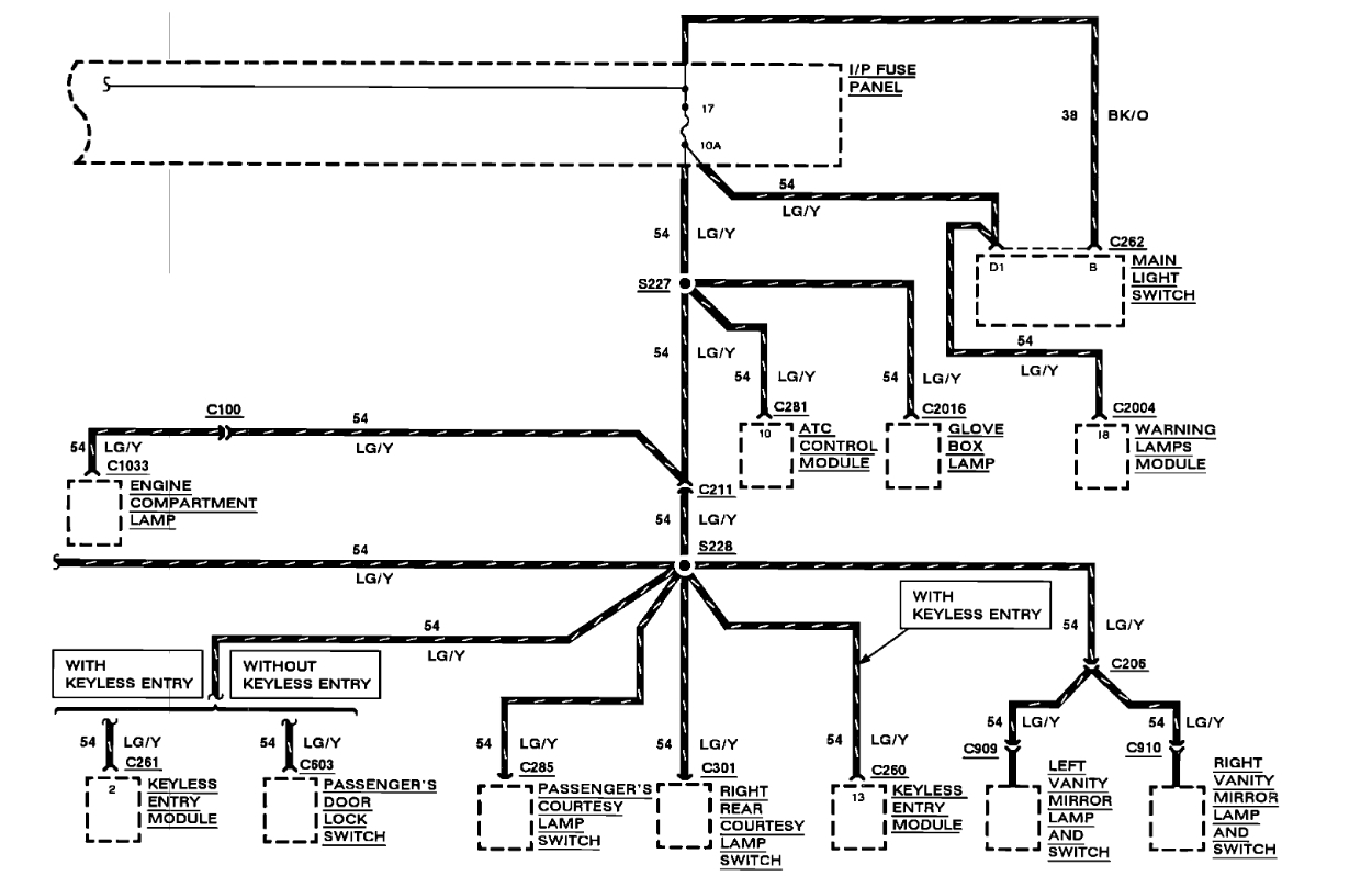

It looks like all of your problems come down to fuse 17. It controls interior lights and your key-less entry. Fuse 17 powers the glove box lamp, vanity mirror lamps, trunk lid lamp, engine compartment, and all four courtesy lamp switches. The courtesy lamp switches control operation of the curb illumination lamps, the lock cylinder lamps, the under seat lamps and the dome lamps. On vehicles equipped with key-less entry, the key-less entry module operates the same lamps as the courtesy lamp switches operate.
I have added the wiring diagram so you can see for yourself. Fuse 17 is located in the interior fuse panel which I believe is under the steering column.

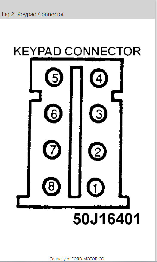

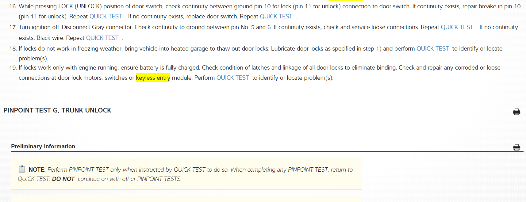

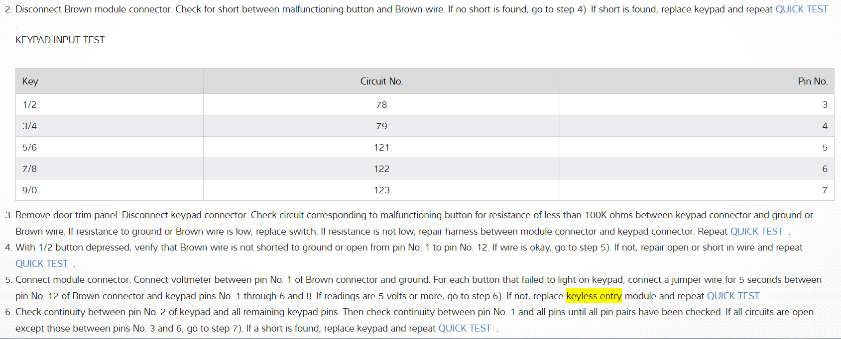

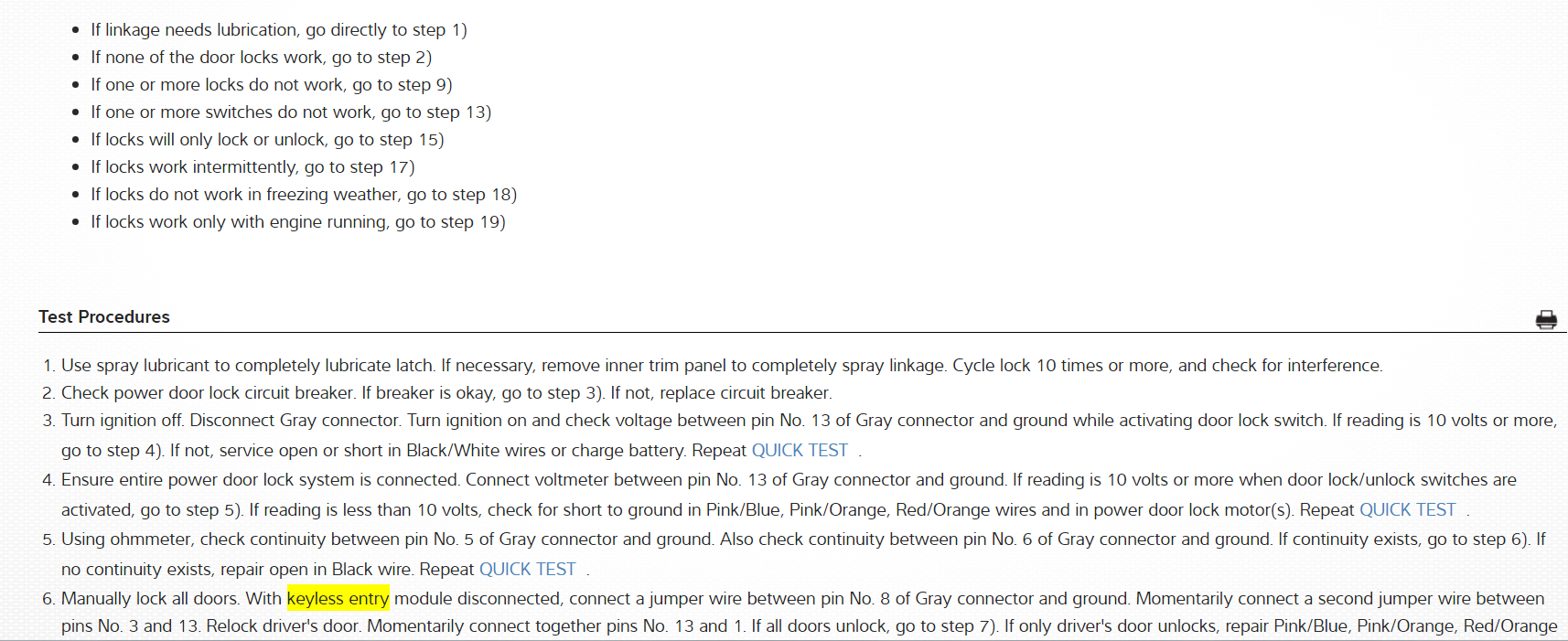

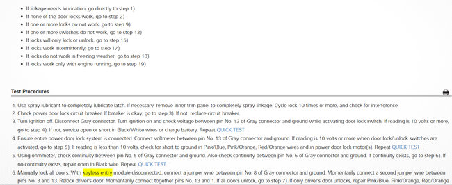

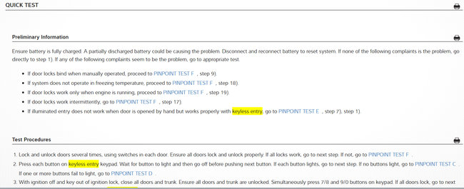

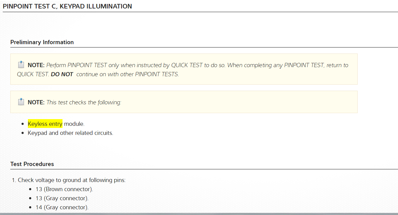

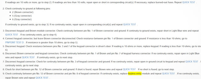

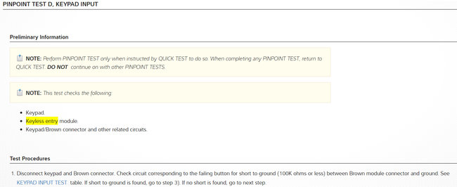

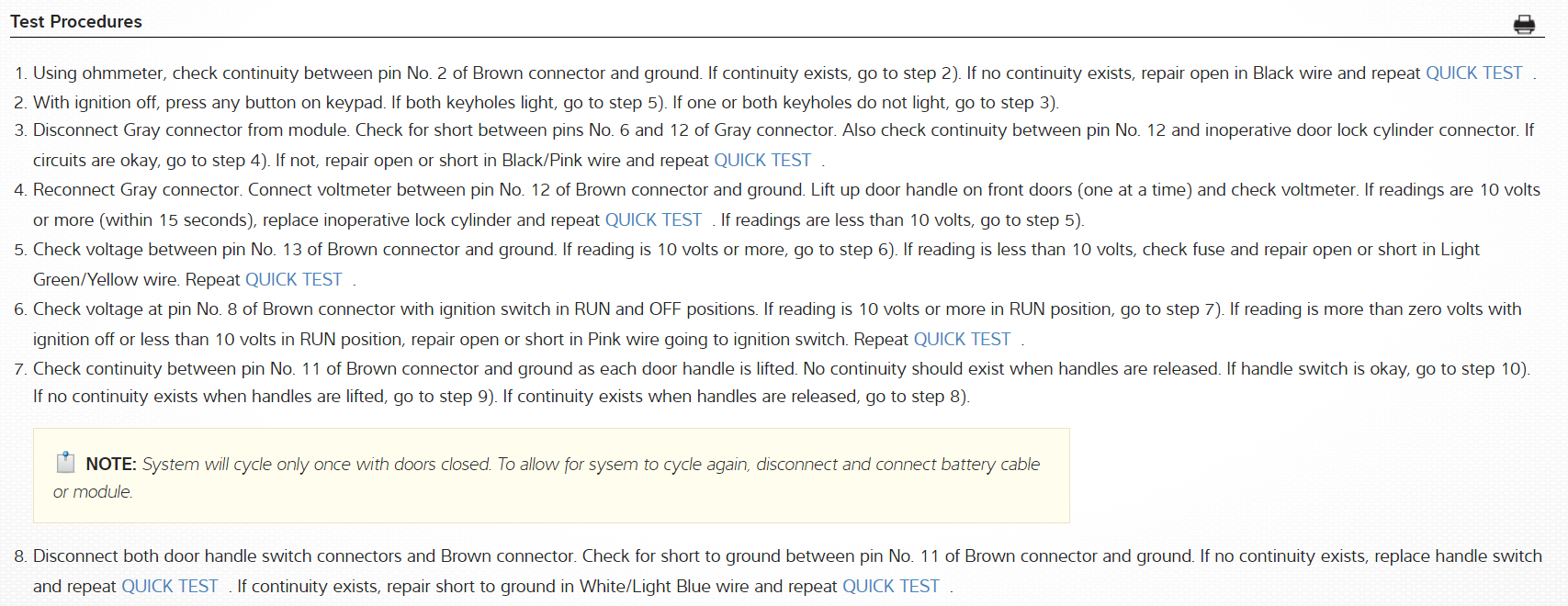

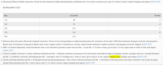

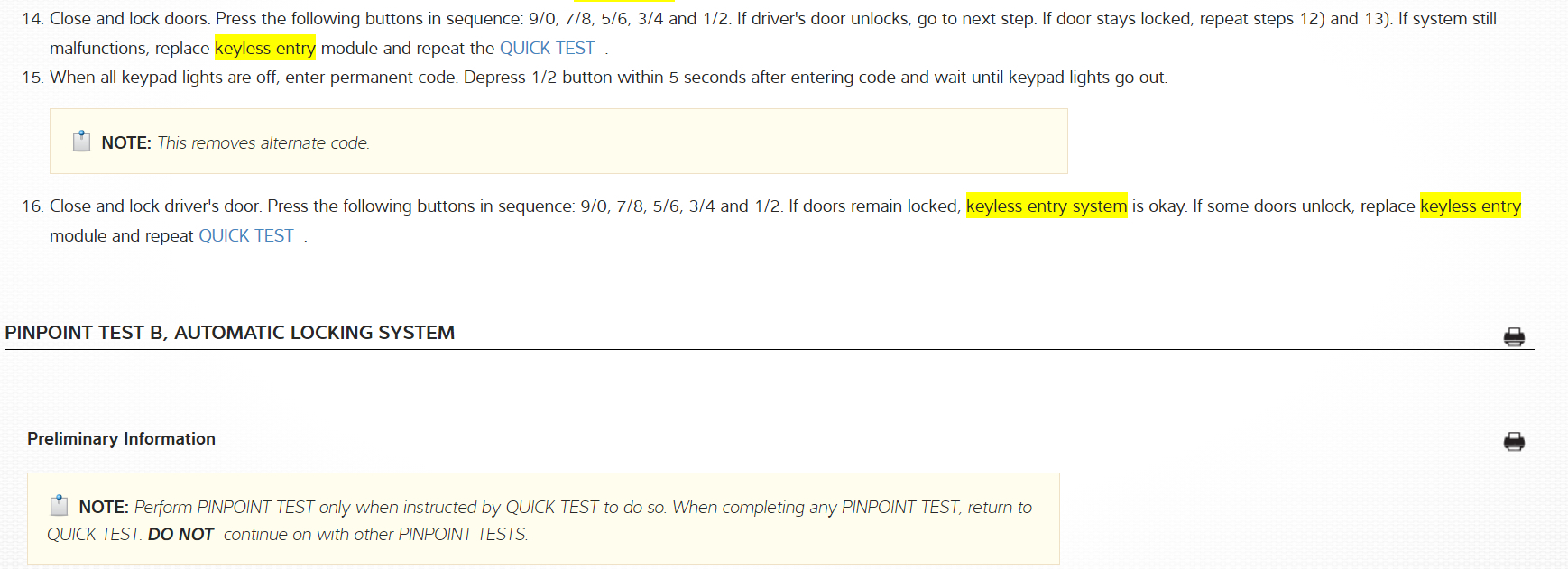

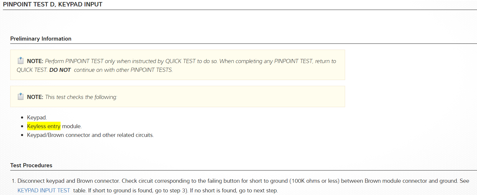

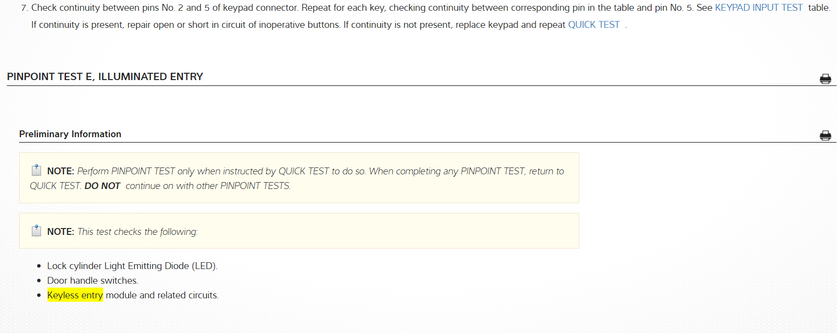

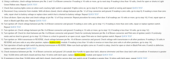

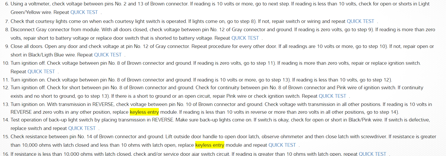

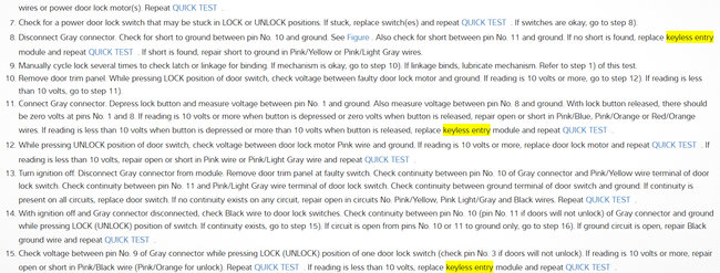

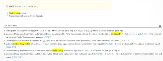

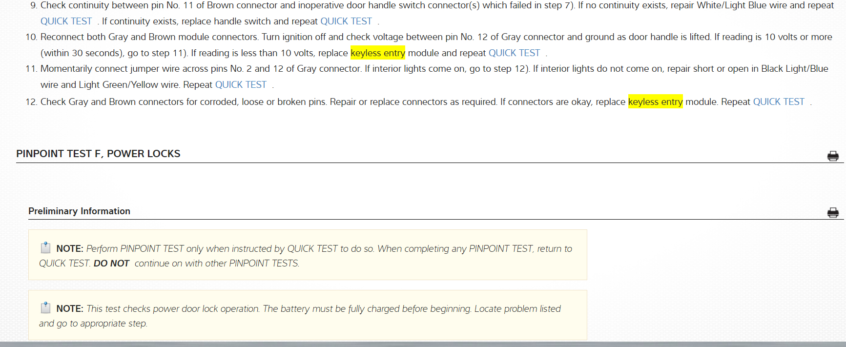

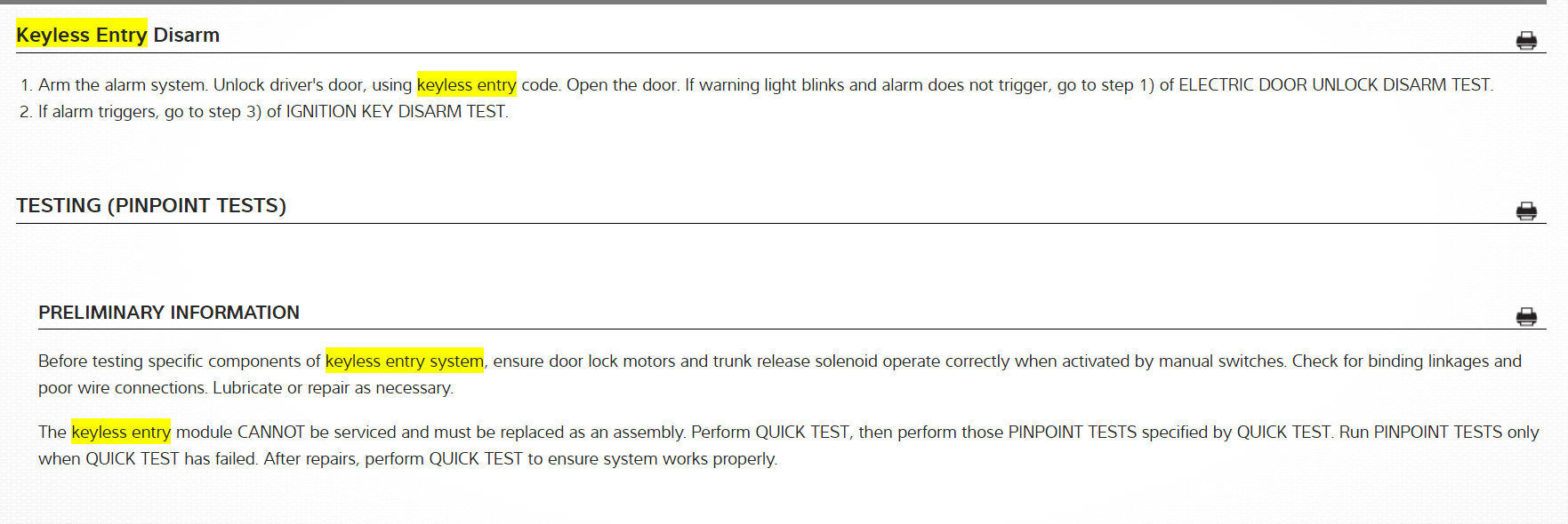

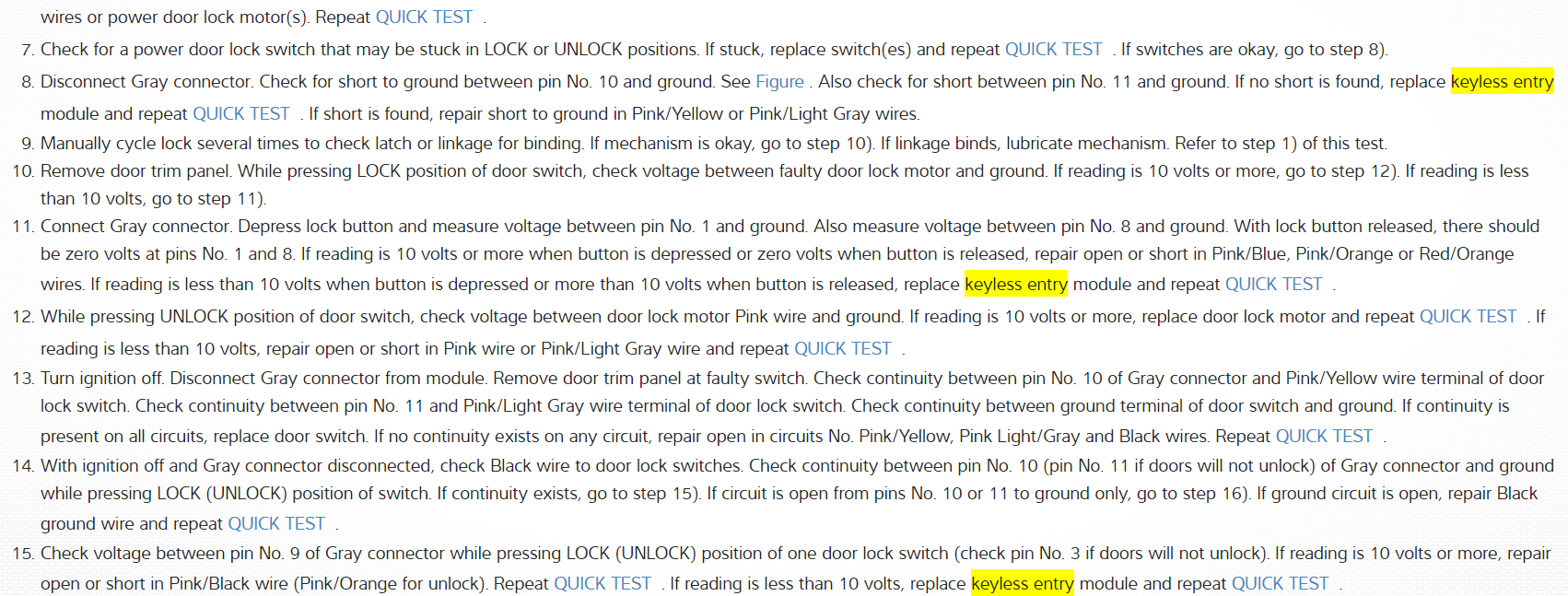

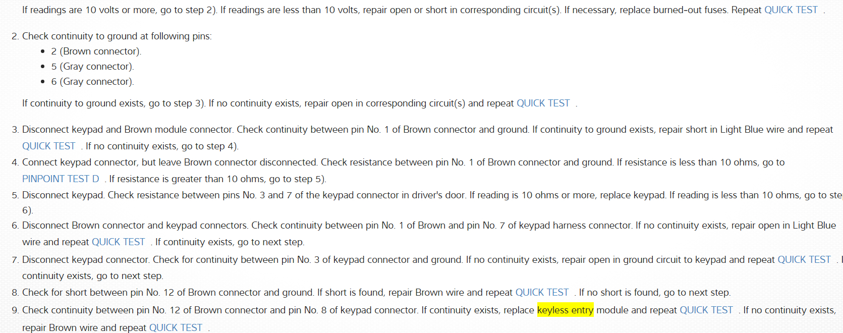

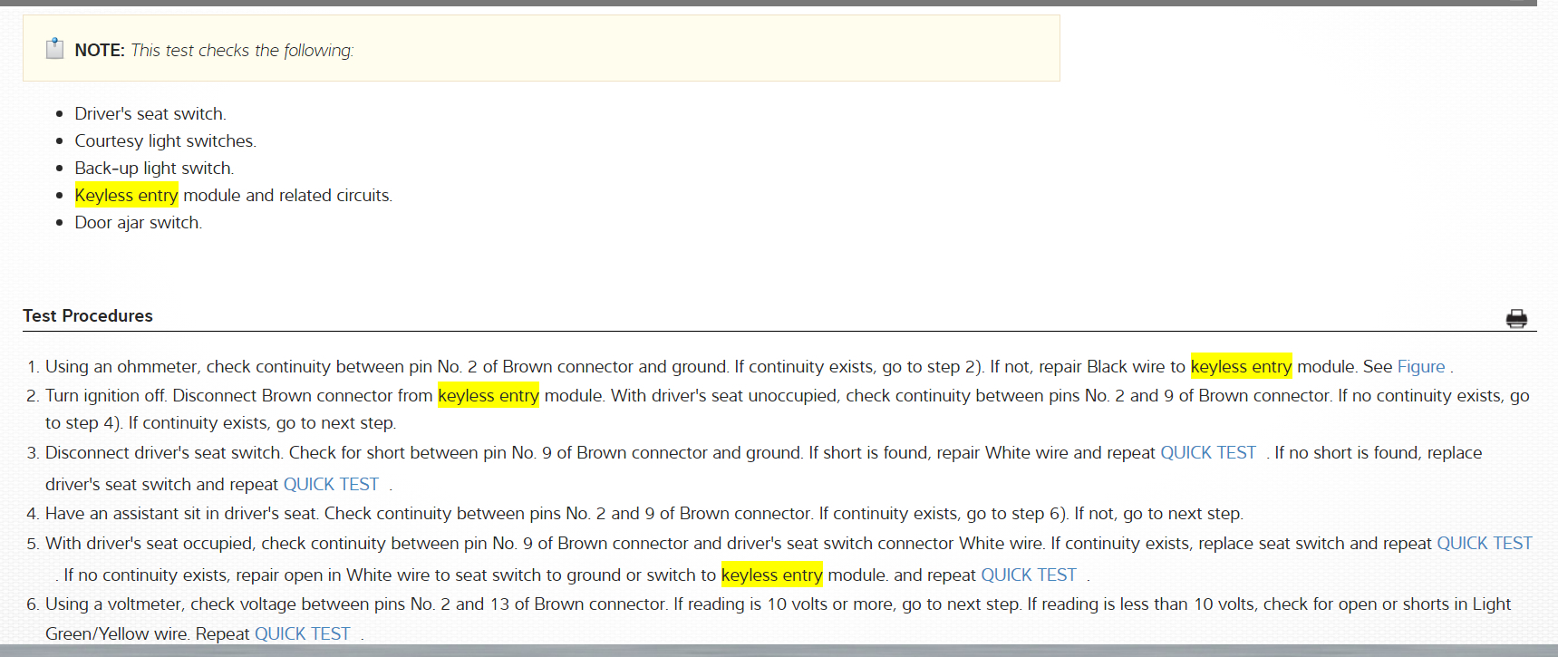

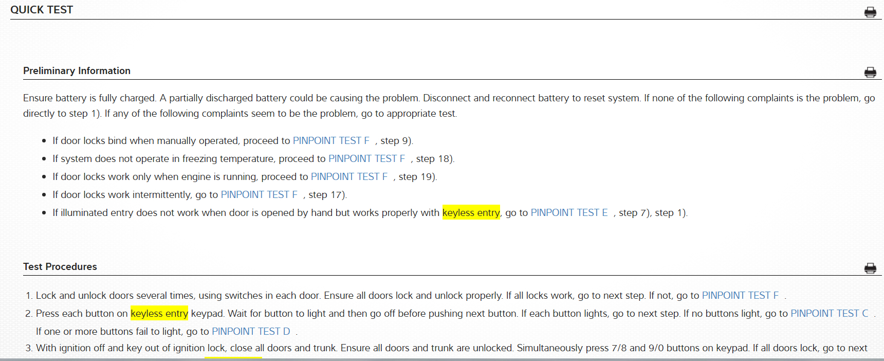

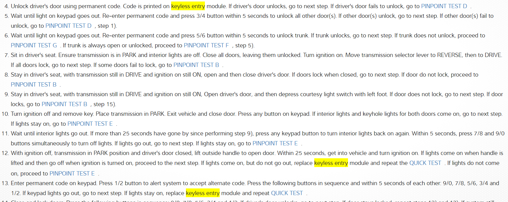

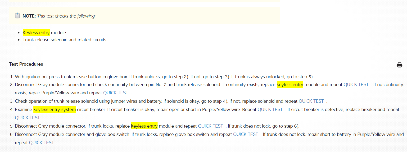

This could be a problem with your automatic locking system. In the diagrams below I have included manufacturer troubleshooting flowcharts with pinpoint tests. Please go through them and let us know what you find out.
Thanks,
Alex

Hello again,

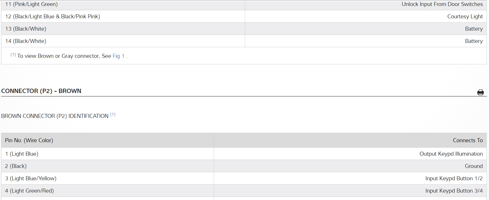

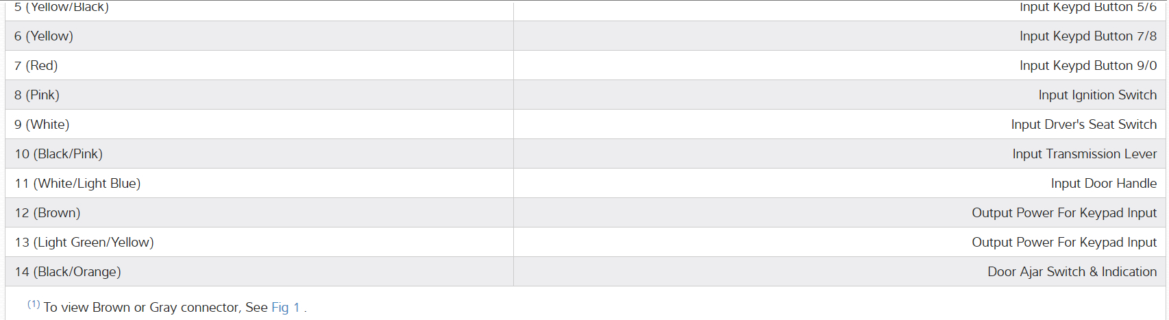

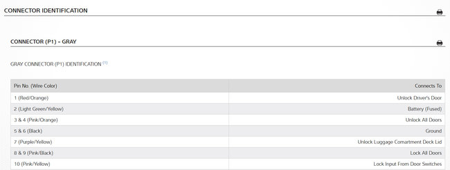

Honestly it sounds like have a short to power somewhere in the circuit. I have included the information you requested in the diagrams below. If you do decide to fix the system please use the troubleshooting pinpoint tests I gave you earlier. They really are straight forward and do not require any special tools to go through them. I hope this helps.
Thanks,
Alex
2CarPros

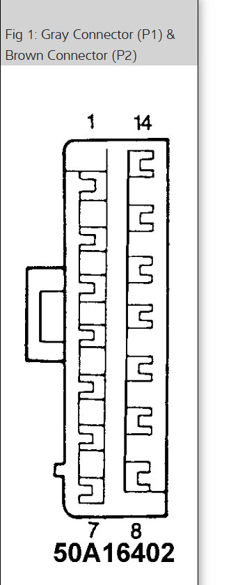

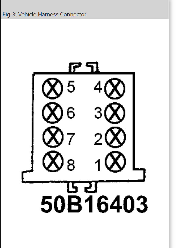

Well I found the module for the key-less entry. Unplugged it and it did solve the problem with the lights however it turn off several other things also, including the airbag suspension. So tomorrow I will plug it back in and try something else. Can't drive without suspension. I am off Wednesday so I will spend the day trying to figure out the pinpoint tests that you provided. The module plug had eight different wires into it. If I could figure out which one turns off the key-less without turning off the suspension I would try to cut just that one. And the search goes on. Thanks for your help.

Hello again,
The tests I sent you shouldn't take that long to do and will lead directly to what the issue is with your vehicle. It might seem like a lot, but it really isn't. And it will be fixed right. Let us know what you find out.
Thanks,
Alex
