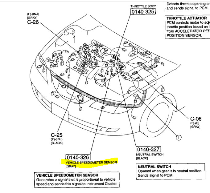

Are you looking for the turbine input speed sensor or the speedometer speed sensor? If it is the speedo, I attached a pic below showing the sensor's approximate location.

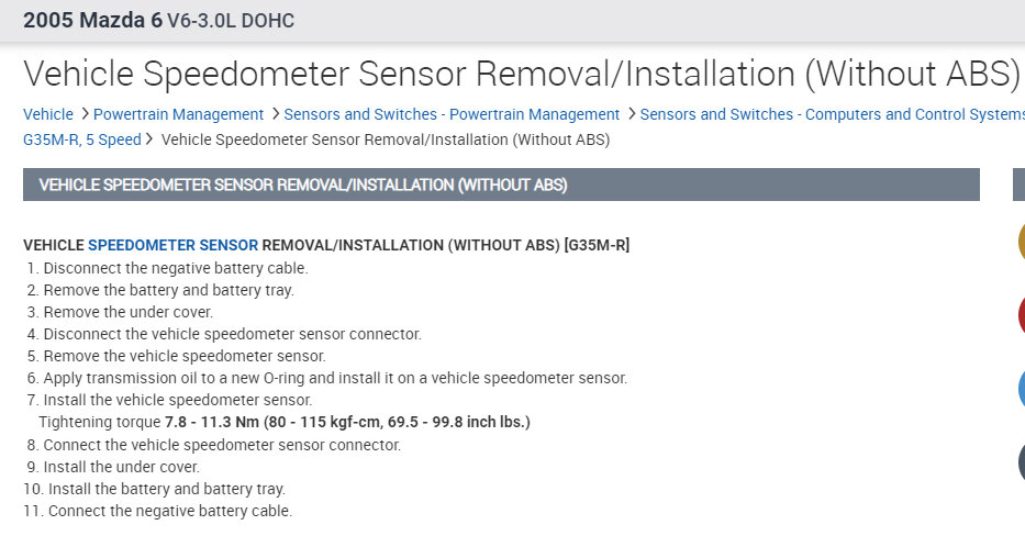

Pic 2 are the directions for replacing it.
Let me know if this helps or if you have other questions. Note that the manual does not refer to an output speed sensor. I suspect it is the speedo speed sensor.
Let me know what you find.

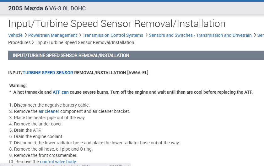

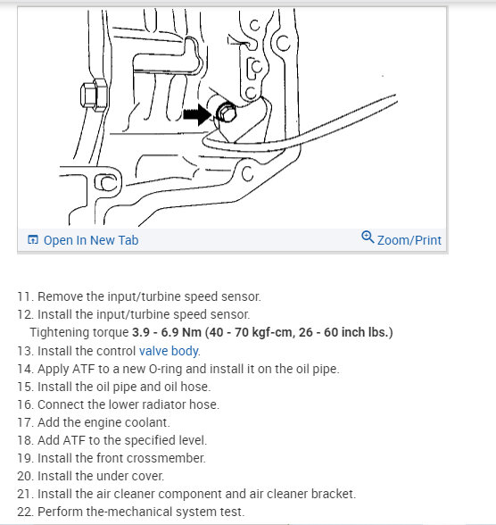

The only other thing I am finding is the input turbine speed sensor. That requires the valve body to be removed. But I just went through another manual and found the same thing for the output.
I attached the directions below for the input sensor. They are vague, but it will give you an idea of the process. It isn't a 10-minute job.
