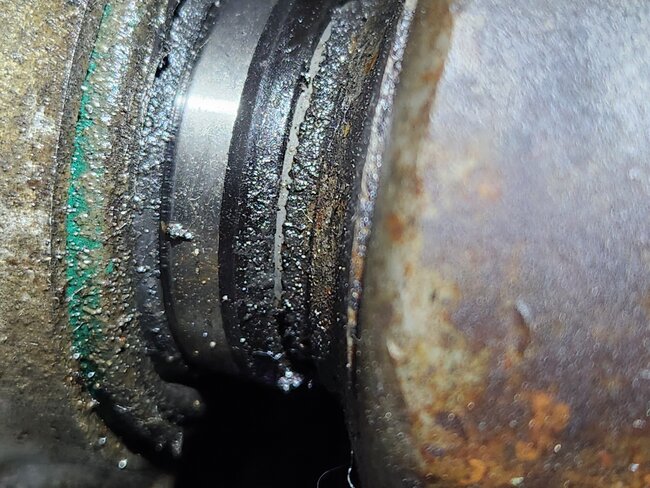

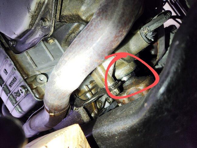

I was told I need to replace the output shaft seal right. I'm getting confused with crankshaft, axle, etc., terminology, which seems to be interchangeable in some cases?
Because of a lot of wet splatters around this area on passenger side of the car I assume this is the "output shaft seal (right)" that the car shop was talking about. And it is also the right axle that needs to be removed to replace it. Seems like this might be a very delicate job and may require replacing transmission oil too?

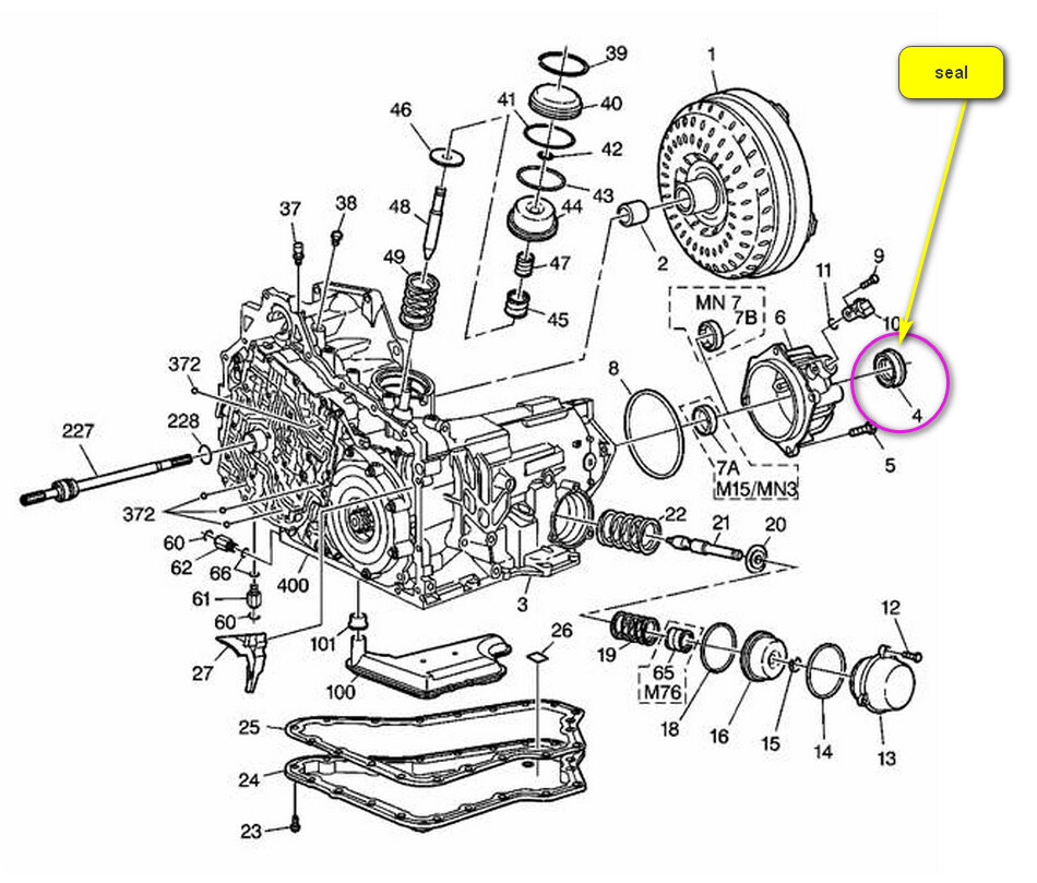

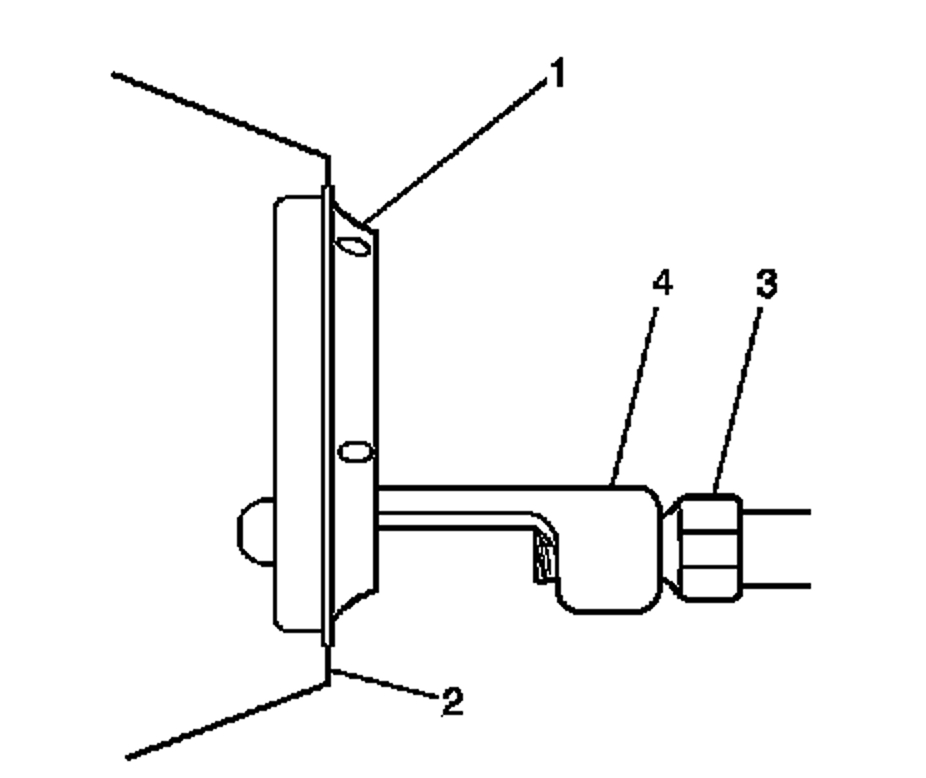

8.Use the J 6125-B (3) and the J 23129 (4) to remove the oil seal (1) from the extension housing (2). See image 1below

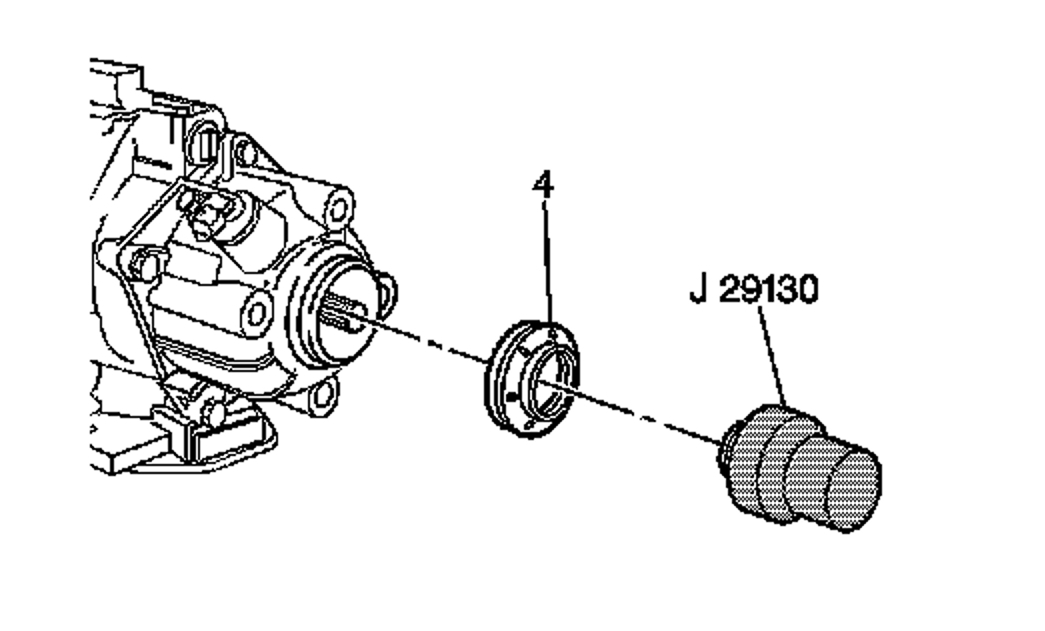

Installation Procedure
1.Lubricate the seal lip with transaxle fluid.
2.Install J 37292-B in the seal (4).
3.Use J 29130 to install the new seal (4).
4.Remove the J 37292-B
See image 2 below
Important: Carefully guide the axle shaft past the lip seal. Do NOT allow the shaft splines to contact any portion of the seal lip surface.
