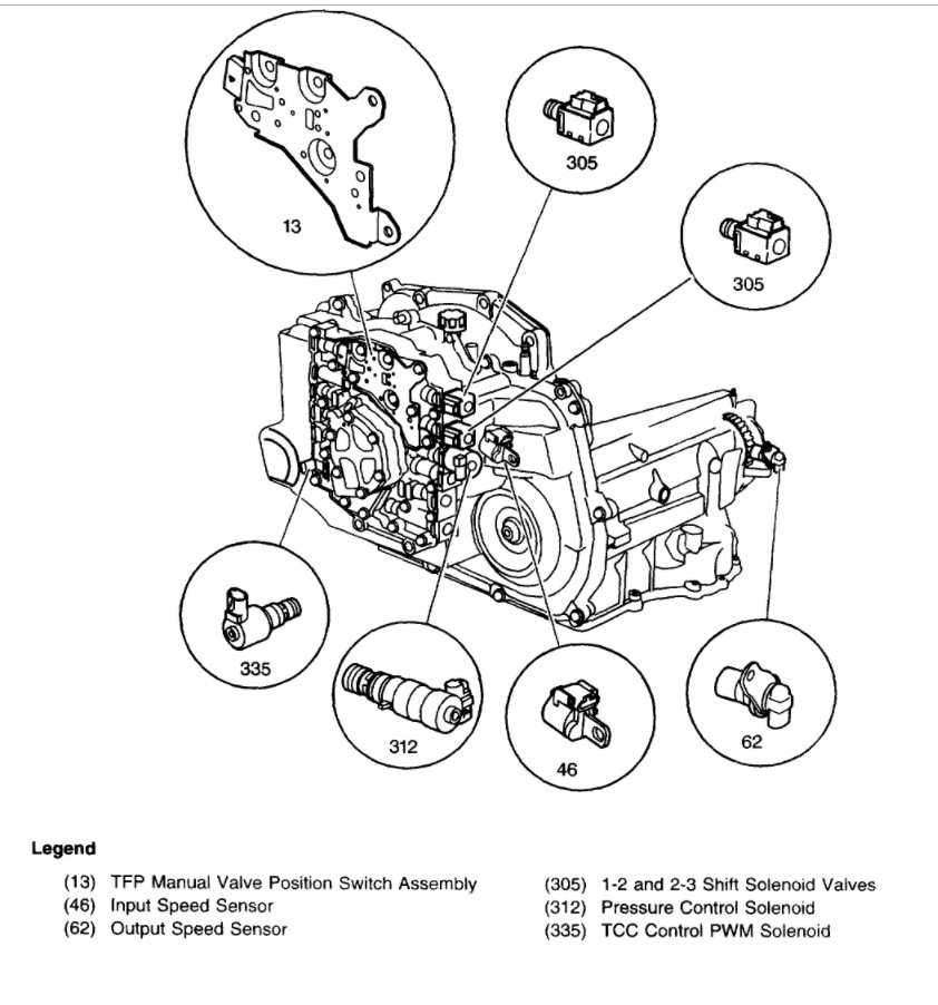

Where do I find them? Replaced one but cant find the other one.
Feb 20, 2015 at 12:57 PM
I have found this diagram (below) to show you where each of the speeds sensors are located.
