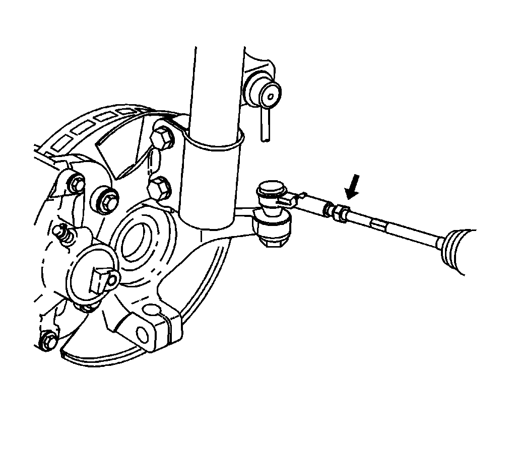

Old parts I'm trying to get off do not belong on this car. There is no nut above the tie rod end. There was no crown nut. No carter key. I am trying to un screw the tie rod end off but it is spinning the whole tie rod no matter how tight i hold it. Please help. Thank you for your help in advance.

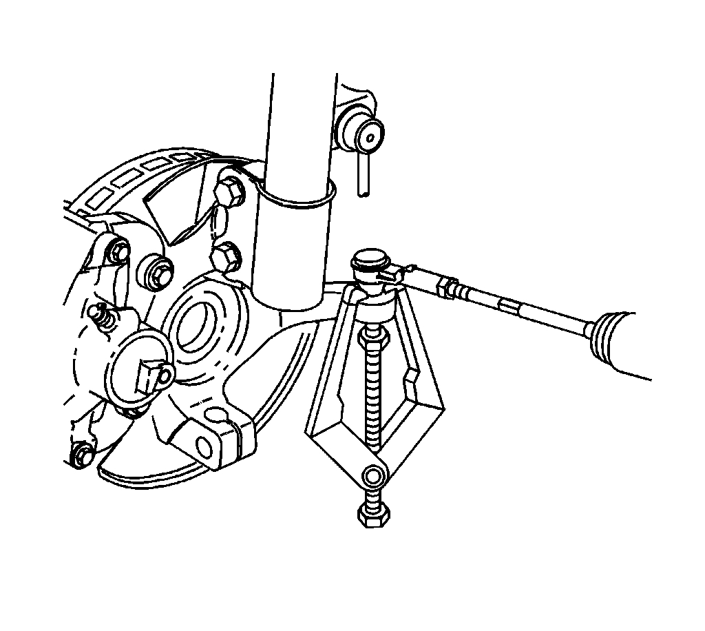

Here are the directions for replacing the outer tie rod. See if there is anything different shown. Also, the first set of directions are for a front wheel drive and AWD models outer tie rod. The attached pics correlate with the directions.
PROCEDURES
Rack and Pinion Outer Tie Rod End Replacement
^ Tools Required
- J 24319-B Steering Linkage and Tie Rod Puller
Removal Procedure
1. Raise and support the vehicle.
2. Remove the front tire assembly.
pic 1
3. Important: Mark the location of the jam nut for installation.
Loosen the tie rod inner jam nut.

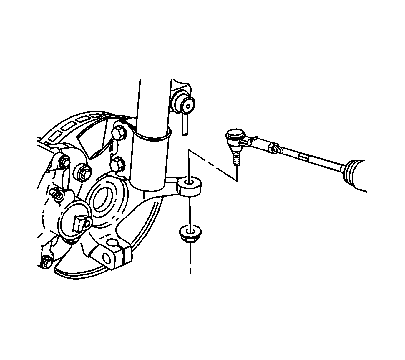

4. Important: Hold the ball stud to prevent turning during removal of the nut.
Remove the tie rod to knuckle nut. Discard the nut.

5. Notice: Do not free the ball stud by using a pickle fork or a wedge-type tool. Damage to the seal or bushing may result.
Use the J 24319-B to separate the tie rod from the steering knuckle.

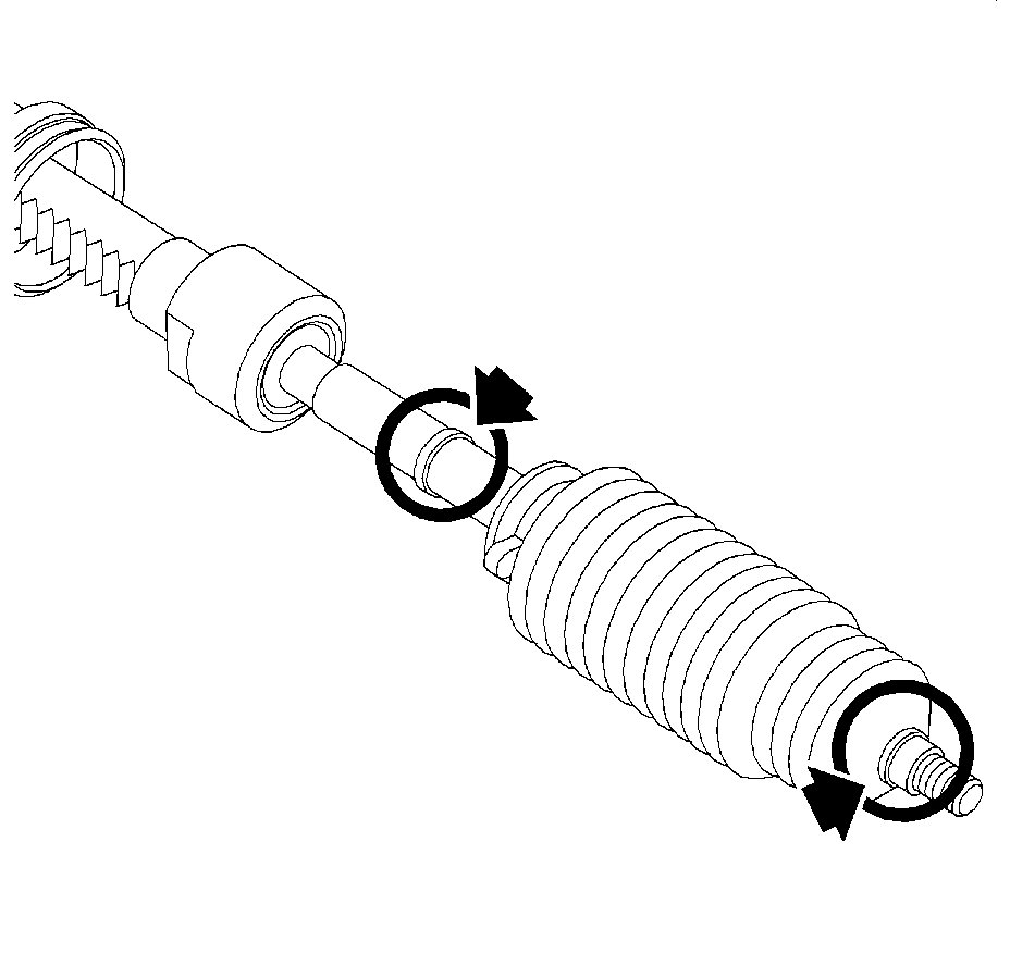

6. Remove the outer tie rod from the inner tie rod.

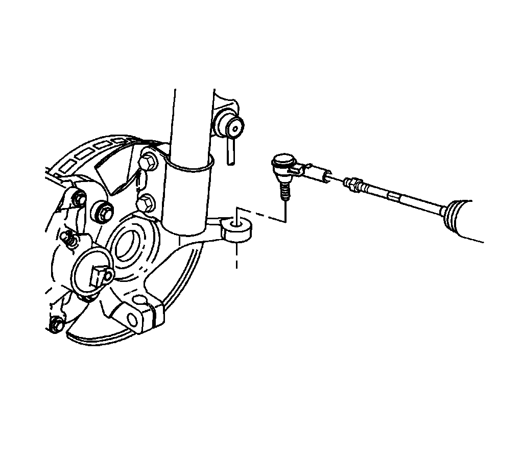

2. Connect the tie rod to the knuckle.
pic 6
3. Notice: Refer to Fastener Notice in Service Precautions.
Install a new tie rod retention nut.
^ Tighten the nut to 60 Nm (44 ft. lbs.).

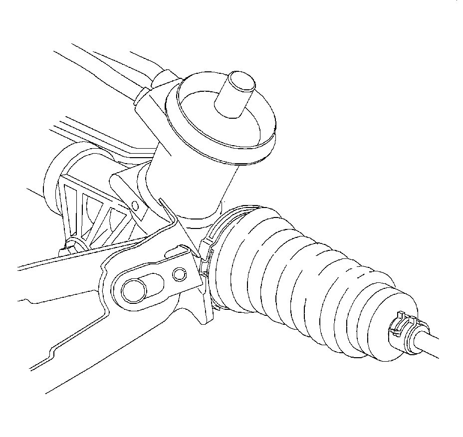

pic 7
3. Remove the outer tie rod.

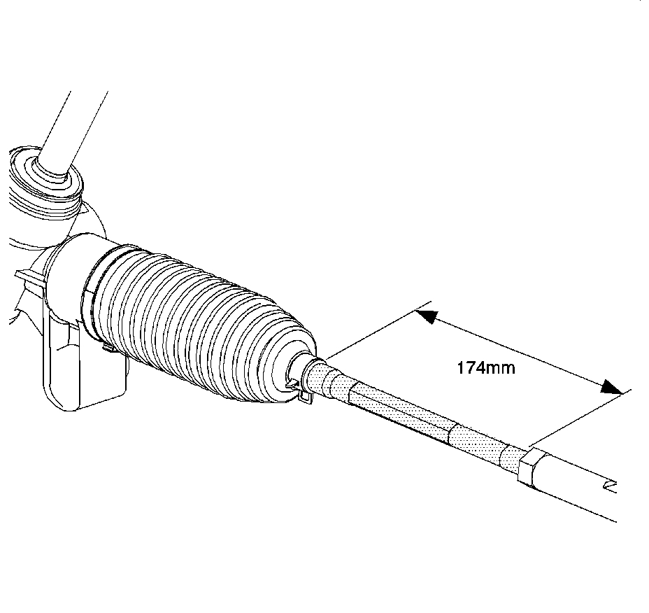

5. Install the jam nut approximately 174 mm (6.85 inch) from the boot clamp.

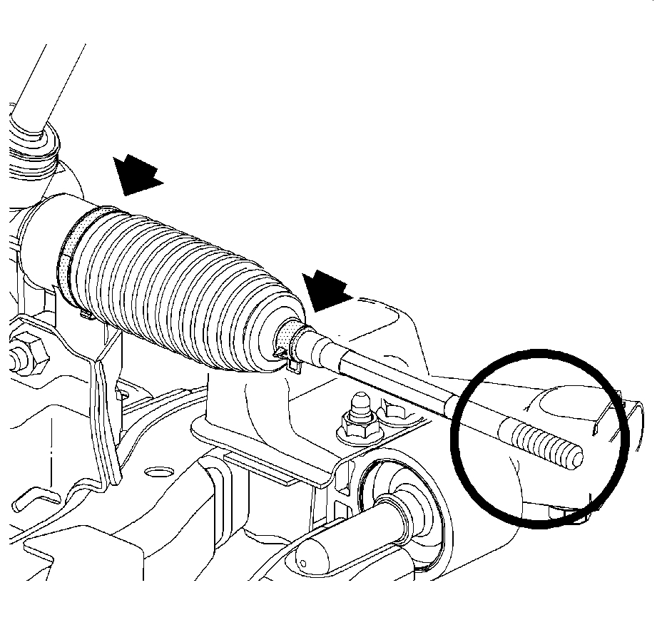

Welcome to 2CarPros. First I assume you are talking about the pictured part? Be sure the jam nut is backed off, then use some heat on the tie rod end. Many have loctite in them and really stay on. If it still doesn't come take two large hammers and hold one tight to the side of the threaded sleeve and hit it hard from the opposite side, that can shock the part enough to break it loose.
