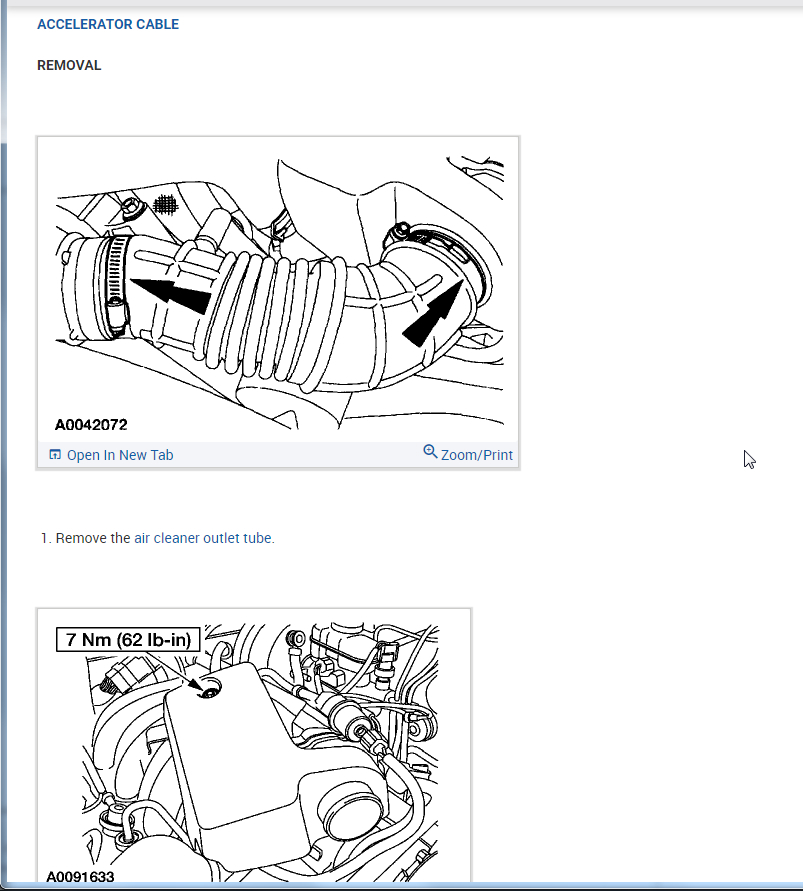

This could be a couple things so we need to check for codes just to make sure you have none.
If there are no codes then we need to start with cleaning the throttle bore. I understand you cleaned the IAC but this would only affect the RPM at idle. Once the vehicle is being driven then the throttle body would control this.

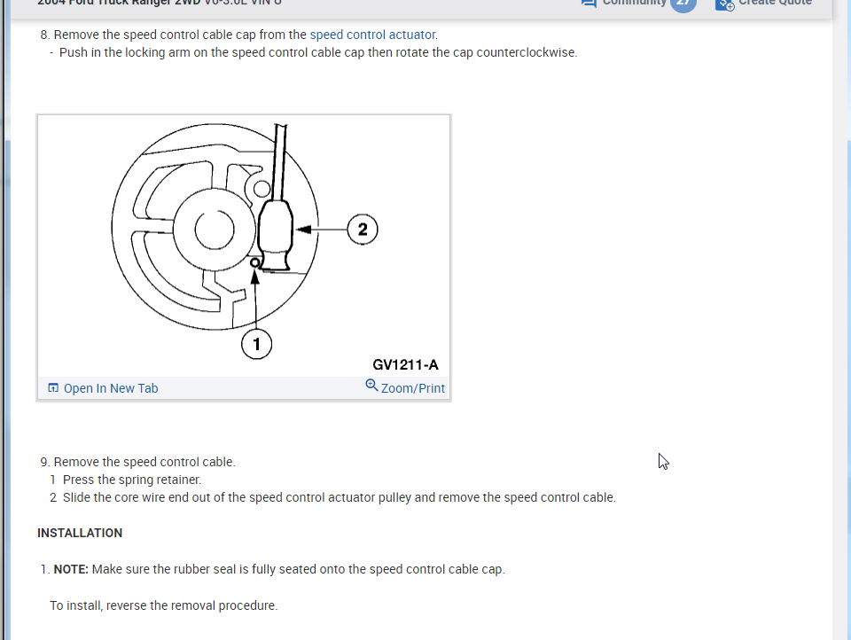

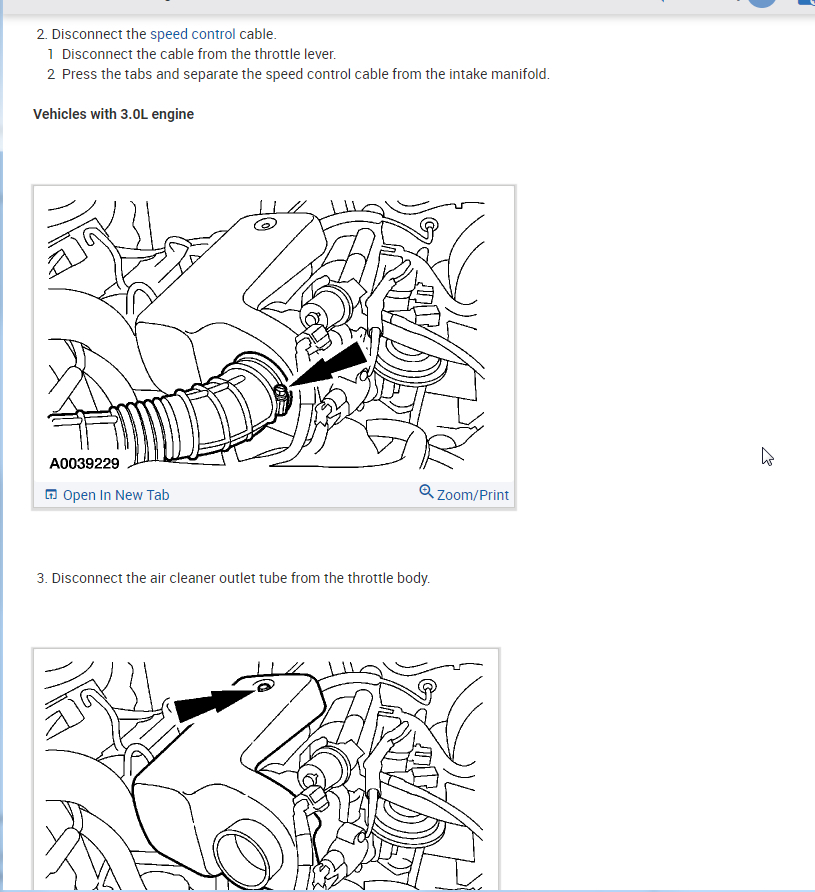

Then we need to check the cables for the throttle body and cruise control for binding or sticking.

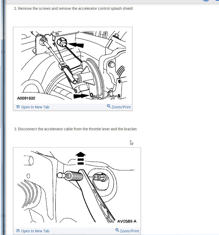

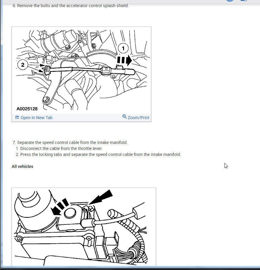

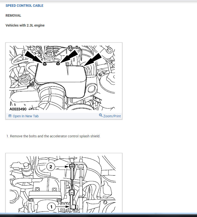

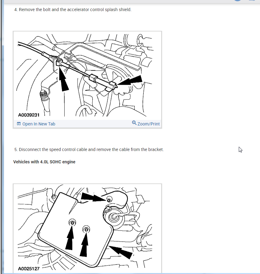

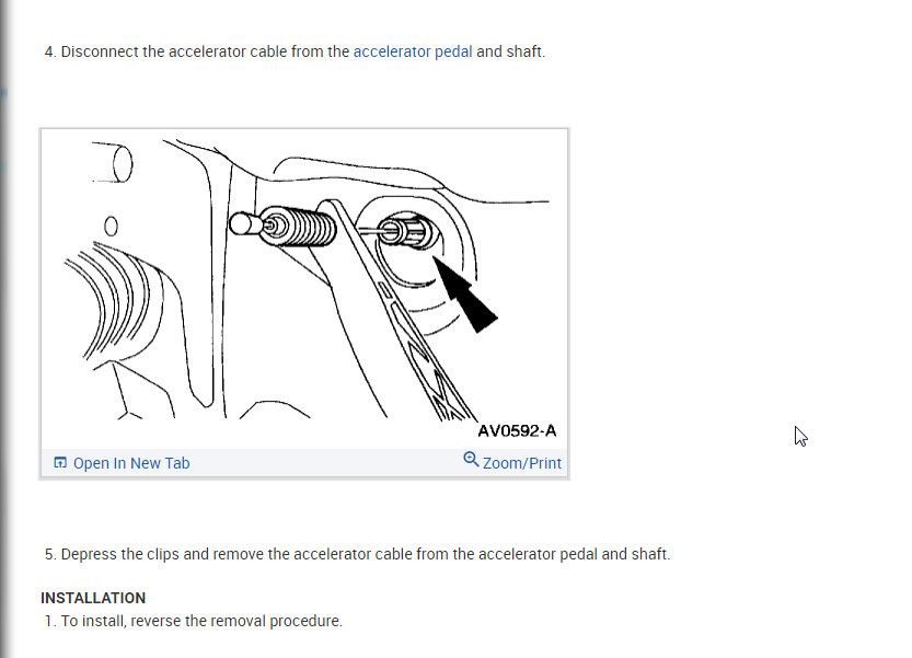

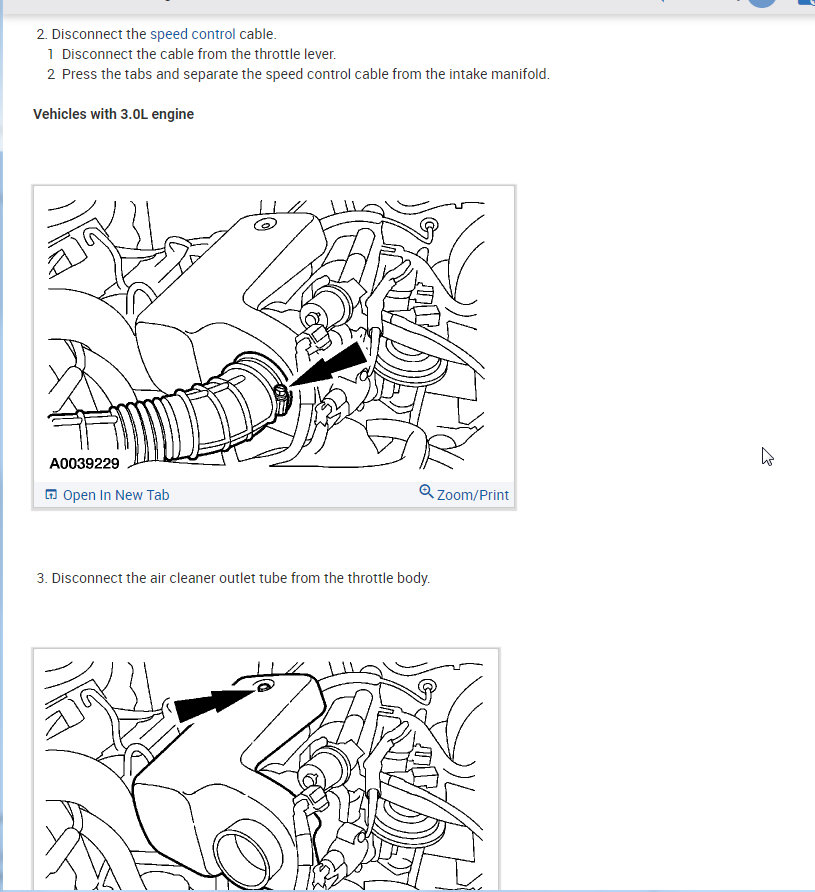

I attached the process below for these cables so let's run through this and we can go from there. Thanks
