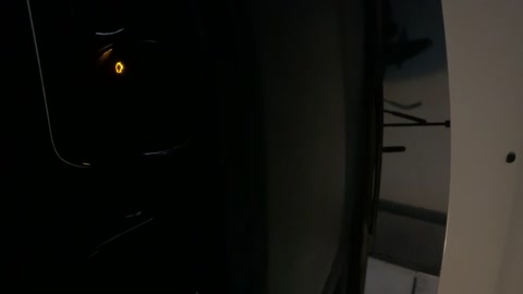

Good morning,
Can you upload a video of what it sounds like when you try to start it?
It does sound like the battery. Did he check the voltage of the battery while cranking?

He has not. could there be any other answer other than the battery?

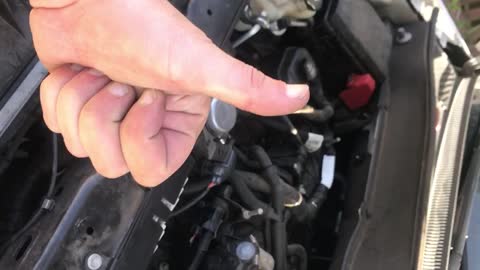

The battery is dead. It needs to be charged to 12.6 and see if it starts.

Whoop! Whoop!

It sounds like a winner.
