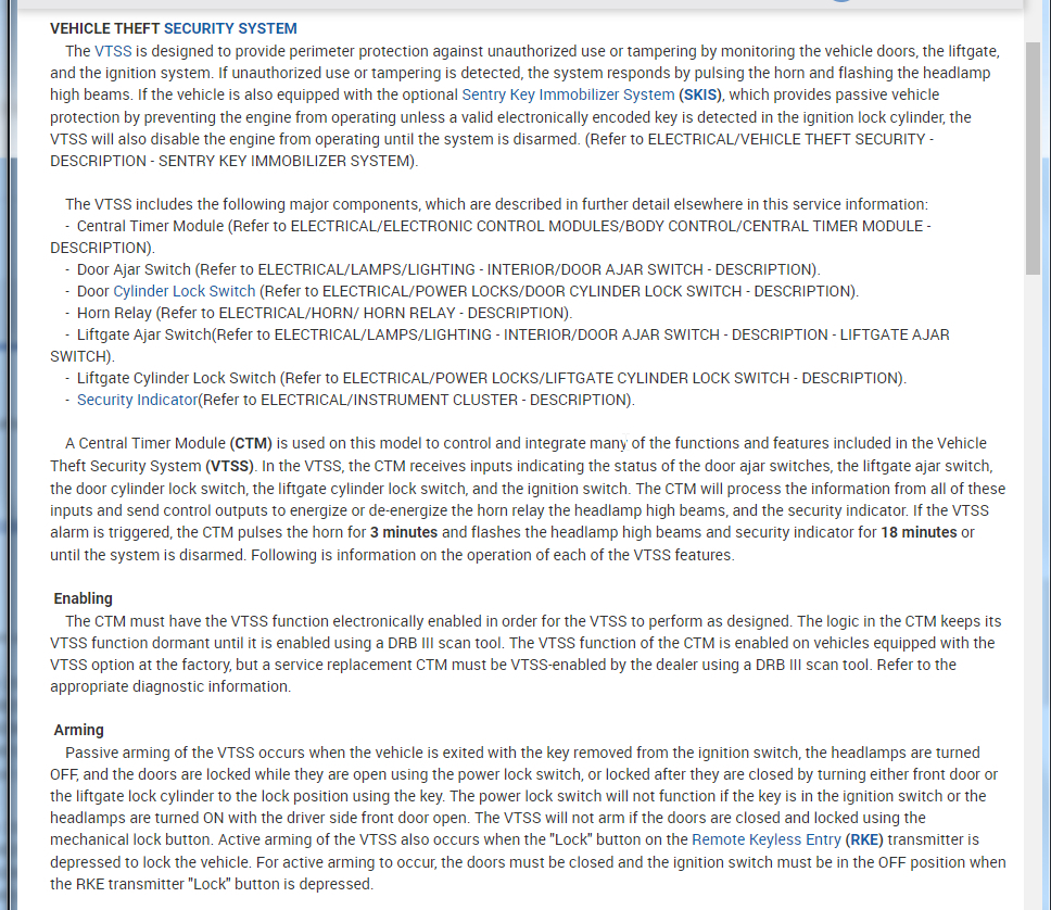

Ordered a new ECM programmed with the VIN, got the correct part number from the Dodge dealer. Installed the new ECM. After connecting the battery the tachometer and speedometer maxed out until a drive around the block cleared it out. An error scan revealed P0633 Immobilizer key not programmed ECM/PCM. The P/N the company sent does not match the dealer P/N, but is a correct alternate. There is 6 or 8 different P/N's for this vehicle, both P/N's come up for this vehicle.
Here is my question: Will this P0633 code become a problem while driving the car, or will it be something that clears itself after driving for a certain period of time? The ECM company wants me to send the part back, and issue the correct part, but that means another week of not having a vehicle, can't have that. All symptoms have cleared up, and the vehicle is running better than before. I'm more than happy to run with this part as long as it won't be an issue down the road.
