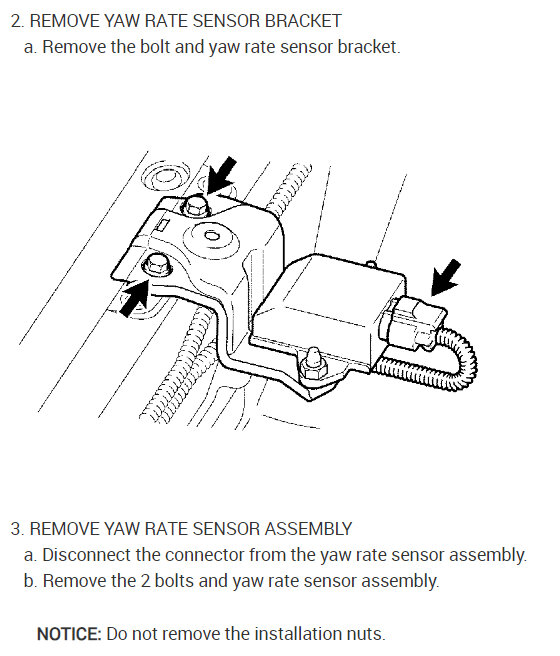

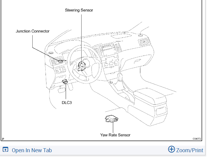

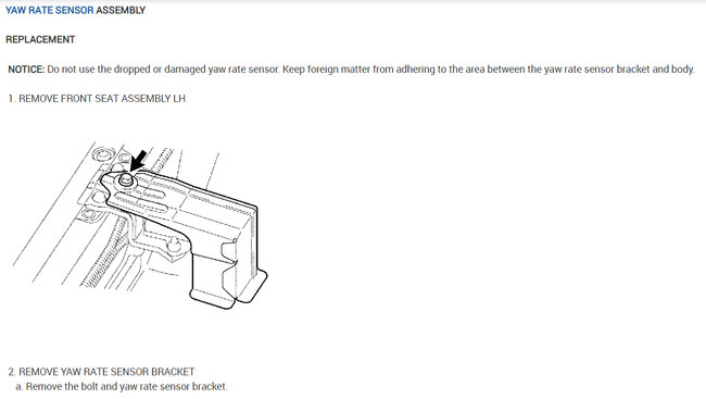

The C1244 code on a 2005 Toyota Corolla indicates a problem with the Yaw Rate Sensor. This sensor is on the left side of the center console. I would check the electrical connector for corrosion because it can get wet and stop working. Clear the codes once the repair is complete. Check out the images (below). Please let us know what happens.

Did you click on the images in the post above? It shows where the location to the Yaw sensor is.

It is under the driver's seat, it might be under the carpet.
