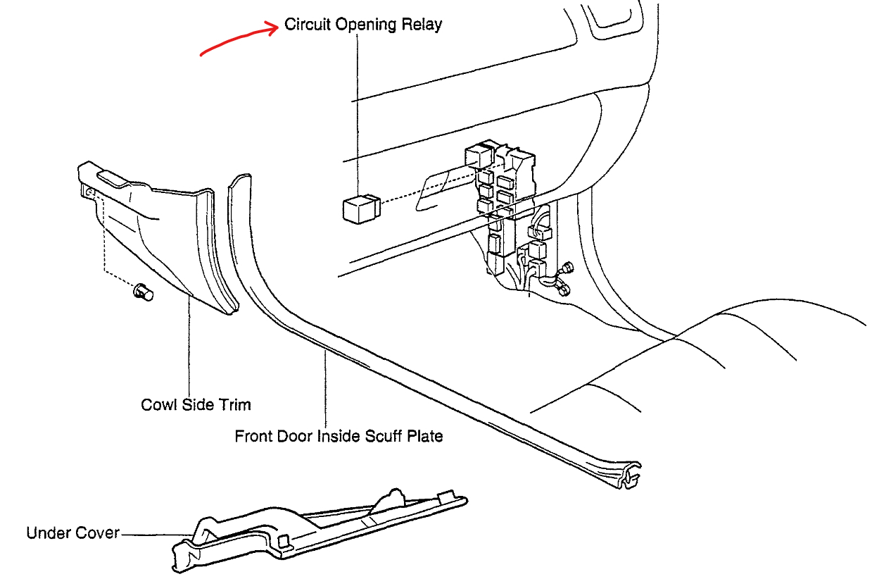

Where is the open circuit relay located?
1996 TOYOTA AVALON
2,400,000 MILES • 3.0L • V6 • 2WD • AUTOMATIC
MONKYMAN73
The car starts and runs for about 1 maybe 2 seconds tops, then shuts off. Cannot hear fuel pump kick on.

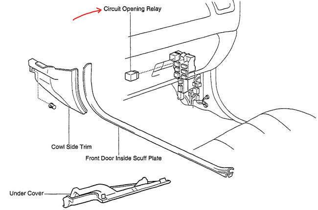

The circuit open relay is behind the glovebox. Here is a guide to help you test the relay and the location in the images below:
