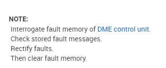

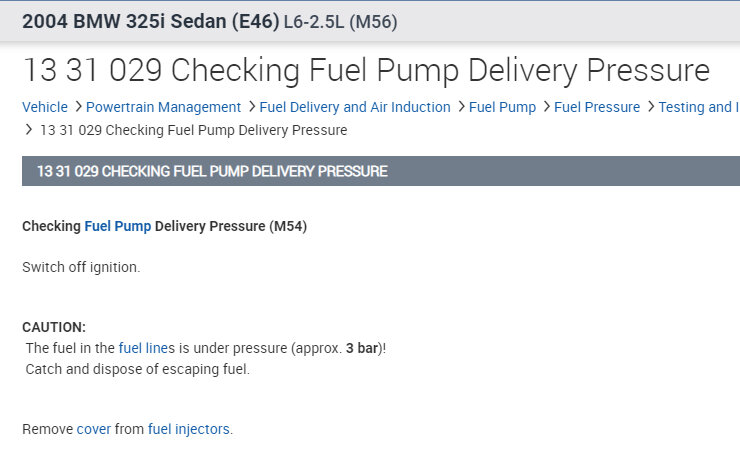

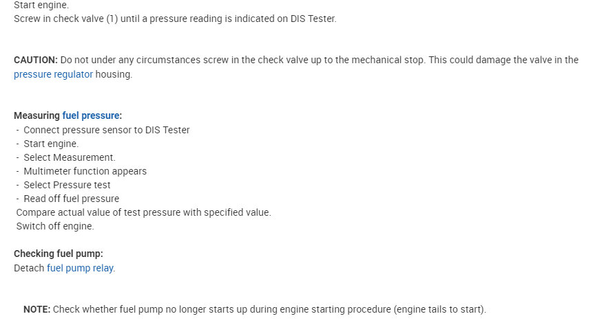

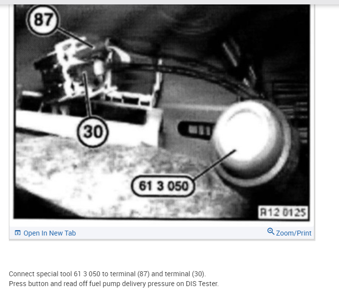

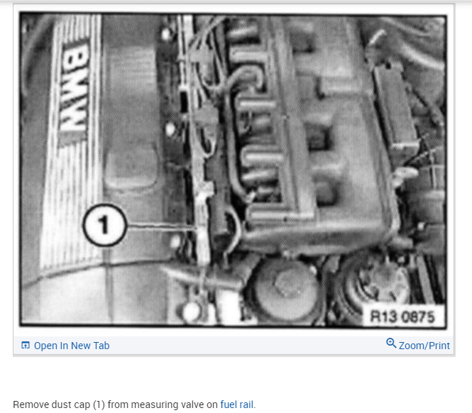

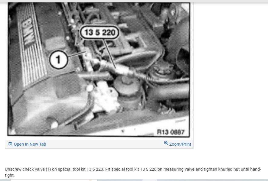

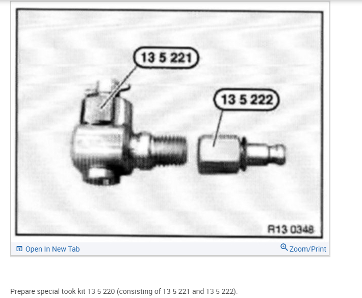

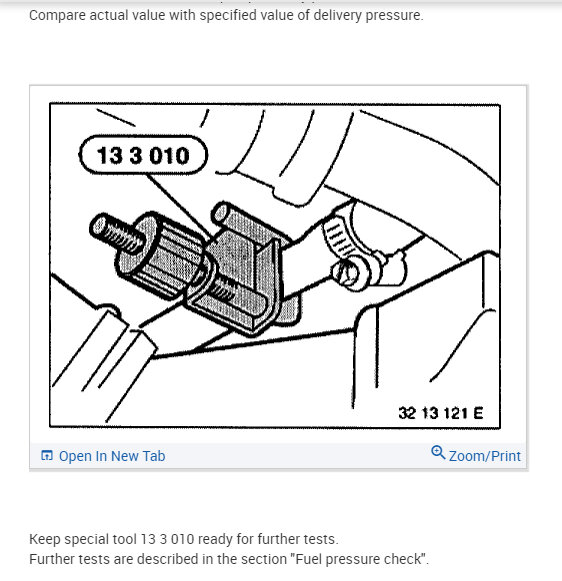

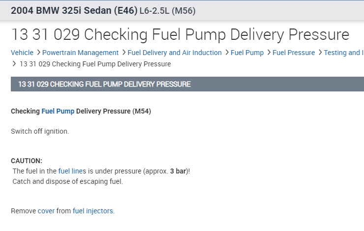

If it stays running sometimes and not others, it sounds like we have low fuel pressure. I attached the directions for testing pressure below. You will need a fuel pressure gauge, but most parts stores will lend one to you.

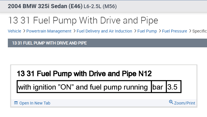

Also, the last pic below provides the manufacturer's pressure specifications. It shows 3.5 bar. That is approximately 50 PSI.
Let me know what you find or if you have questions.
See pics below.
