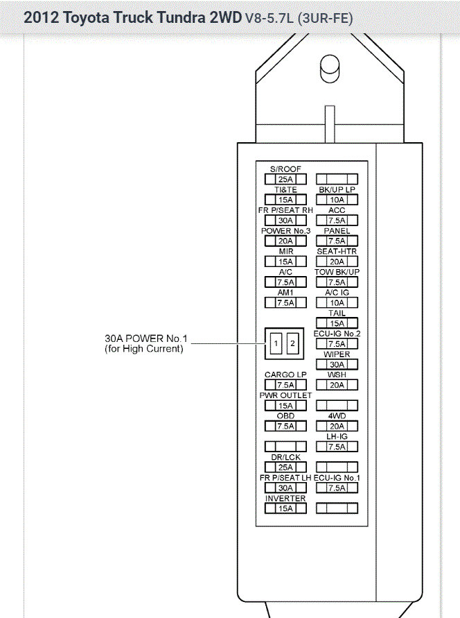

I have 1 7.5 interior fuse block (not sure if that's what it's called) not working. Fuse not blown, just not getting any power to that fuse section. Not the most crucial repair (ACC that controls AC lights). Wanted to see if i need to replace that whole panel or what? Thanks.

Since this is an interior fuse box, chances are there is a fuse in the under-hood fuse box that sends power to it which has failed.
I need to know which fuses are not working. I attached a pic below of the interior fuse box. Take a look at it and let me know which fuses have no power. You can copy my pic and highlight the affected ones or just let me know.
Also, I do see the 7.5-amp fuse for the ACC. Is it that the entire side of the fuse box, which has no power?
See pic below.

So, it was just the fuse. I had to have the headlights on to get an accurate reading. Thanks.
