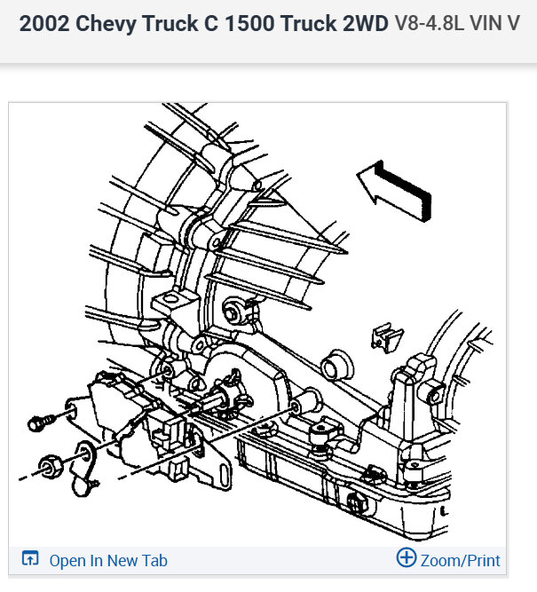

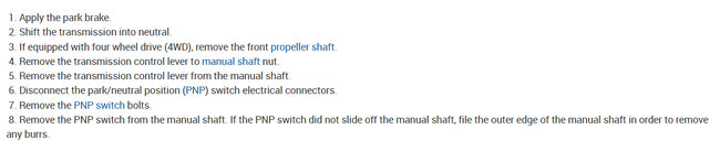

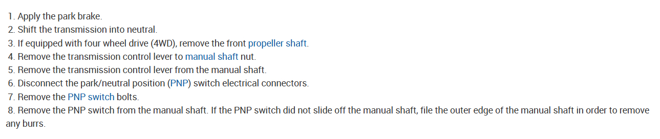

Thank you for the complete description, it sounds like the gear range sensor needs to be replaced which is common. Here is the location of the sensor and how to replace it. This should fix the problem. Check out the images (below). Please let us know what happens.

I got the part removed. I ordered a new one online. Once it arrives, I will install it and I'll let you know if it fixed the issue. Thanks. Oh, and for anybody else that's going to remove the same part, I had a heck of a time getting the electrical connectors off. So, what I ended up doing was heating them up with my heat gun and then they slid right out. They were like glued in there or something.
