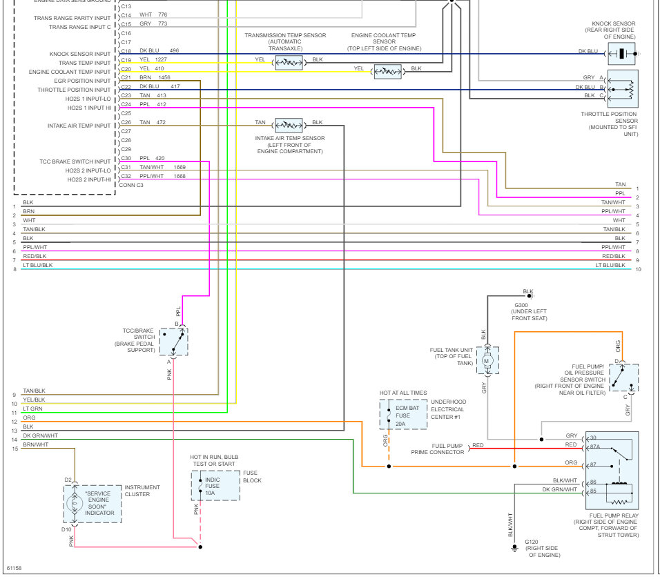

Do you have a security light flashing when you crank the engine over? If not, the system is not enabled. Also, the fuel pump gets it power from the ECM BATT fuse in the under-hood fuse panel so I would test the voltage at the fuse.

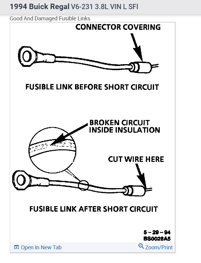

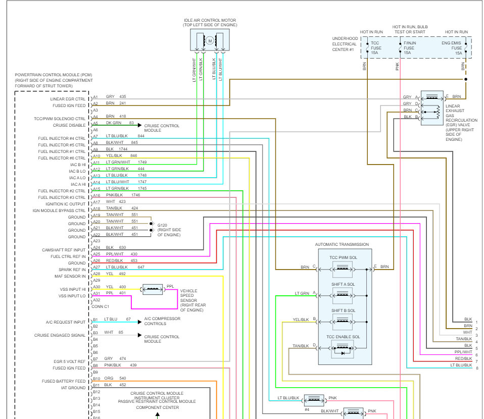

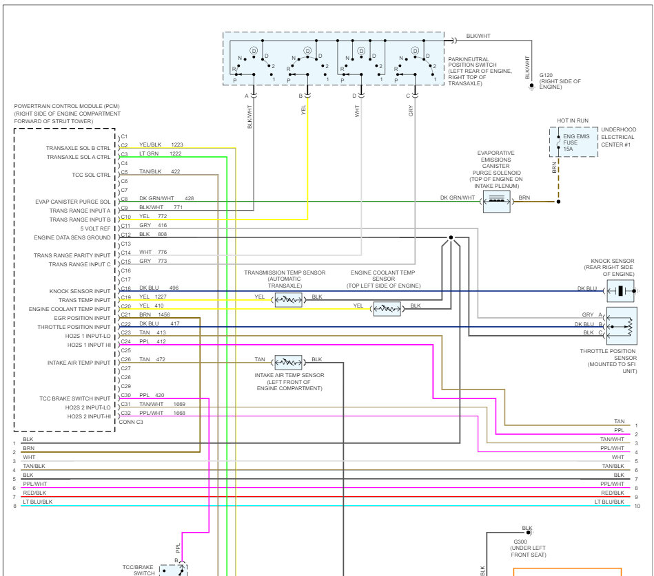

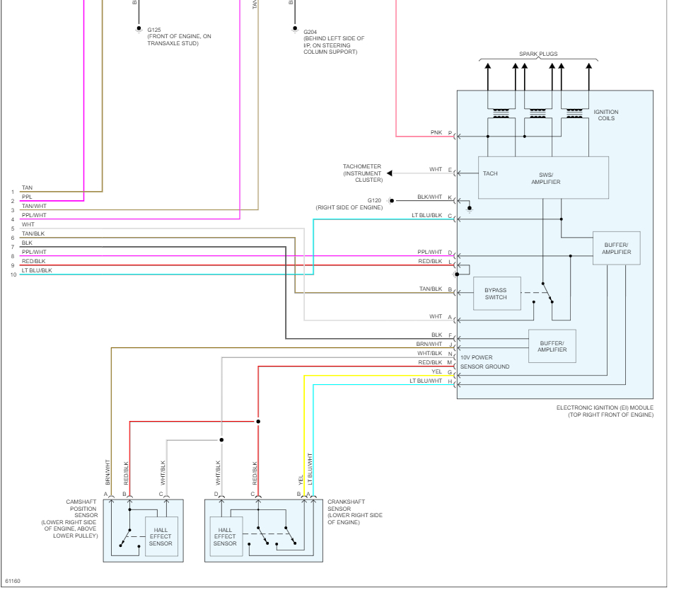

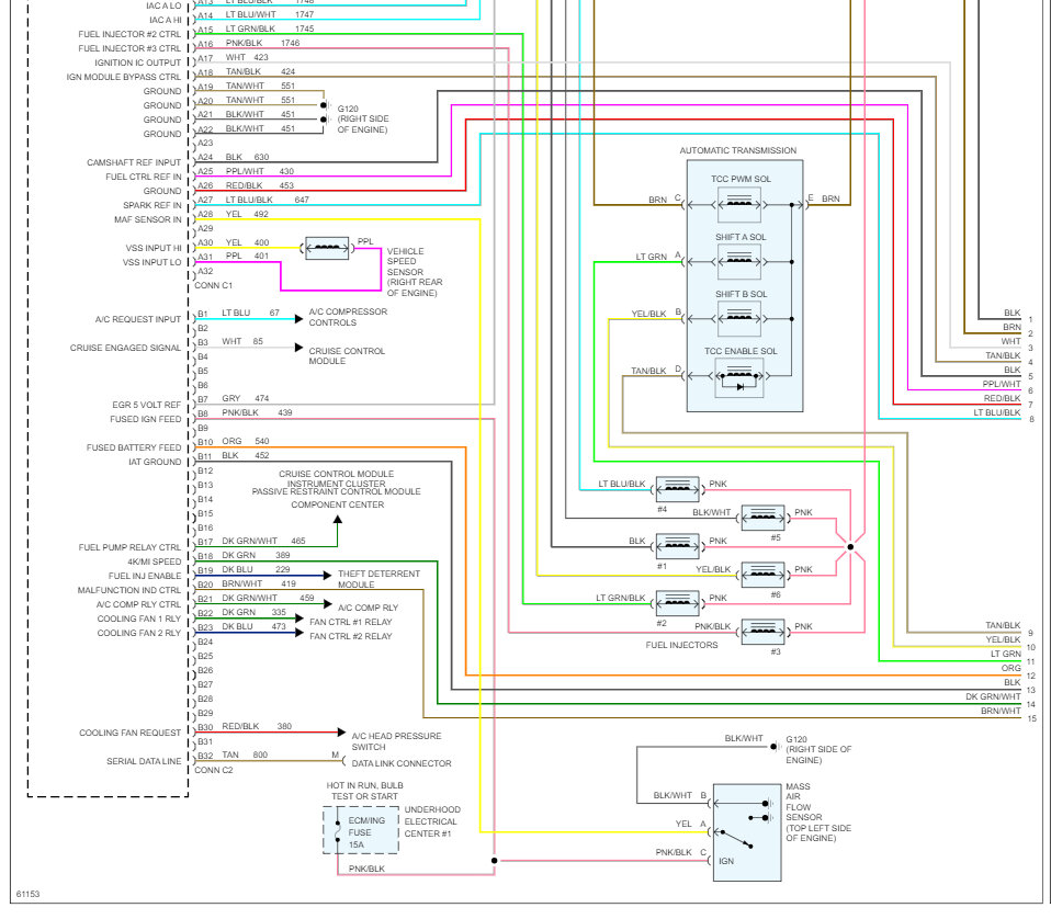

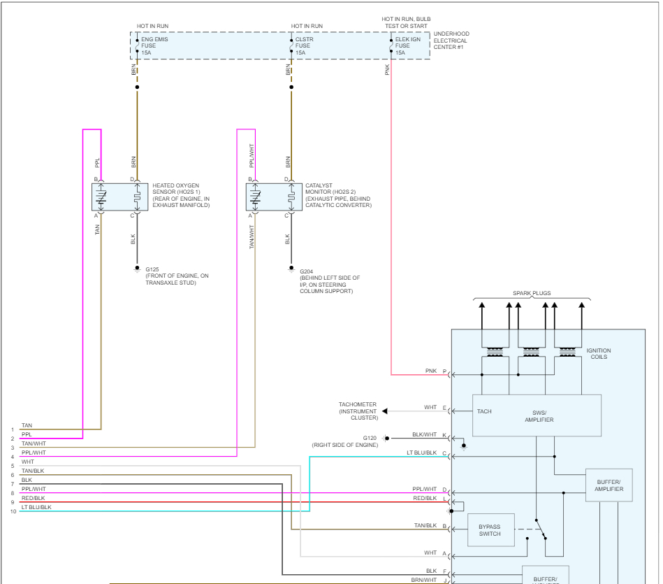

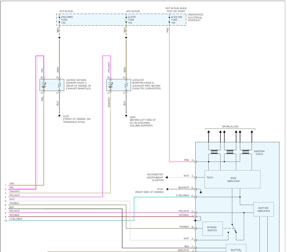

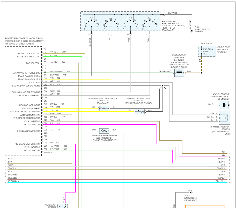

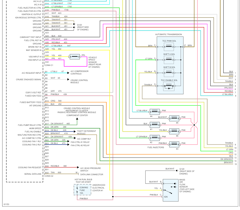

Here are the PCM/fuel pump/engine wiring diagrams so you can see how the system works. You may have a fusible link that has gone bad and not supplying 12 volts to the systems. Check out the images (below). Please let us know how it goes.
