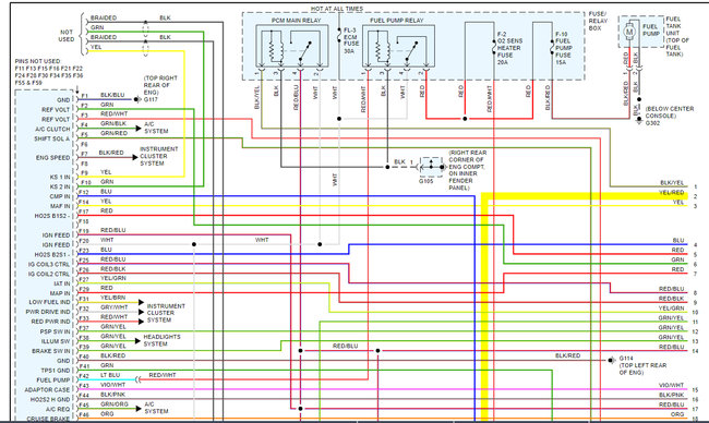

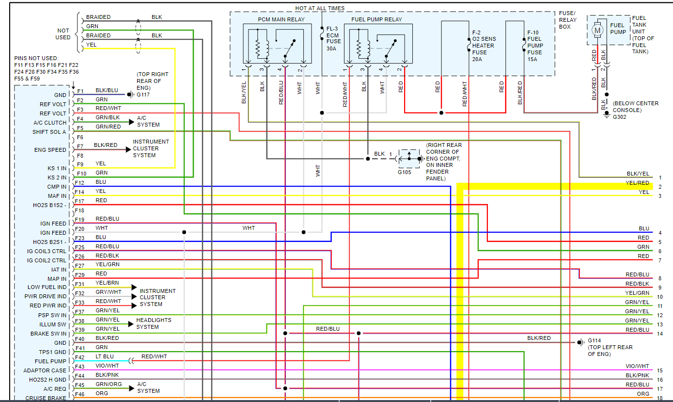

Good afternoon,

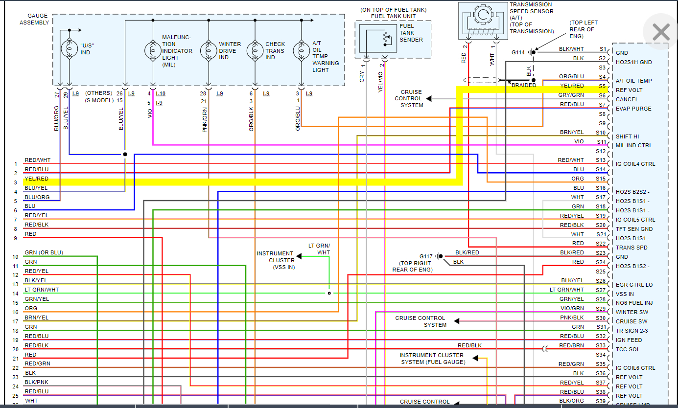

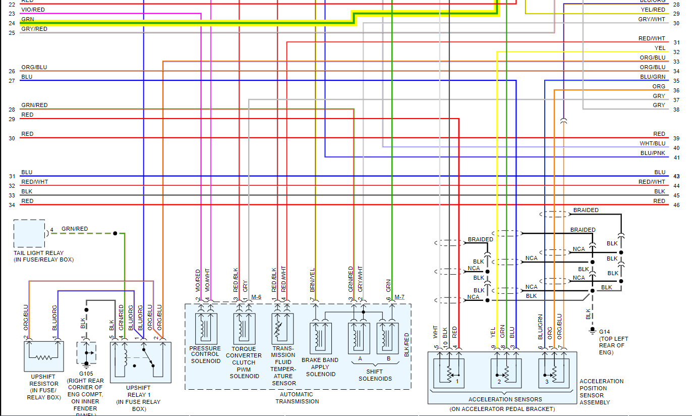

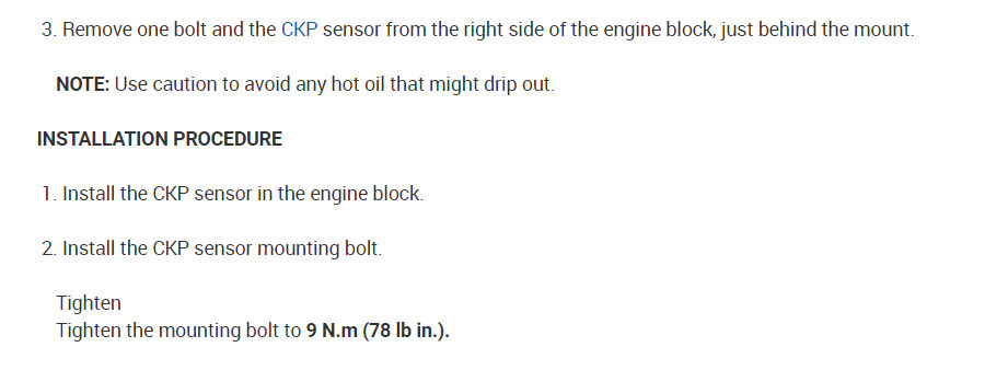

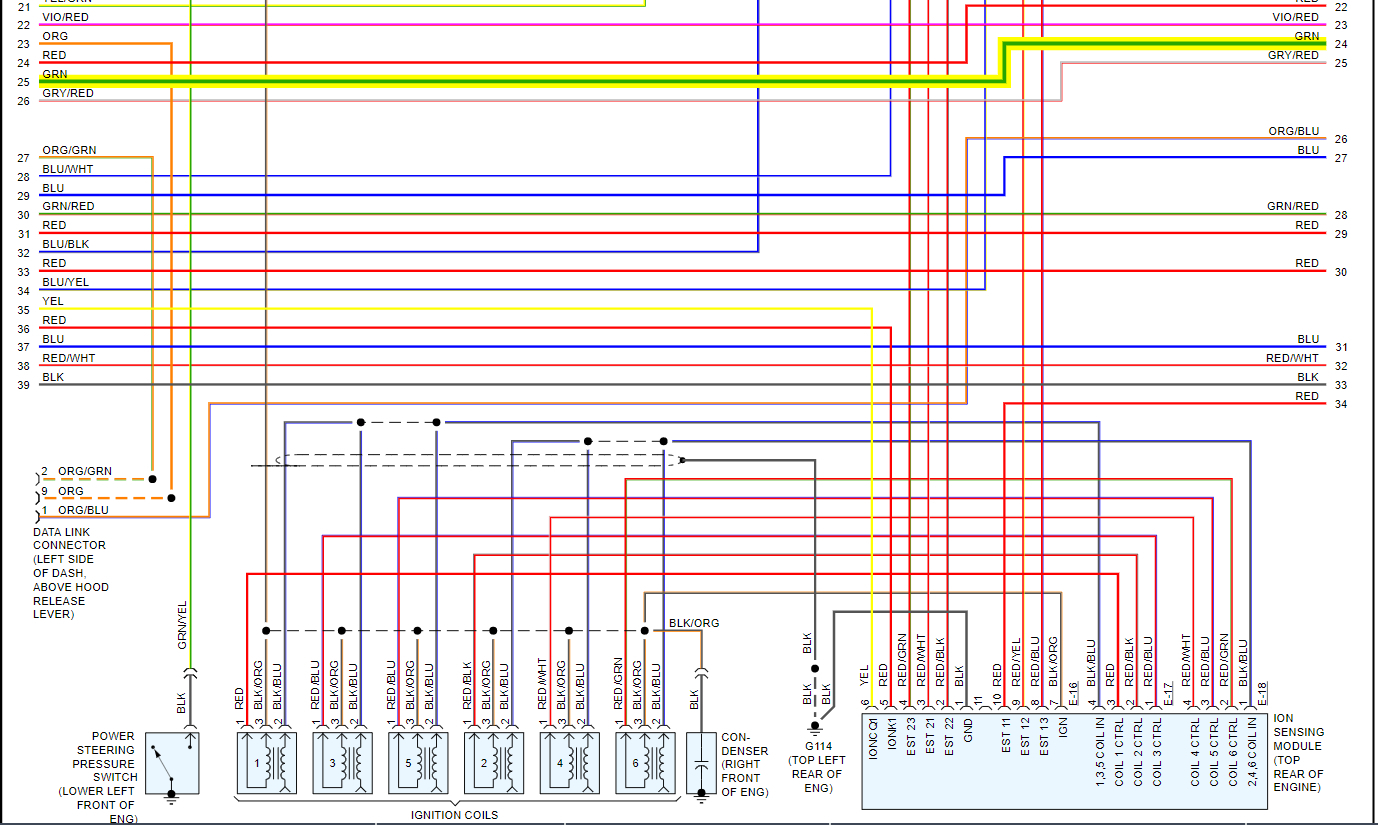

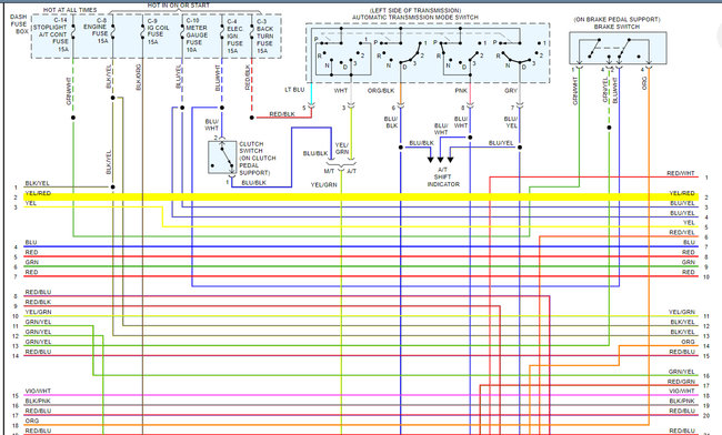

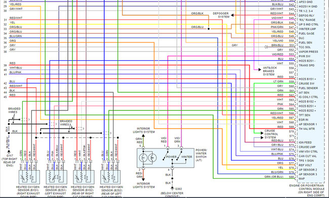

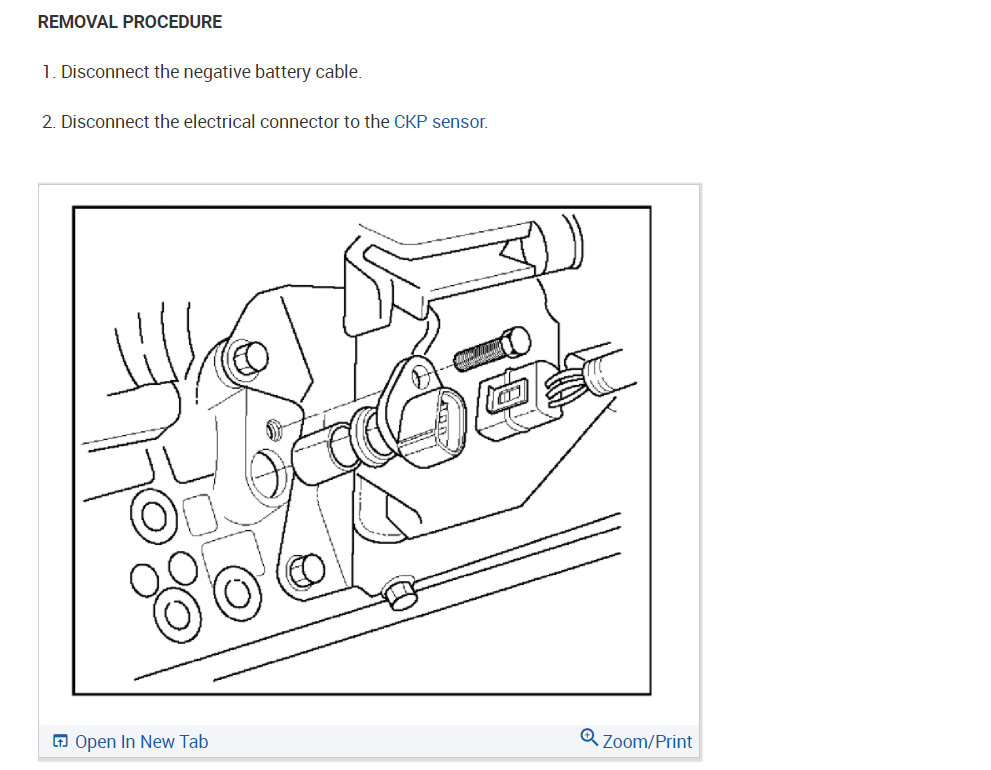

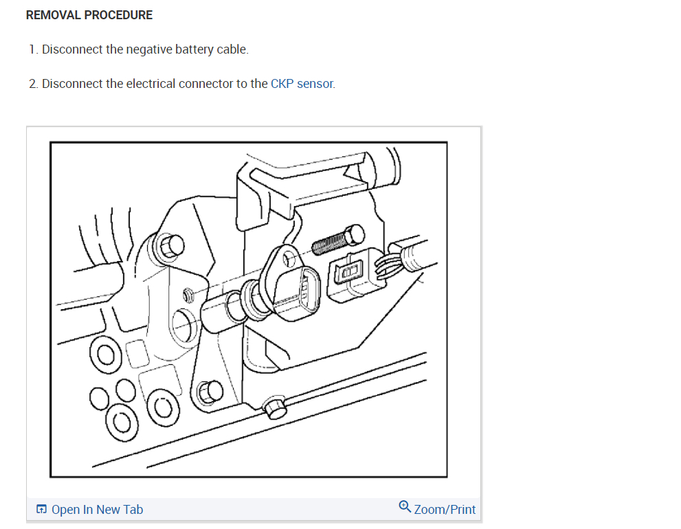

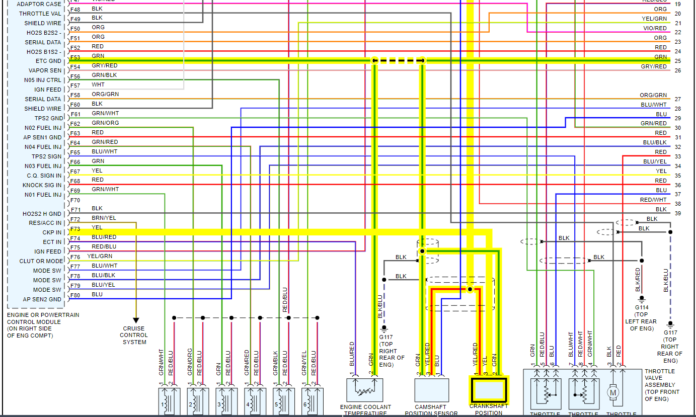

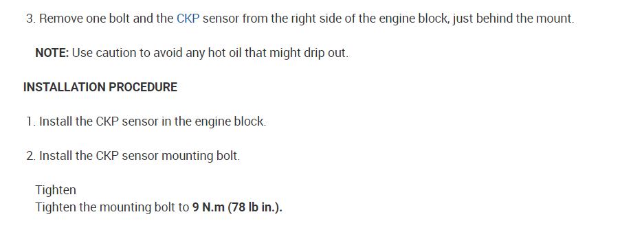

Just to add, I attached a guide for starting but the fact you said the RPM gauge does not move suggests to me the crank sensor may not be working.
https://www.2carpros.com/articles/engine-cranks-excessively-before-starting
If you smell fuel, then you should have fuel pressure but needs to be confirmed.

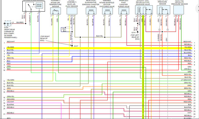

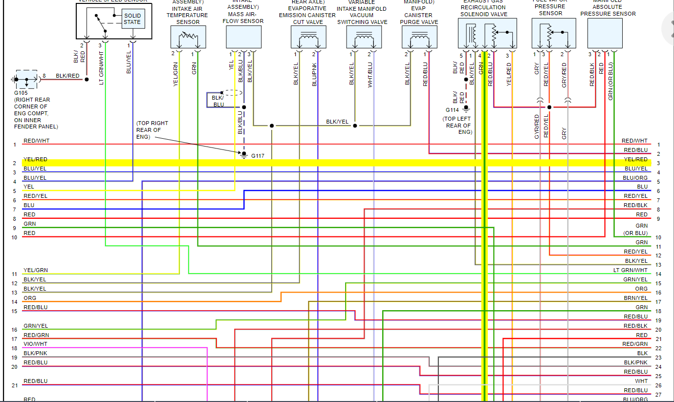

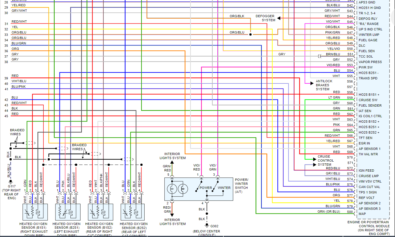

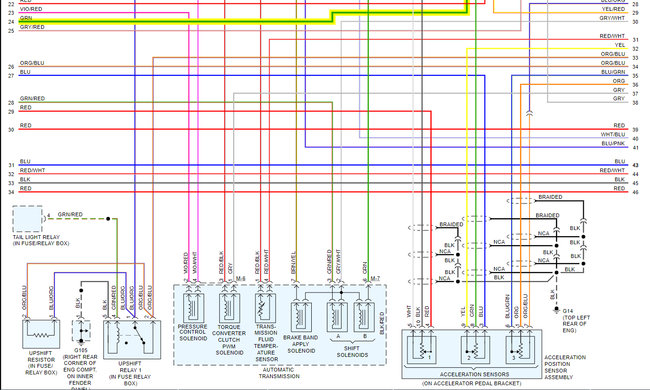

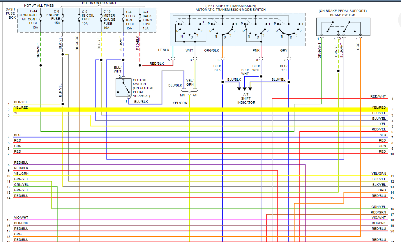

I attached a wiring diagram of the system as well for you to view for testing.

Hello again. As Roy suggested, the Crankshaft Position Sensor is a strong possibility here. Most likely that scanner would give a code relating to that part though. That's why I suggested the scanner. It can help eliminate other avenues pretty easily
