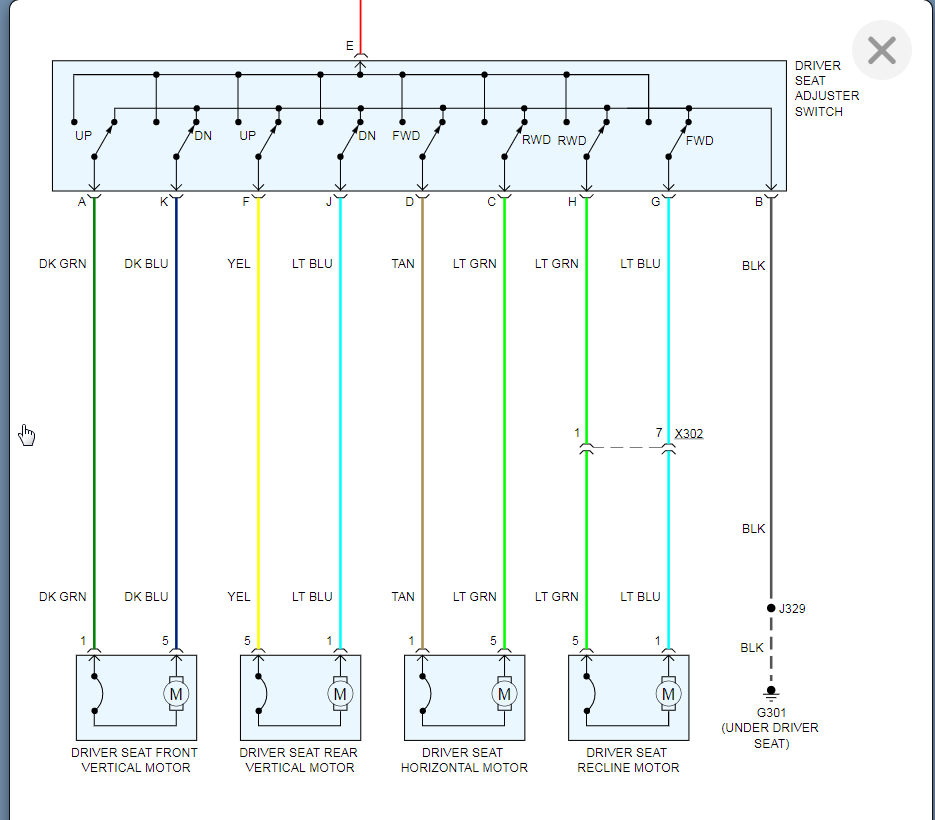

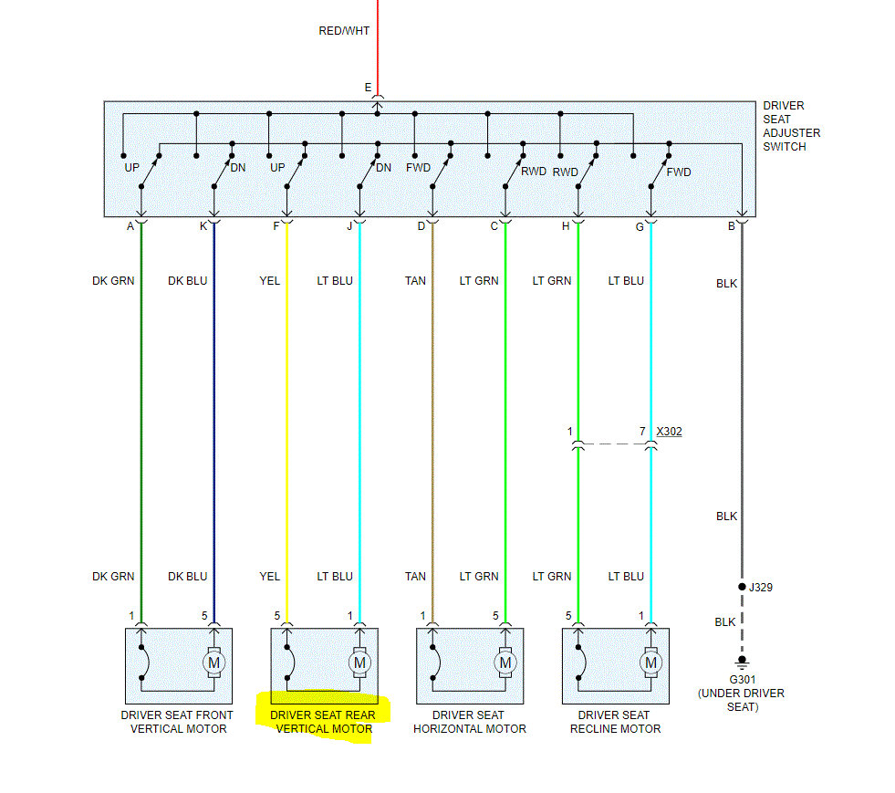

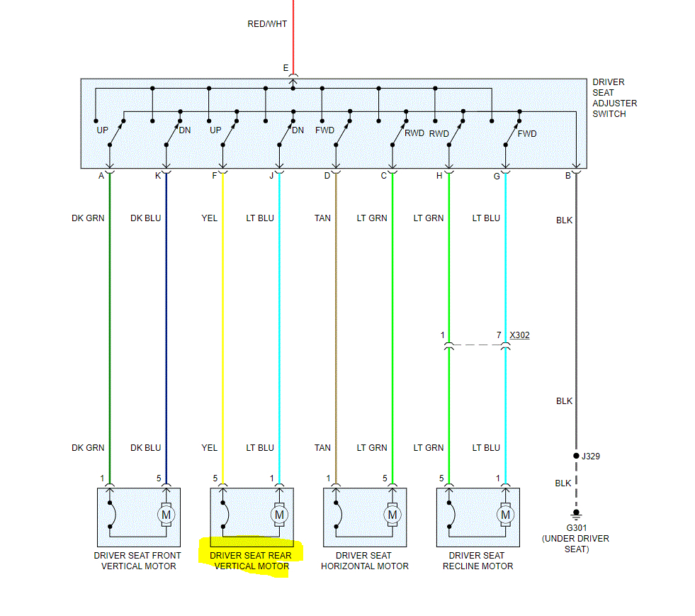

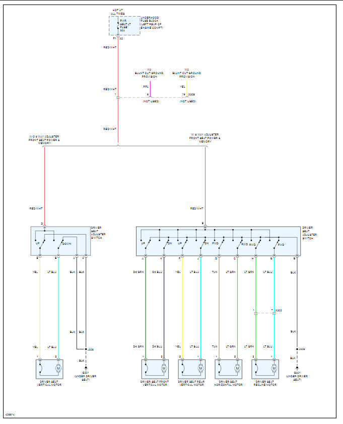

If it's a light blue wire, that is for the rear vertical motor on the seat. If you take a look at the attached portion of the wiring schematic, it shows it.
What you will need to do is disconnect the connector and see if there is a way that it can be reattached. If it can't, chances are you will need to get a new connector and wiring.
Let me know. Also, let me know if you have other questions.

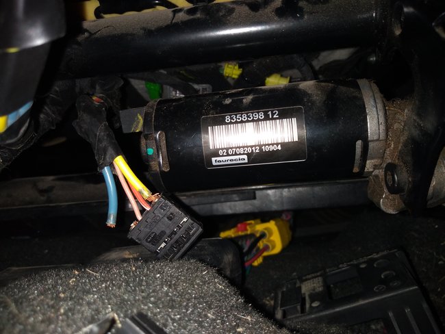

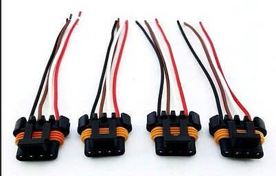

Photo of my issue. Think it's something a novice can fix at home? It seems pretty straight forward to me... But I'm not very experienced.
Oct 12, 2020 at 9:16 AM
The only thing you can do is try. I see the yellow wire looks like it may be not far behind. See if you can remove the broken portion from the plug and reinstall the wire back into the plug. It may require soldering. If that doesn't work, you may need to get a new harness for that point.
