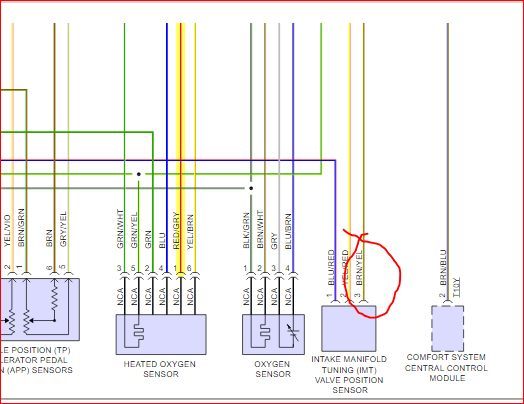

I have the vehicle listed above Quattro.

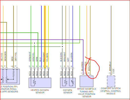

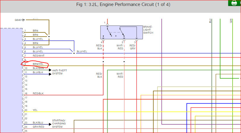

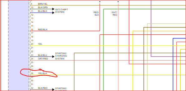

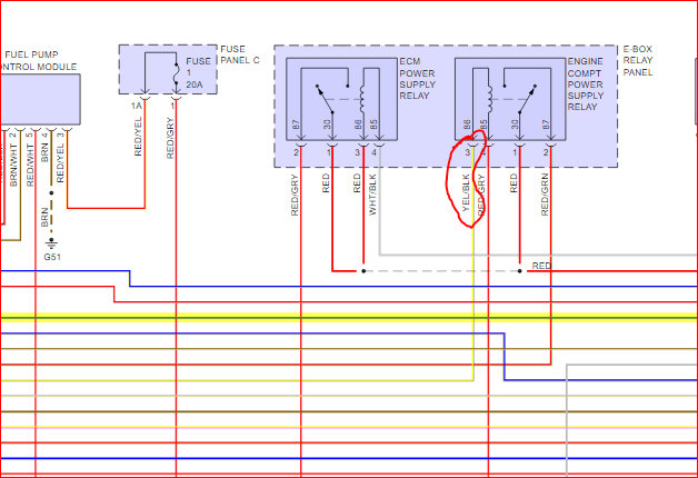

my on-board module on driver side fried and the wire on the 12 pin black connector pin #9 which I believe is black with yellow strip ha's melted all the way to the passenger side. I'm trying to figure out what that wire is and trying to get a diagram so I can find the source of why it had melted to I can fix the problem. anything would help.
