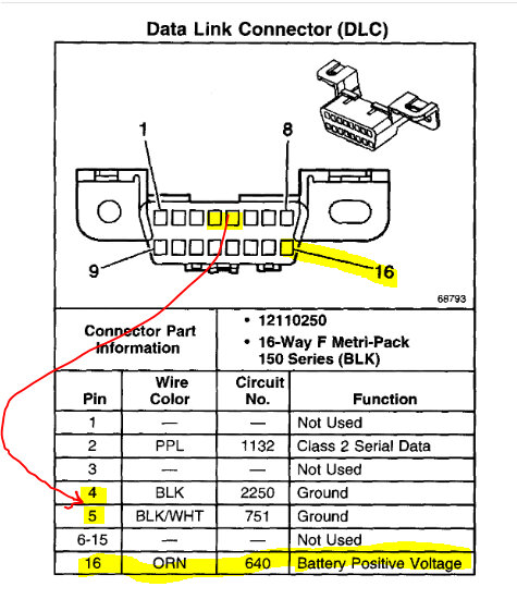

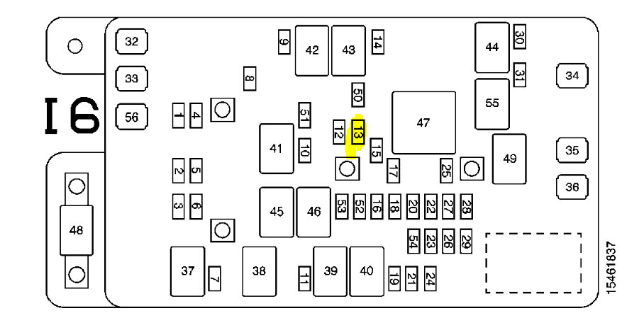

So, I have a friend that came by today with his vehicle listed above his OBD Plug isn't not connecting to my scan tool, same thing happened at the parts store as well.
What's the best way to troubleshoot the plug to find the issue to recover the trouble codes he needs. Any and all advice or suggestions will be greatly appreciated. I can provide Pictures and or more vehicle info if need be. Thank you guys.
