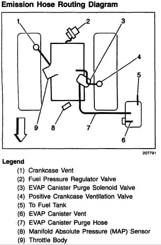

The thermostat range on that engine is 188 - 205 degrees F. 120 is way low. A stuck open thermostat would cause it to run cold.
Should be a sticker showing the vacuum lines. This is the base diagram for that engine.
