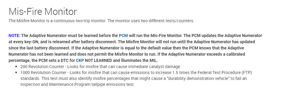

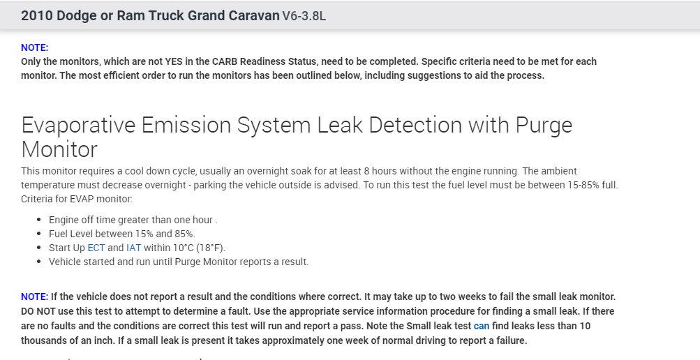

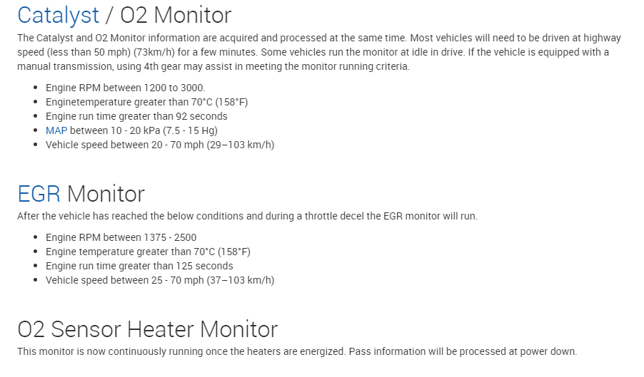

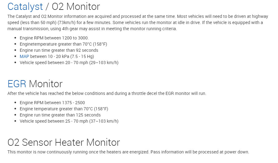

The best thing to do is drive it under normal conditions. Some will reset in 20 miles and others take over 100 miles. I can tell you that a drive cycle requires specific things to happen. See the attached pics below.
I wish I could give you the specifics other than what I attached, but from experience, I've found they are all different.
Let me know if this helps.
joe
See pics below.
