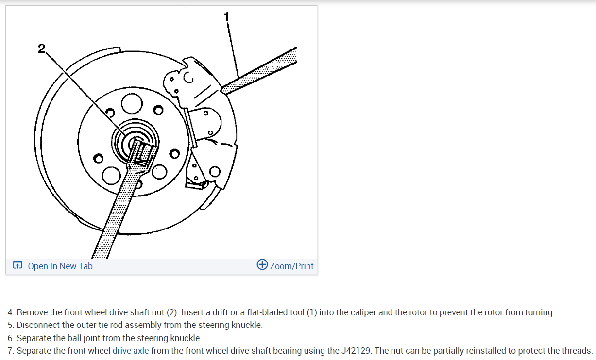

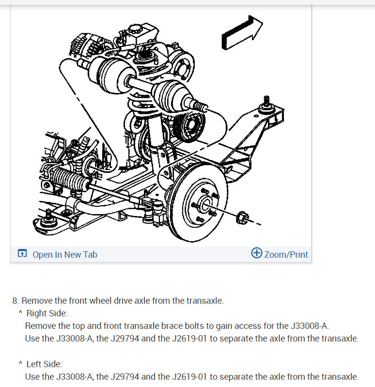

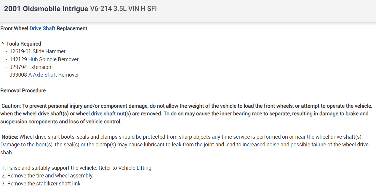

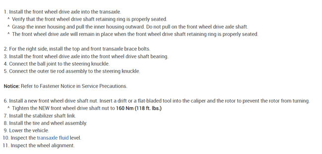

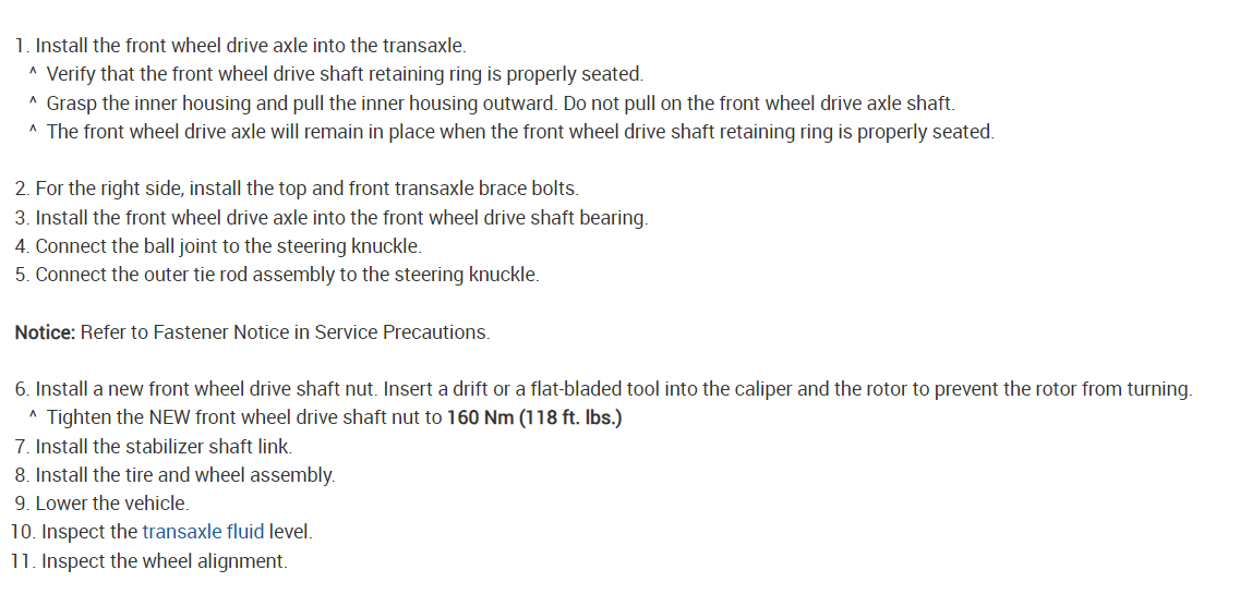

I would think it would be the tire balance if it happens at around 55-60 mph. I have also seen the CV axles go bad and cause a "bind" while in rotation. I would remove the tires for balancing and then if that doesn't help pull the CV axles and check them for replacement. Check out the images (below). Please let us know what happens.
