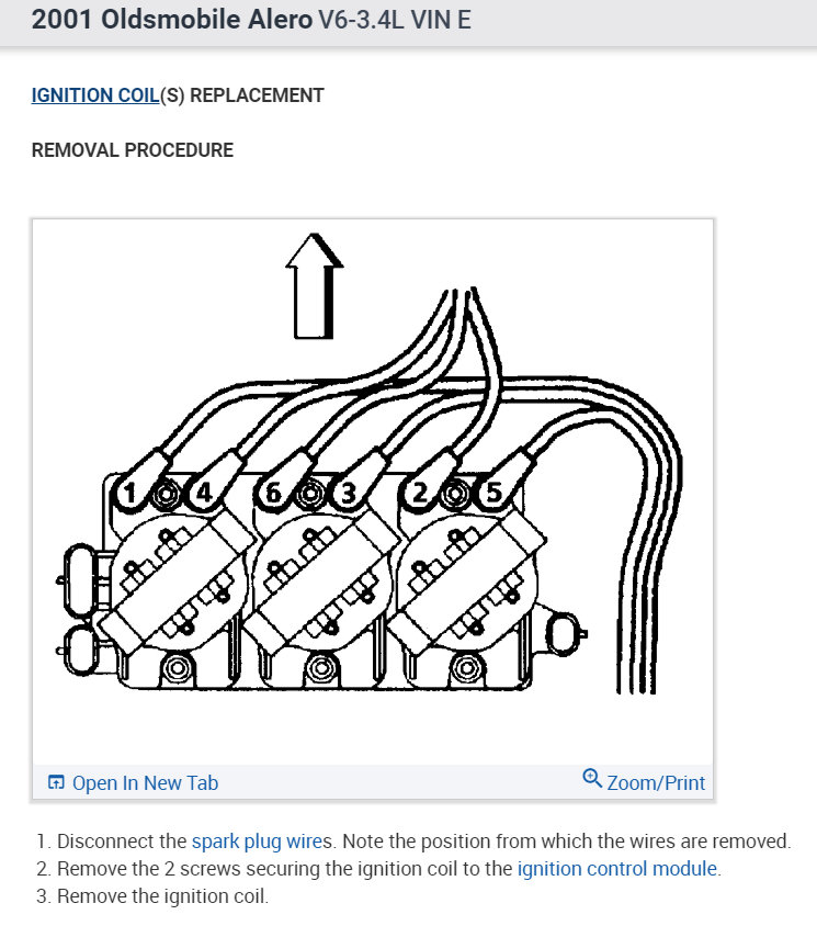

Wires got mixed up when replacing spark plugs on an Alero, 3.4 engine. Need firing order.
Feb 4, 2006 at 11:56 PM
GWEATHER1

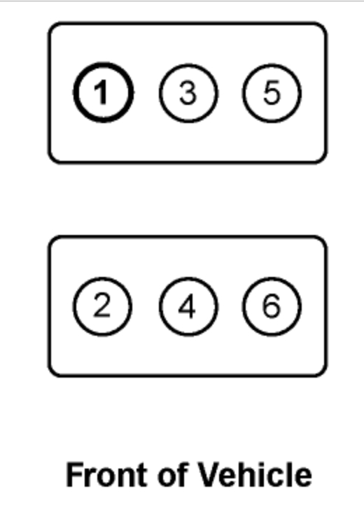

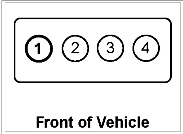

Here is the firing order for both engines:
Firing Order 1-2-3-4-5-6
Firing Order 1-3-4-2
Check out the diagrams (below). Please let us know if you need anything else to get the problem fixed.

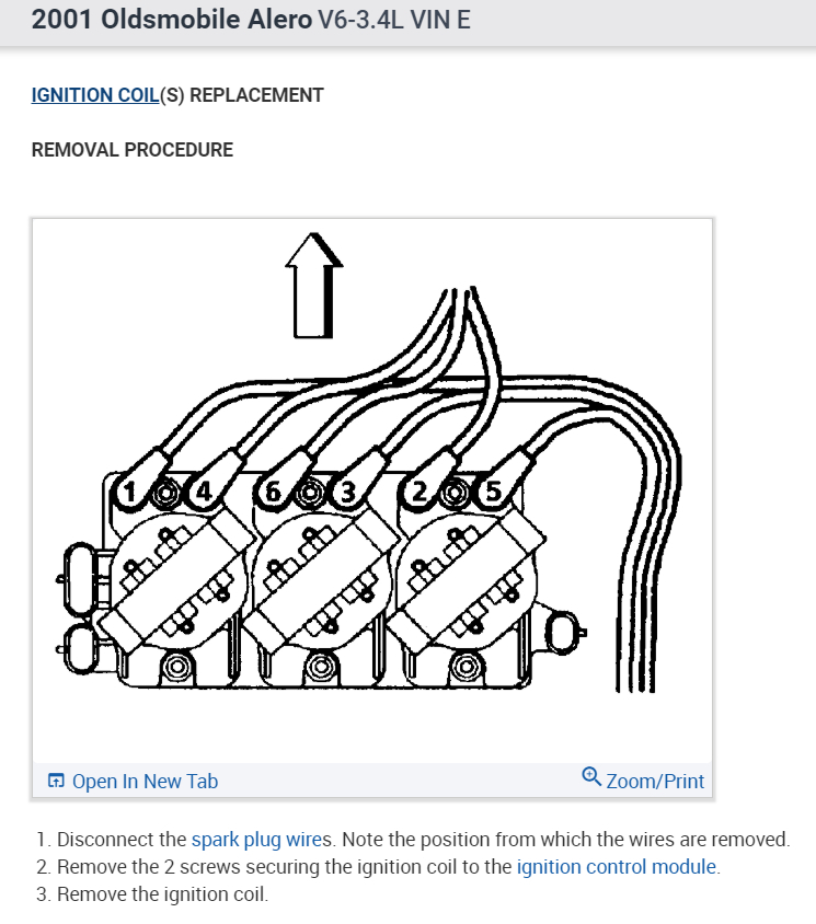

LOSONE
  • 1,616 POSTS
It is not quite that simple perhaps this will help as the firing order changes depending on the set up.
If you have a 3.1L 1994 and older with the coil packs under the front exhaust manifold. Front cylinders are 2-4-6, back cylinders are 1-3-5. coil packs left to right are 1-4-6-3-2-5. If you have a 3.1L 1995 and newer with the coil packs on top of the engine. Front cylinders are 2-4-6, back cylinders are 1-3-5. coil packs left to right are 5-2-3-6-4-1
Jun 19, 2018 at 12:26 PM (Merged)
I found this check out the diagrams below, let me know if you need anything else. Check out the diagrams (below).
