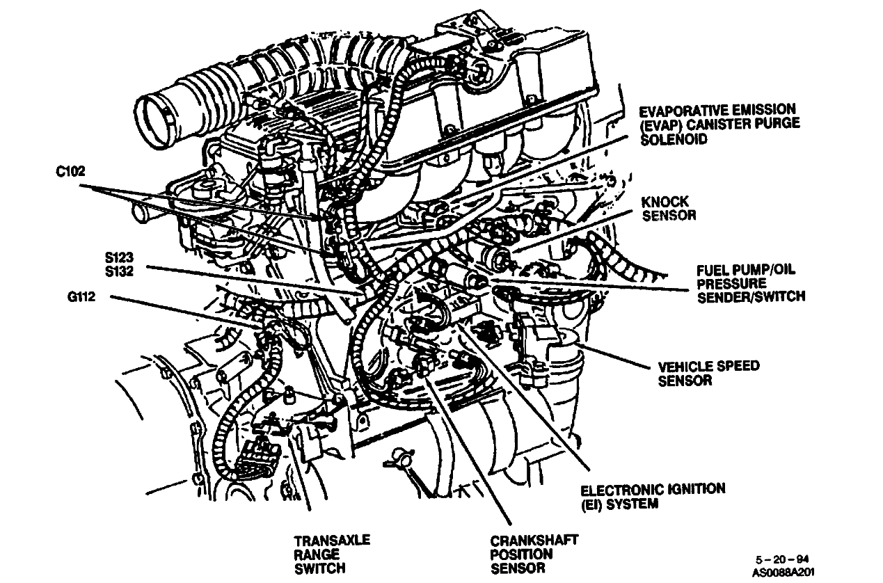

Where is the plug located? I have the same problem, no crank but turns over.
Oct 10, 2022 at 4:11 PM
This plug is on the engine block, it is called the oil pressure fuel pump switch. Check the image below to see what I am talking about.
