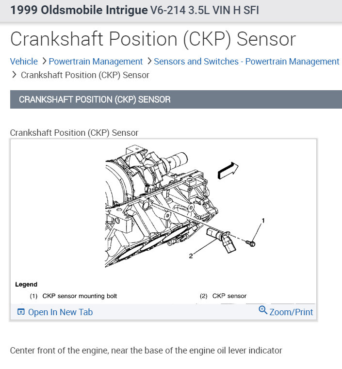

The crankshaft angle sensor is in the lower part of the block here is a guide to show you the steps and a diagrams below to show you on your car.
Check out the diagram (Below). Please let us know if you need anything else to get the problem fixed.

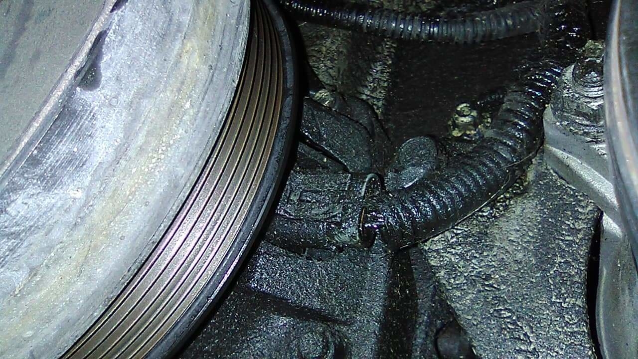

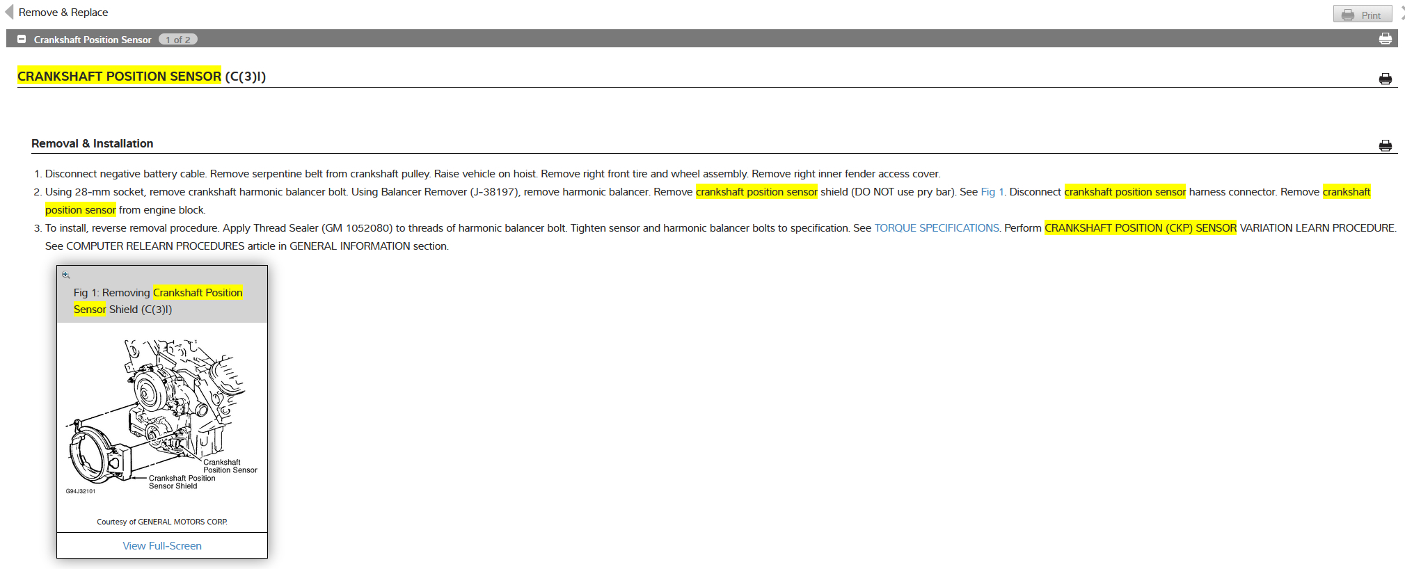

So, the car was having a lot of trouble starting. We had to give it loads of gas to get it to do so and now it won't start at all but still cranks. The security light is generally on and sometimes is flashing which led me to believe it was the passlock system but the codes claim it's the crankshaft sensor, which we have purchased. The issue is that every video and guide I've viewed/read suggests that the sensor is behind the harmonic balancer and I see no easy way to get it off without an impact and a puller. Anyone know of ways to do this without the proper tools?

Hi and welcome.
As you can see in the diagram below, that is how it is done. Sorry for the bad news. Check out the diagrams (Below). Please let us know what happens.
