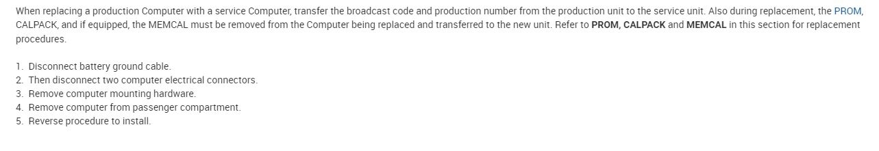

Thank you.
The code is for the ECM quad driver failures.
I attached the procedure below for you for the replacement of the ECM. You can get one at rock auto. Just match up the numbers on the unit. They must match exactly.
