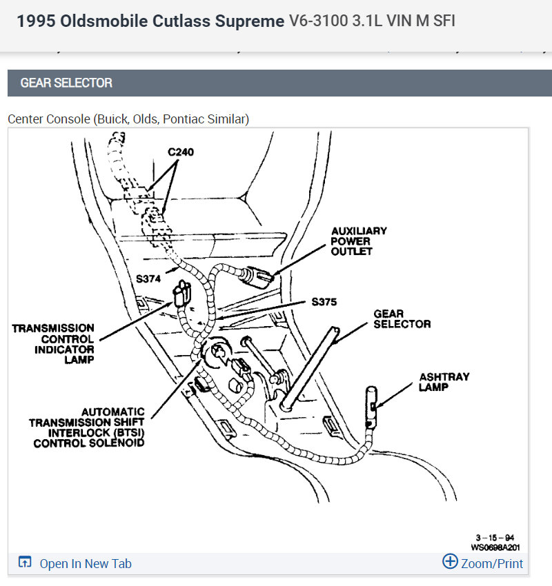

Get the shift interlock system check, could be the shift interlock solenoid acting up.
Dec 13, 2007 at 1:37 PM

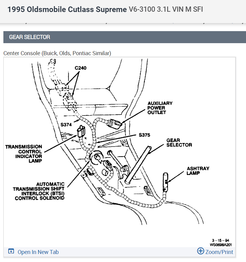

There is a shift lockout solenoid mechanism that happens when the push the button down that is not adjusted correctly or is worn out. You will need to remove the shifter bezel to inspect. Check out the images (below). Please let us know what happens.
