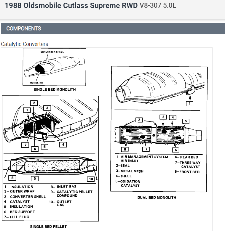

Also, I would do a catalytic converter test because it sounds like it is clogged. Here is guide to help.
This guide can tell you more on the engine low power problems, these are the most common ones which makes this guide great.
https://www.2carpros.com/articles/engine-has-low-power-output
