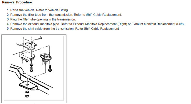

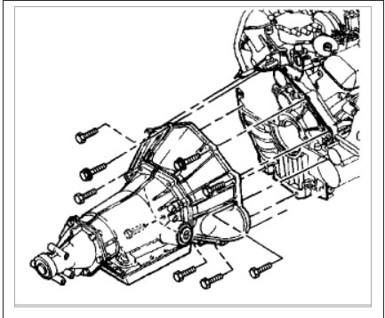

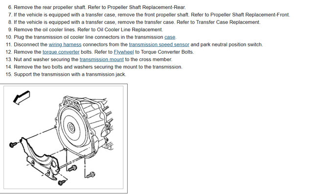

This click noise can be caused by one of two things either you have a loose spark plug or a broken flex plate which means you will need to remove the transmission.
Here is a guide to help you check the spark plugs
https://www.2carpros.com/articles/how-to-change-spark-plugs
This will show you how to remove the transmission to replace the flex plate diagrams (below)
Please let us know what you find.
