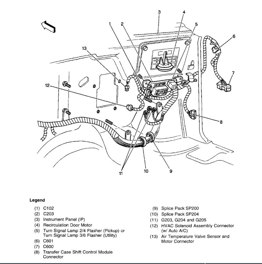

Where is the turn signal flasher located on this vehicle?
Apr 7, 2009 at 9:19 PM
BLUELIGHTNIN6
  • 16,542 POSTS
Front seating area, passenger side, behind dash, under access panel, mounted in fuse panel in glove compartment behind
Thanks for using 2CarPros.com!
See diagram below for location of the flasher relay in your truck
