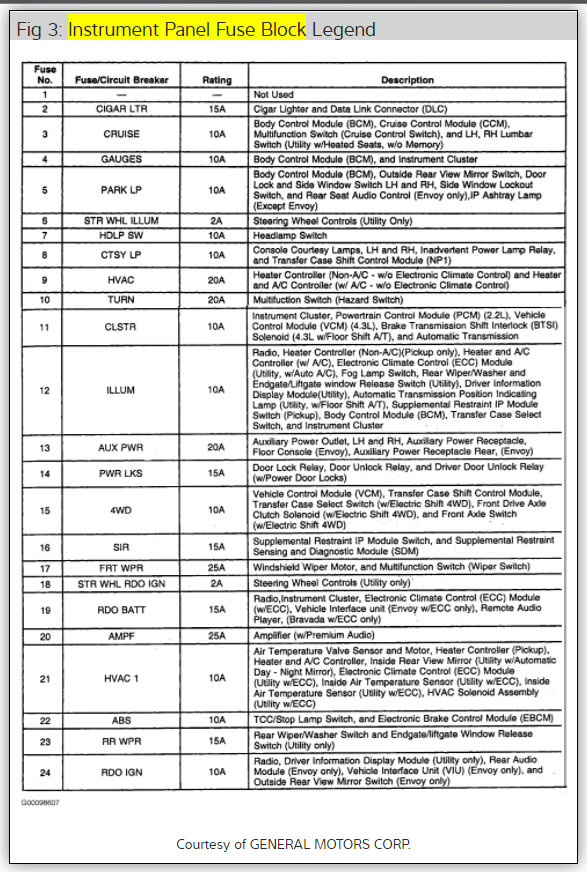

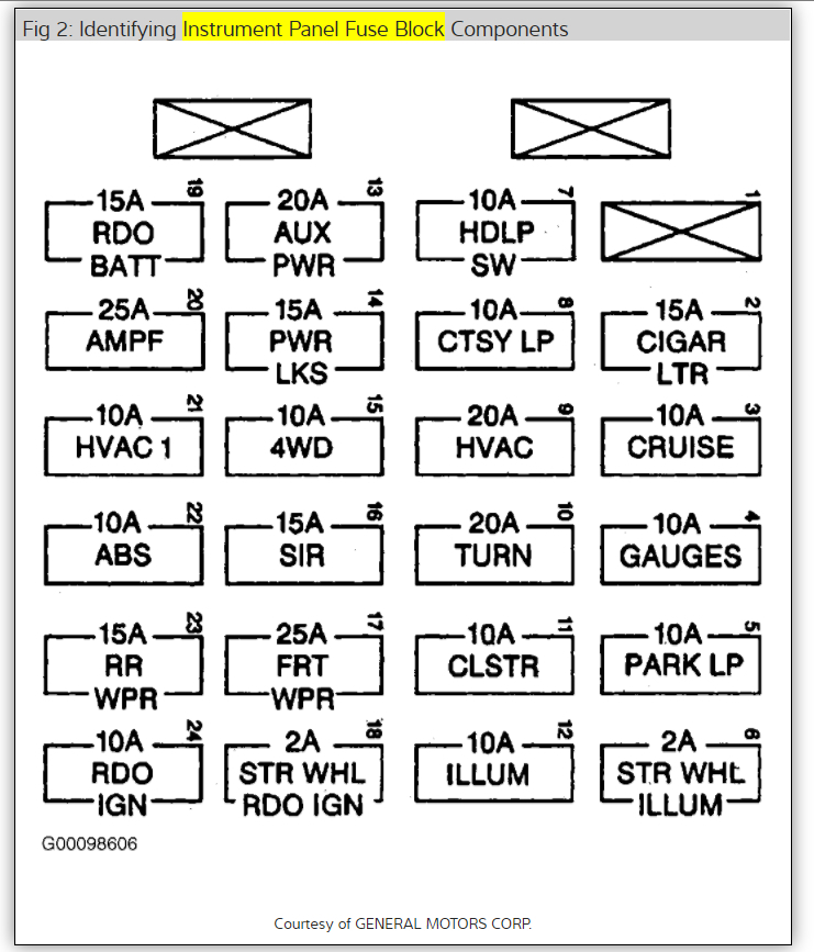

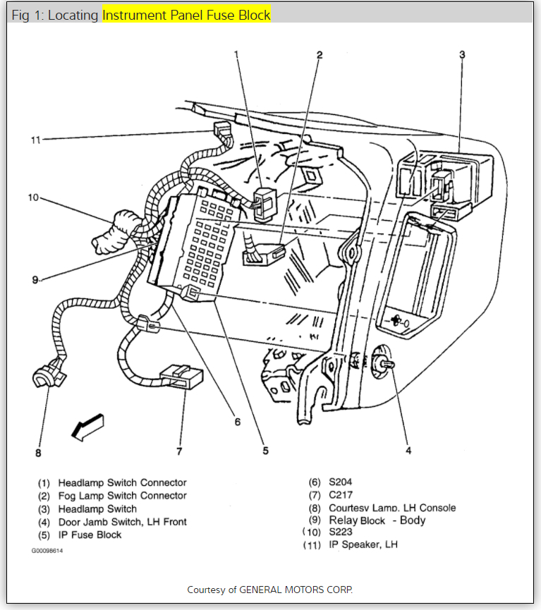

We just saw this problem in the shop please check the dome light fuse it powers the 4WD controller. Here is the location and a guide to help
Check out the diagrams (Below). Please let us know what you find. We are interested to see what it is.

Thank you for this post I had this problem and it was the fuse :) all set I love this site.
