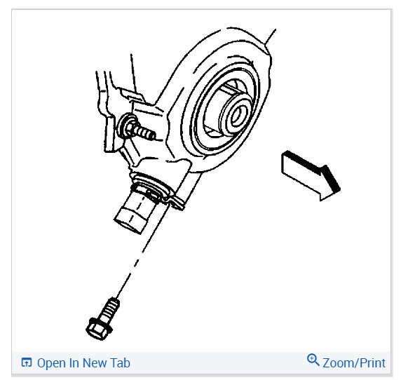

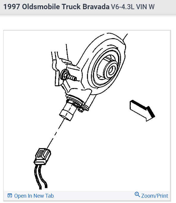

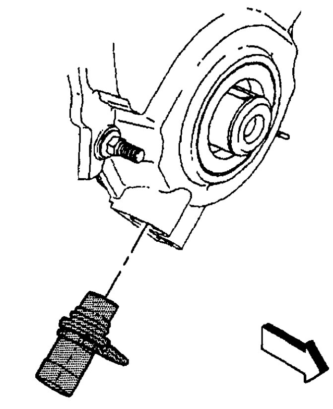

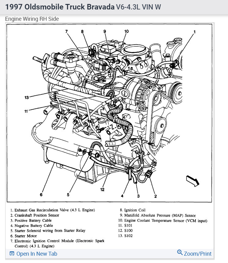

It sounds like the crankshaft angle sensor has gone out by we should check for spark. This video can help.
https://youtu.be/baq_aEWNQ0Y?si=MHWFt1rzwFvsLuCb
If there is no spark here is the location of the crankshaft angle sensor. Check out the images (Below). Please let us know how it goes
