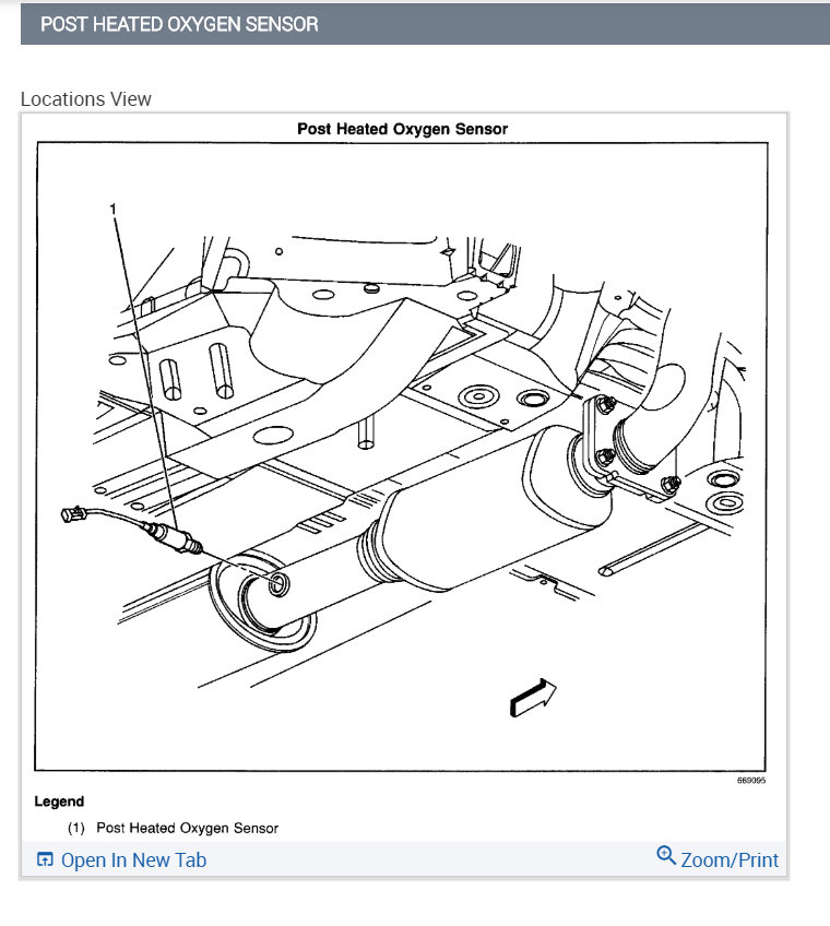

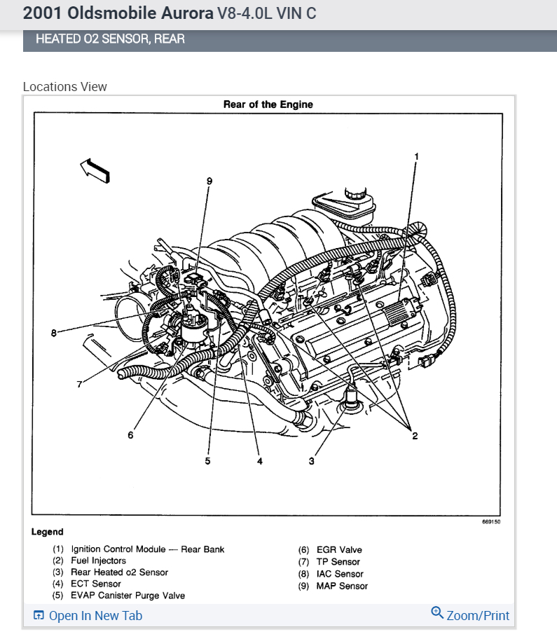

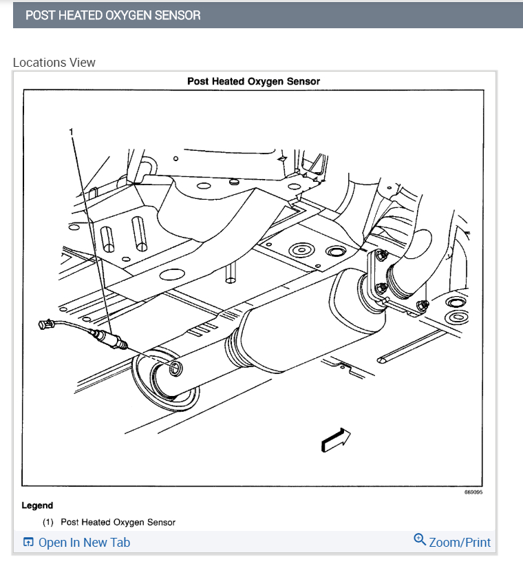

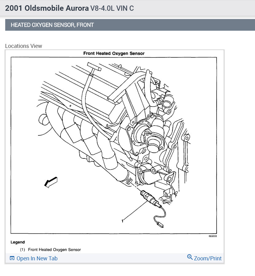

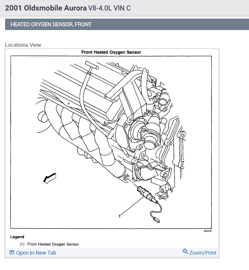

Here is a guide to help walk you through the replacement and diagrams below to show you the oxygen sensor location for your car below.

there are 4. 2 upstream and 2 downstream sensors
they are below the exhaust manifold and the downstream are behind the cat converter
