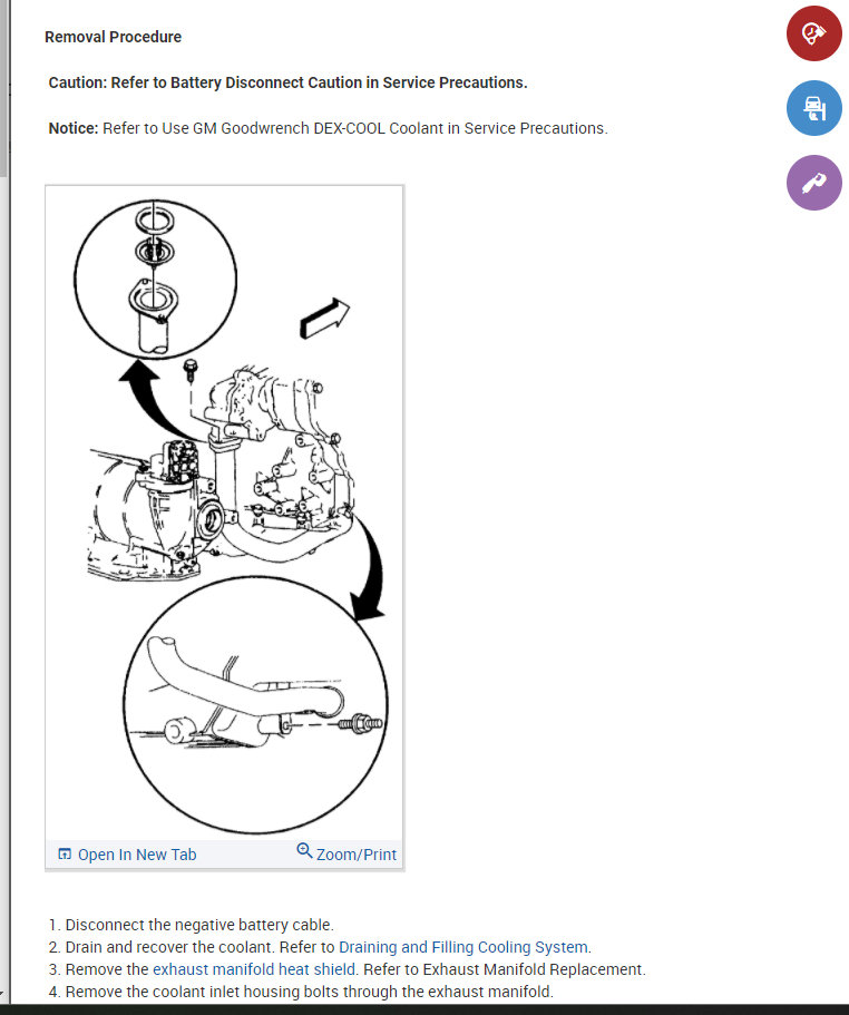

Where is the thermostat located on the car????
Dec 7, 2008 at 2:02 PM

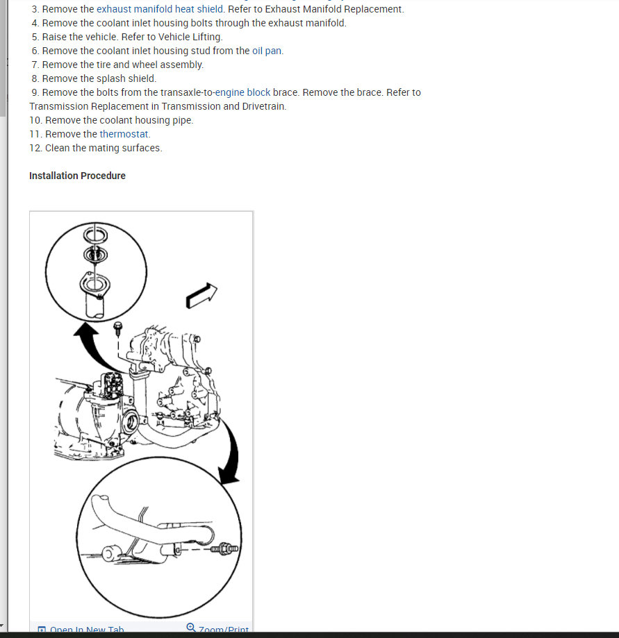

The thermostat is located in the heater hose so I will attached the info for this.
Here is a guide that will help with replacing a thermostat as that will give good info that the manual does not include:

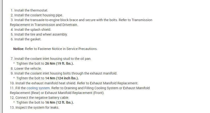

Please find the info below on how to replace this from the manual. Please let us know if you have more questions.
