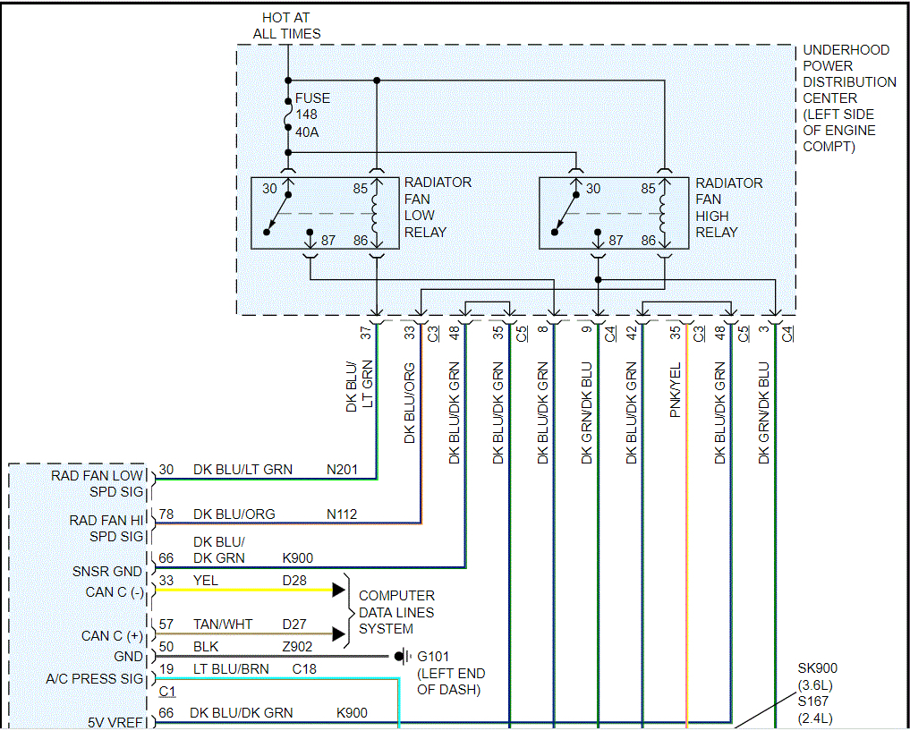

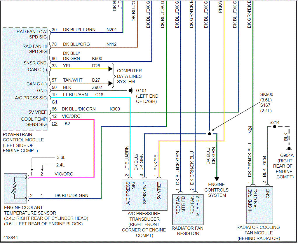

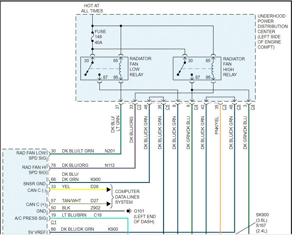

Let me know. Also, when you have a chance, turn on the A/C to see if a fan comes on. Also, I attached the wiring schematic for the cooling fan circuit below so you have it as a reference. I had to cut the pic in half to make it readable, but I did overlap them so you can follow from one to the next.

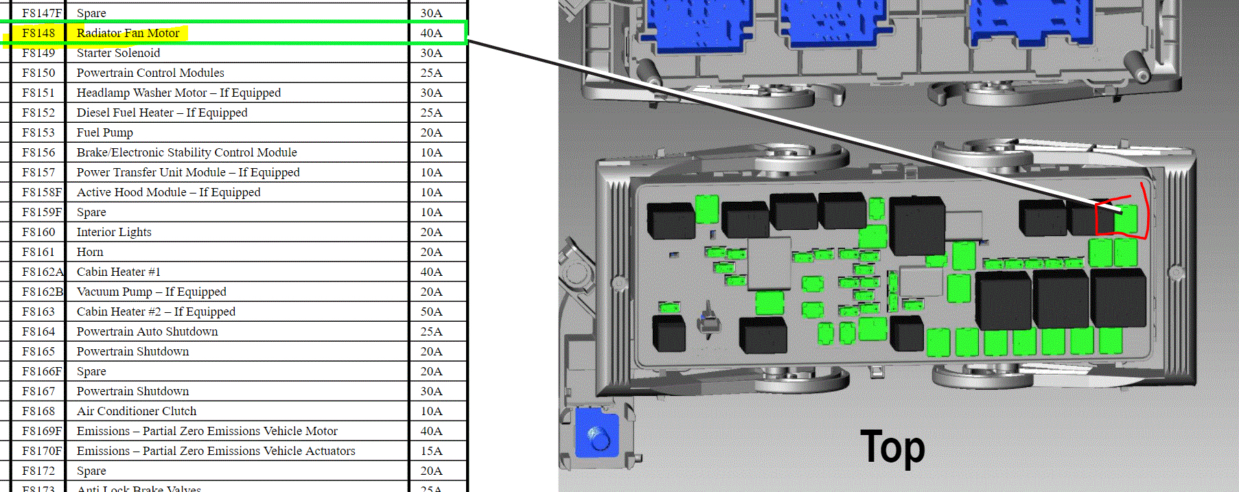

Note: there is a 40 amp fuse that powers the fan motors. It is located under the hood in the power distribution box. Check to make sure it's good. Additionally, make sure there is power to and from the fuse. Here is a link you may find helpful:
Pic 3 indicates the location of fuse 148 for the fan motors. It's in the underhood power distribution box.
See pics below.
