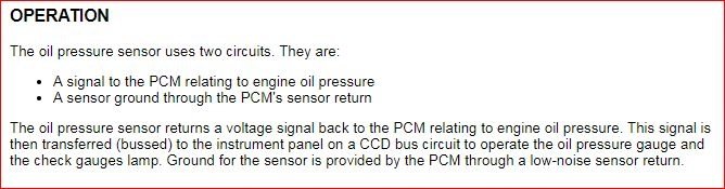

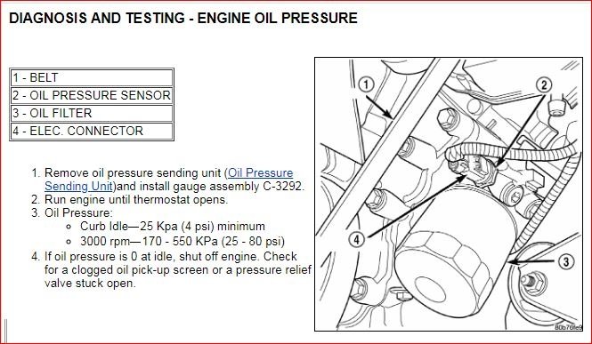

Have you tested the oil pressure with a gauge to see what it is to determine if you actually have a pressure issue?
I attached the process to test it. This still could be a module issue or some other electrical issue but we need to verify good pressure first.
Let me know what your pressure is and we can go from there. Thanks
