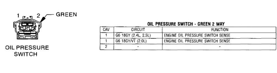

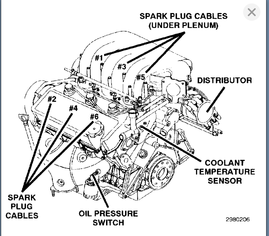

Where is the oil sensor or a regulator located?
Sep 17, 2018 at 3:48 PM
CERTIFIED EXPERT
18,907 POSTS
I am attaching the information requested below.
