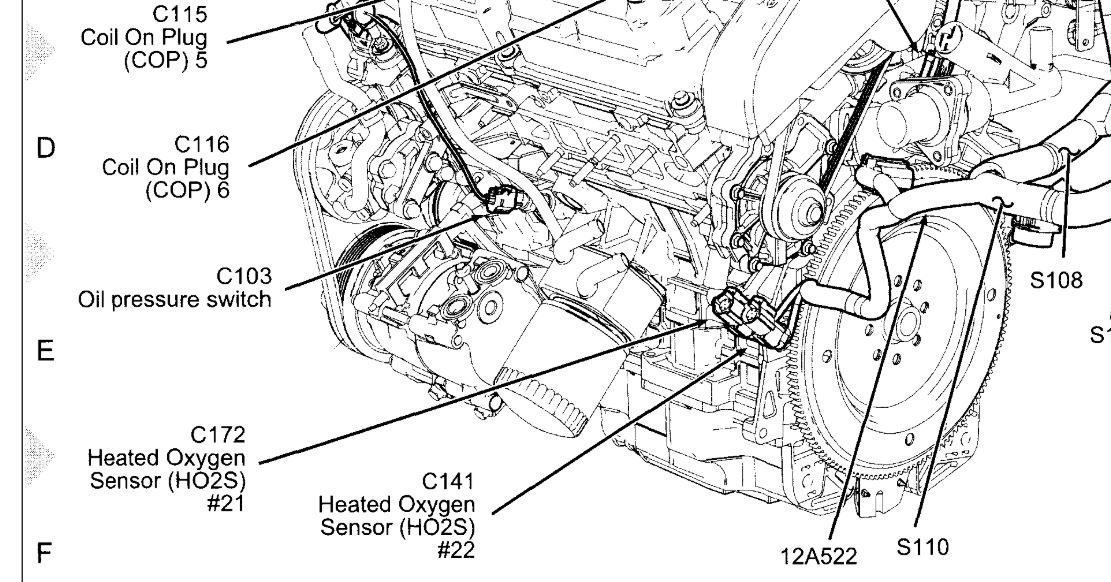

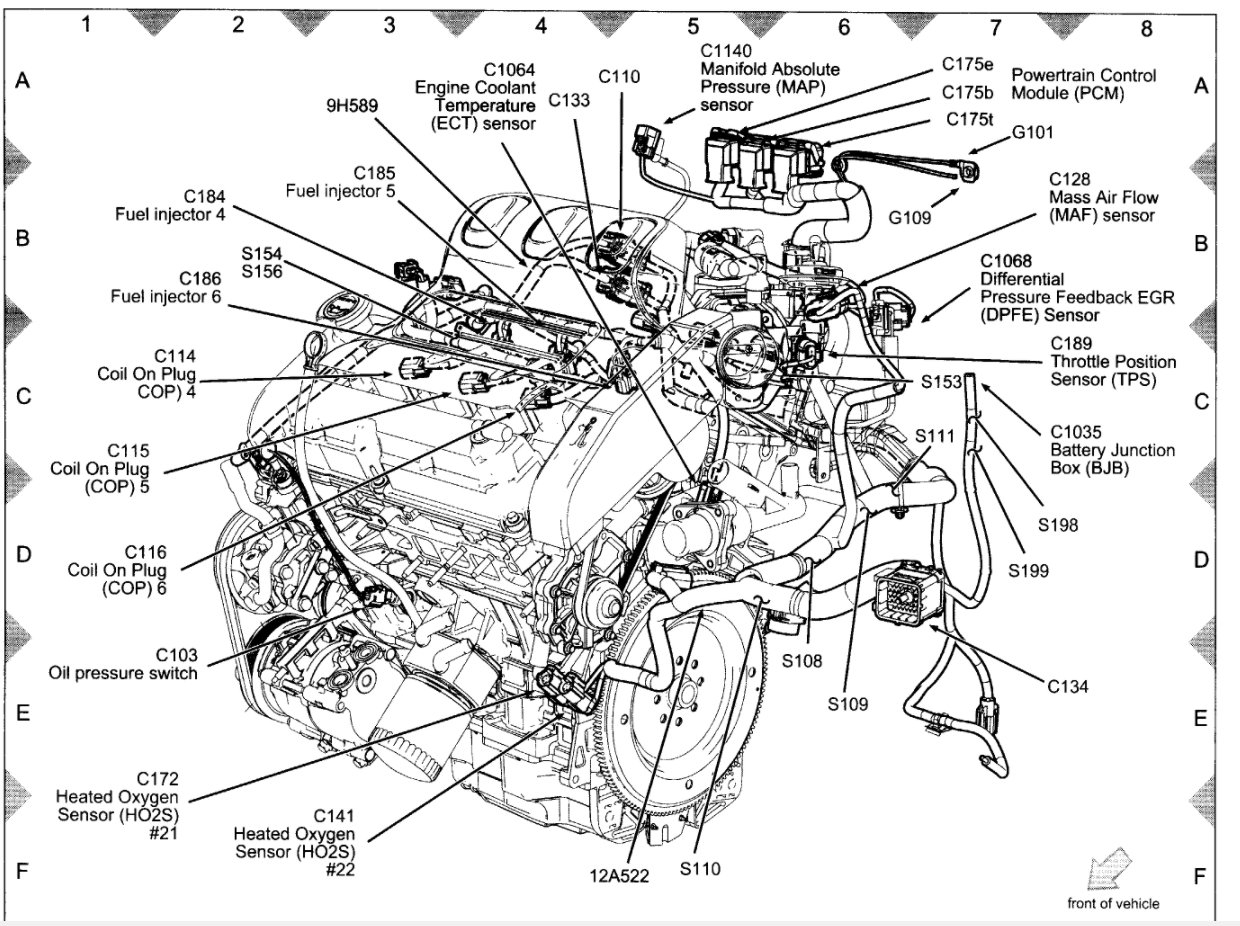

Good morning.
There are two engines for your year. I attached pictures of the location for both the 4 cylinder and V6. Check out the diagrams (Below). Please let us know if you need anything else to get the problem fixed.

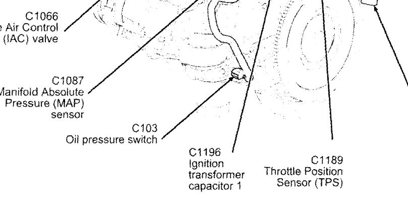

Need to put in new oil pressure sensor. Oil light sometimes comes on while idling. Where is the sensor?
Dec 12, 2020 at 9:20 AM (Merged)
BMDOUBLE
  • 1,139 POSTS
It's near the oil filter location. I've attached a picture.

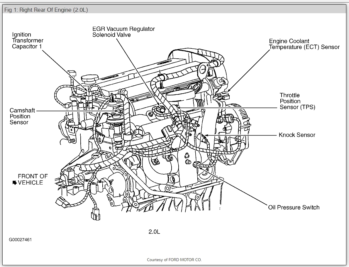

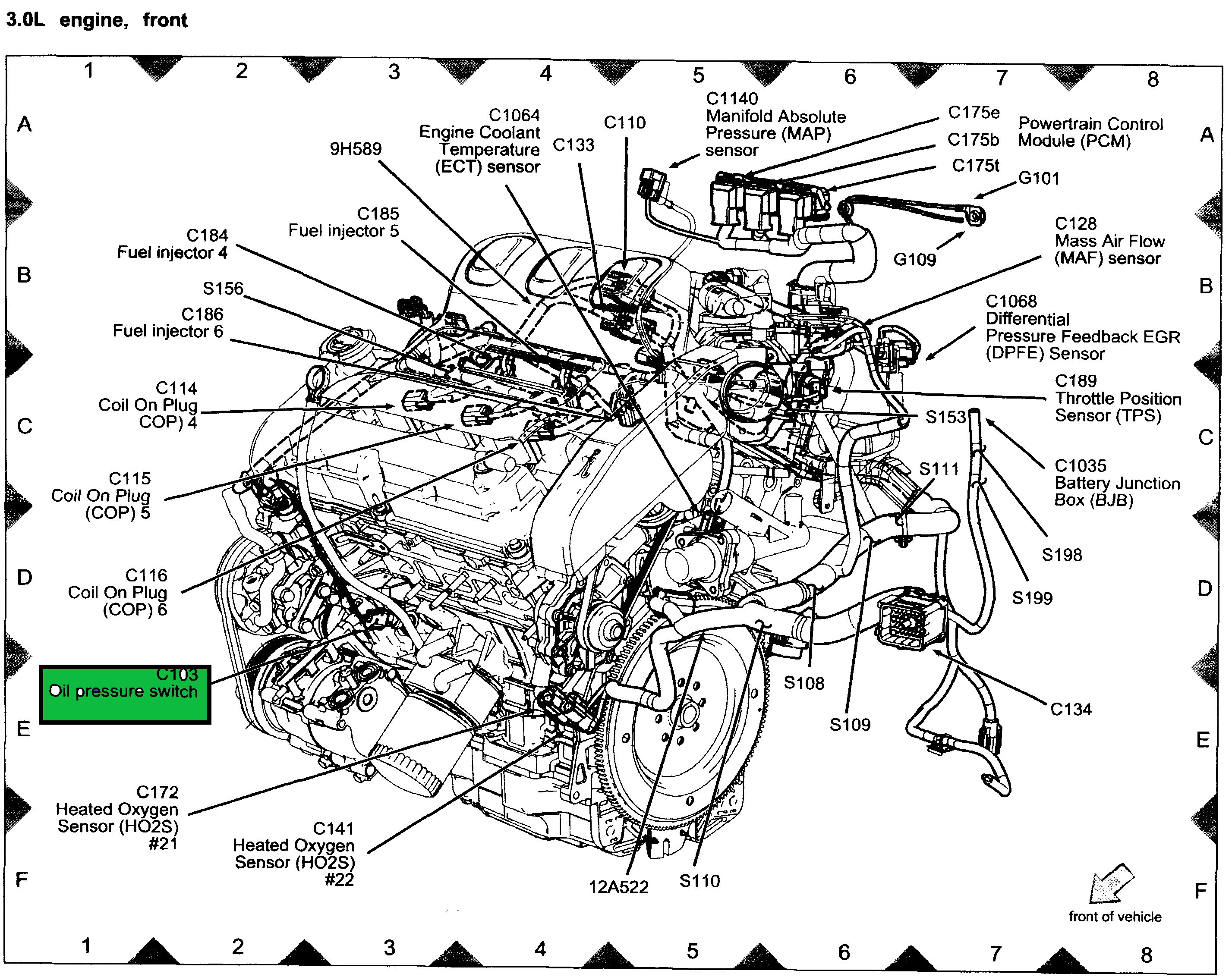

TIMGING
where is the oil pressure sensor location on 2001 Ford Escape v-6
Hey Timging,
Oil Pressure Switch (2.0L)On right rear near the starter under a bracket, here is a diagram (below) to help show you. I have also included the location for the V6 engine as well. Check out the diagrams (Below). Please let us know if you need anything else to get the problem fixed.
