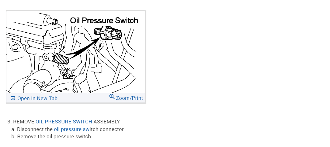

Can't find where the oil pressure sensor is at. The car listed above is the LE model.
Aug 2, 2022 at 2:34 PM
GUSTAVO008
I need to locate oil pressure sensor.
Aug 2, 2022 at 2:39 PM
AL514
  • 5,465 POSTS

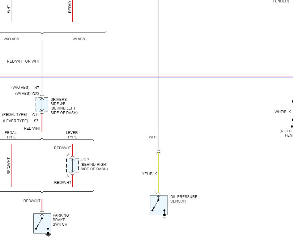

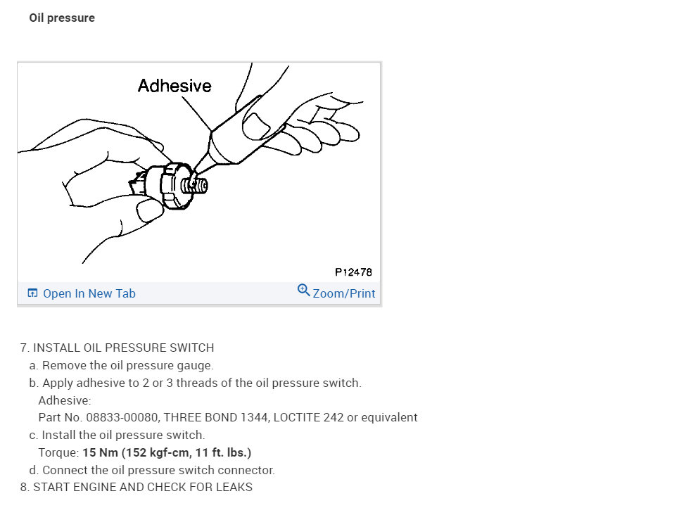

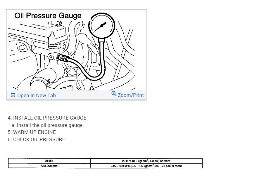

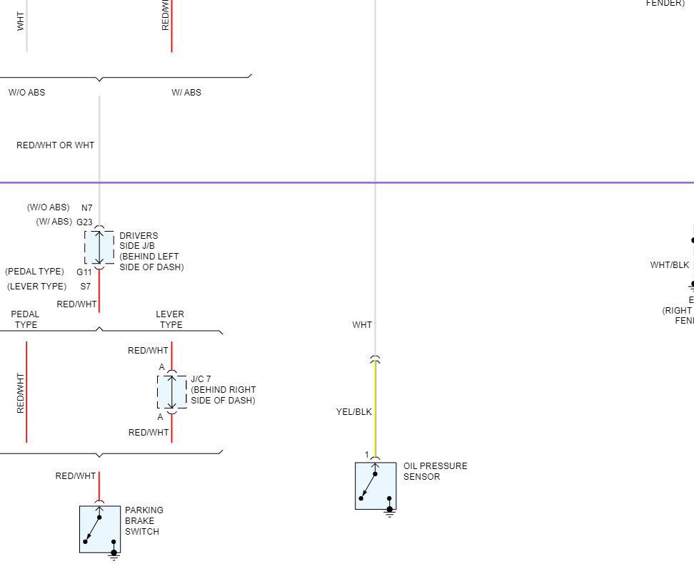

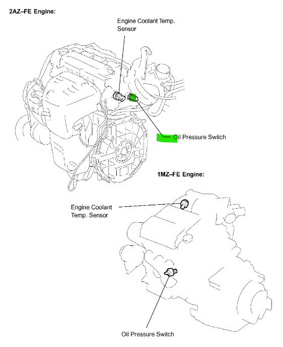

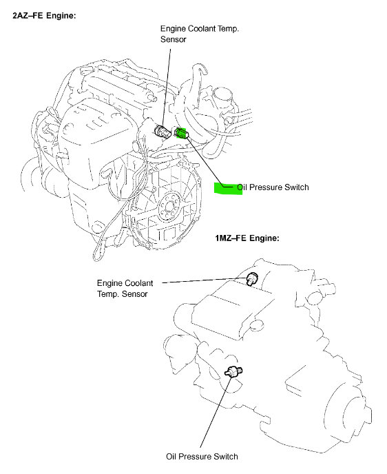

Hello, this is a 2.4 Liter engine, correct? It's actually just an oil pressure switch, it has a yellow/black wire that changes to white at a connector.
https://www.2carpros.com/articles/high-or-low-engine-oil-pressure
