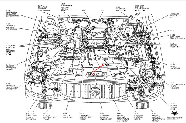

I have the vehicle listed above XLT model. The oil gauge is fluctuating. I suspect the oil sending unit is faulty. I want to replace it but I can't find it on my make and model. I need a picture of its location and I need to know the best way to get to it.
