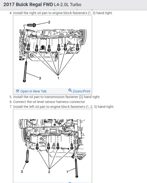

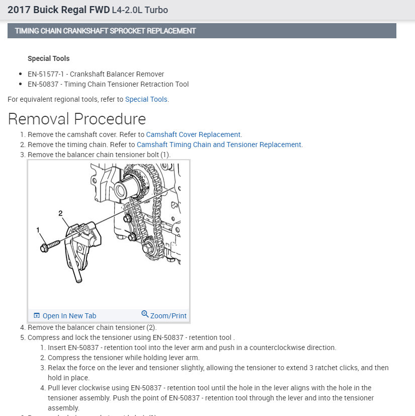

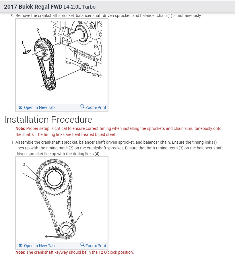

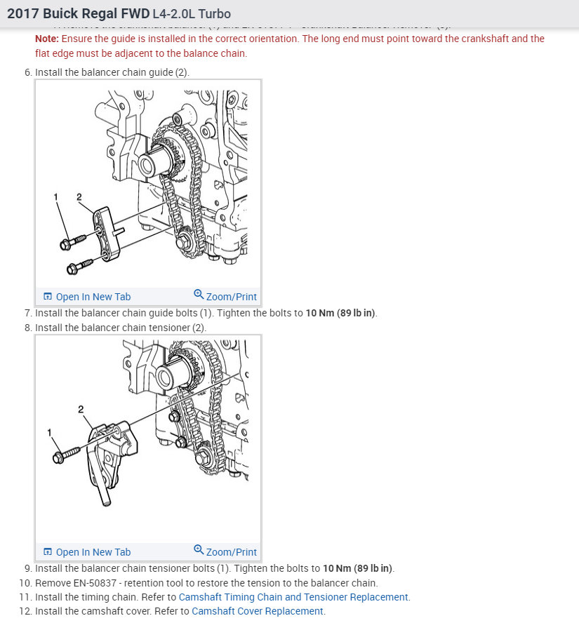

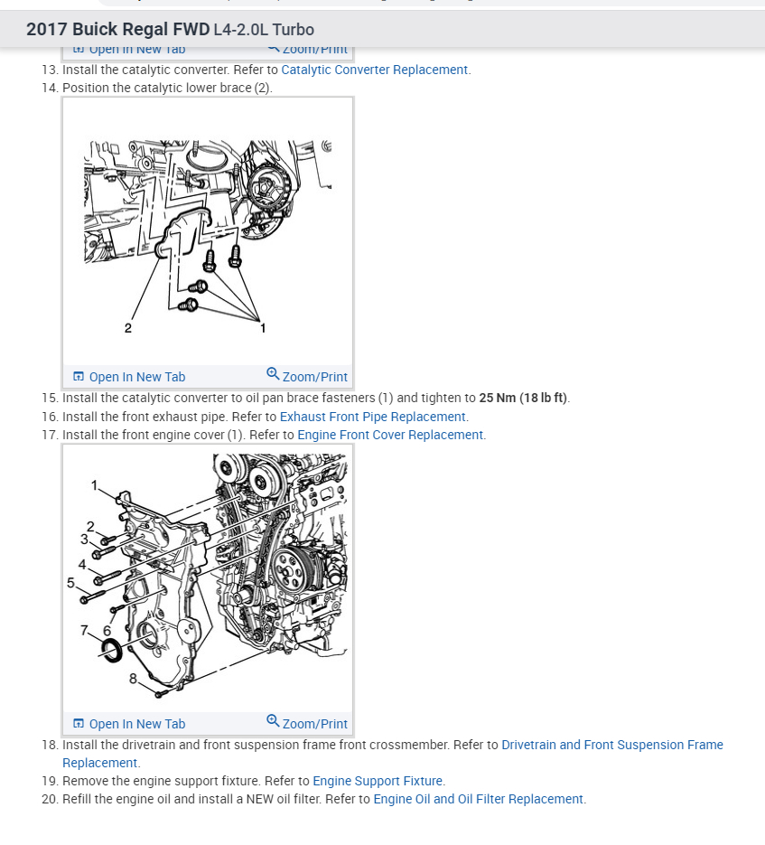

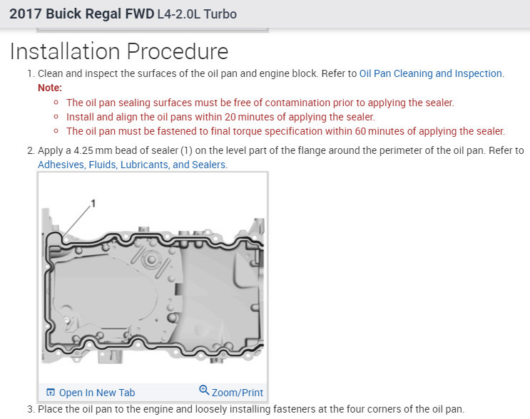

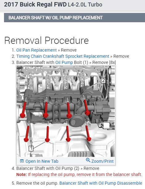

Need steps to remove oil pump.
Apr 9, 2022 at 12:24 AM
SQM
  • 6,383 POSTS

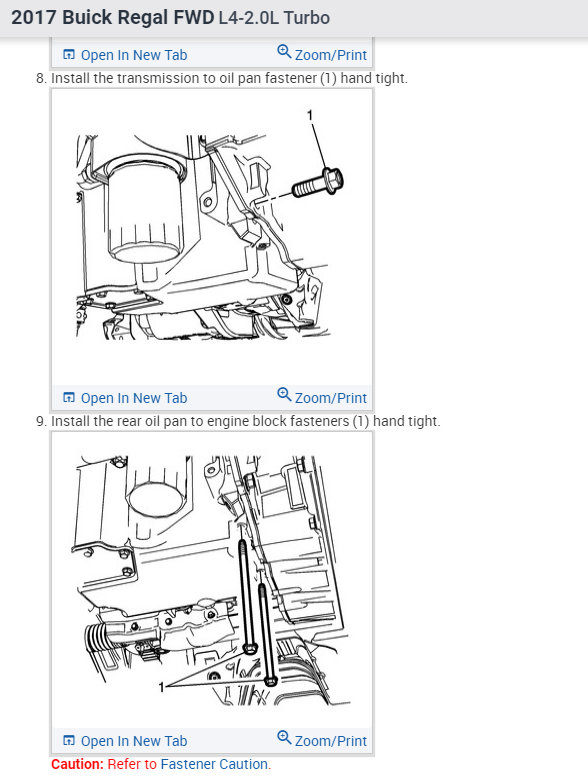

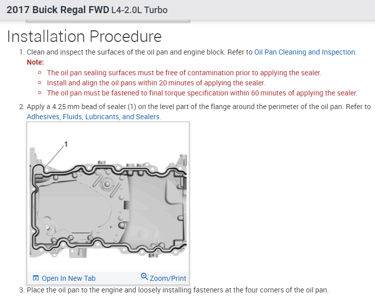

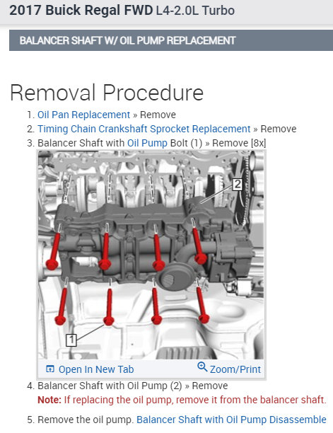

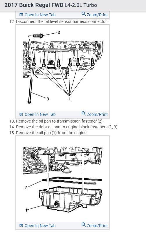

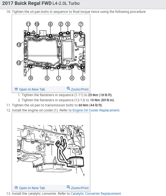

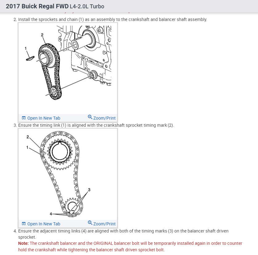

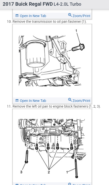

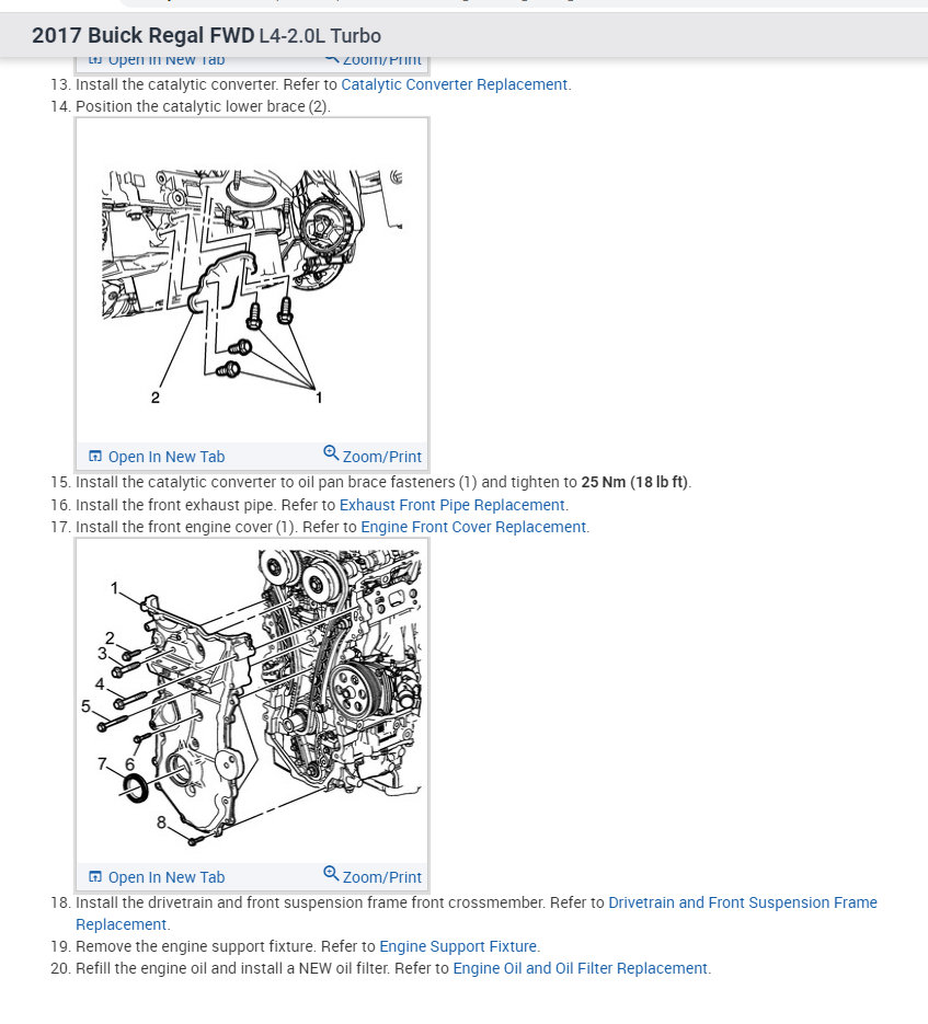

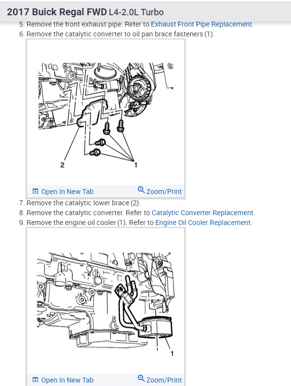

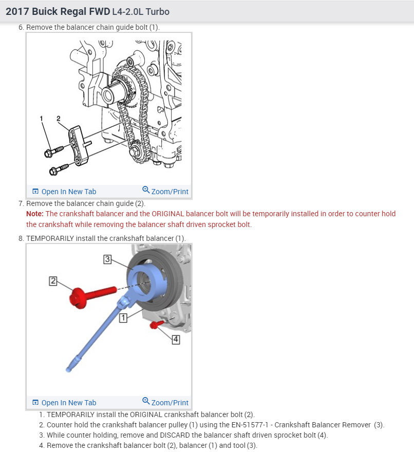

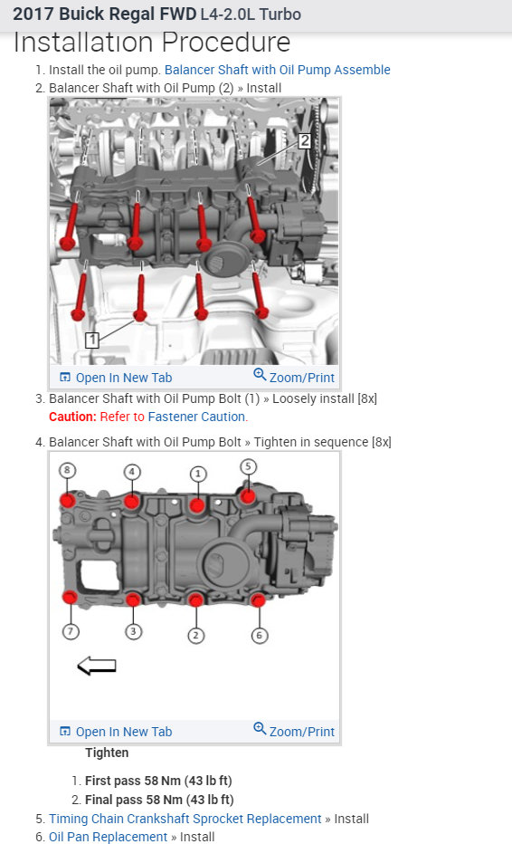

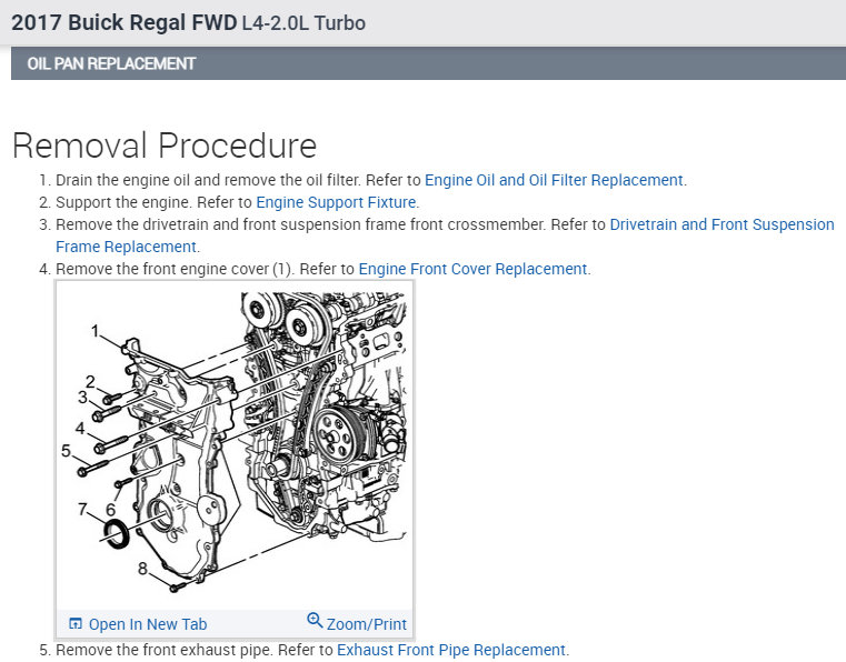

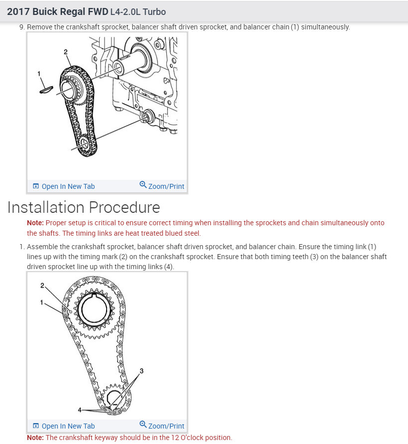

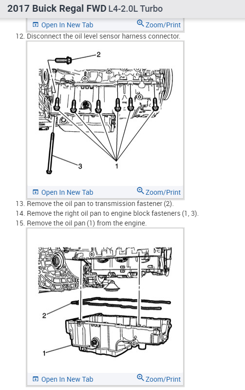

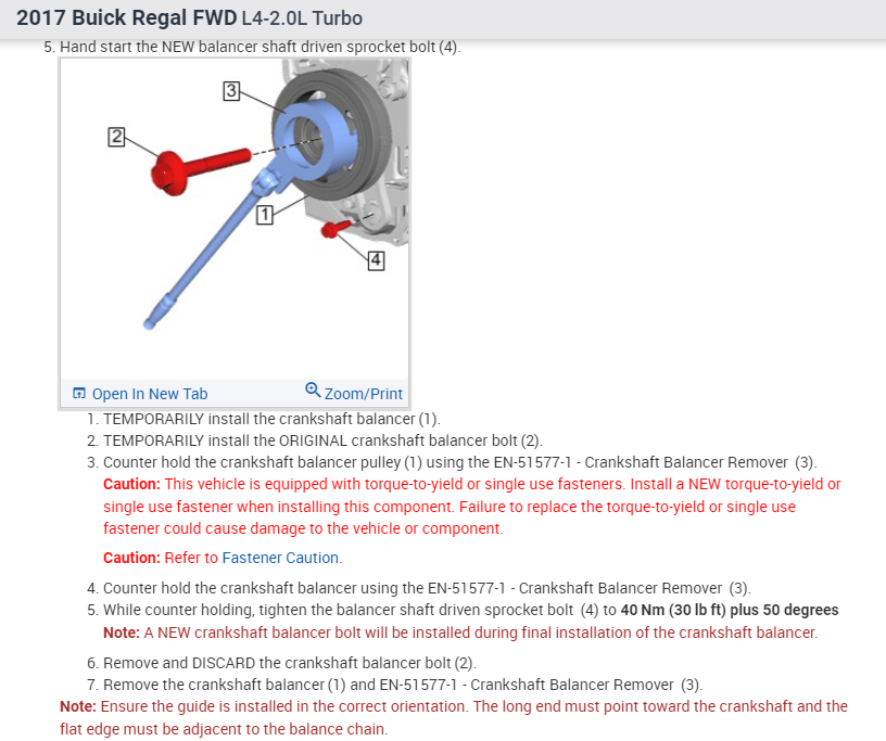

In order to replace the oil pump, first you will have to remove the oil pan as well as the timing chain sprocket.
I have attached all the procedures below, including all the torque specifications as well.
Thank you.
