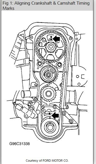

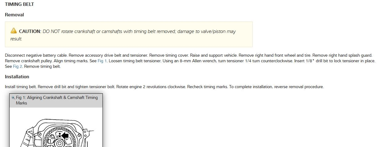

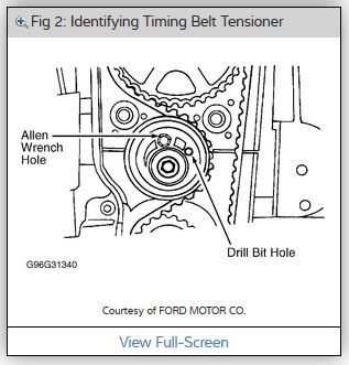

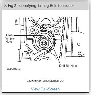

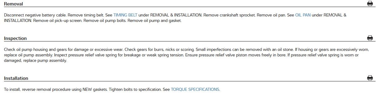

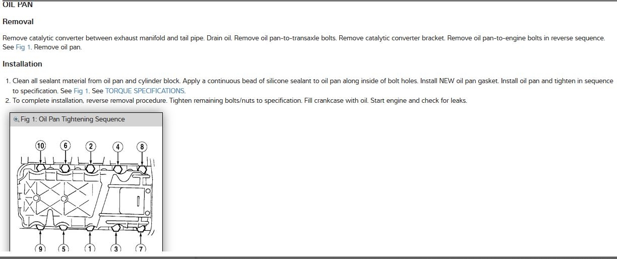

Hi there oil pump information see text and pics. Mark (mhpautos)
