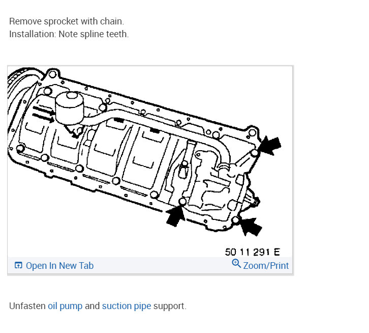

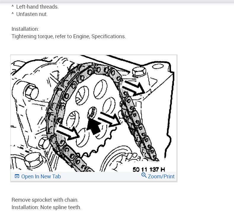

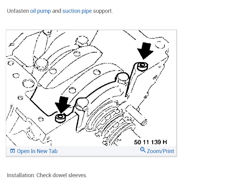

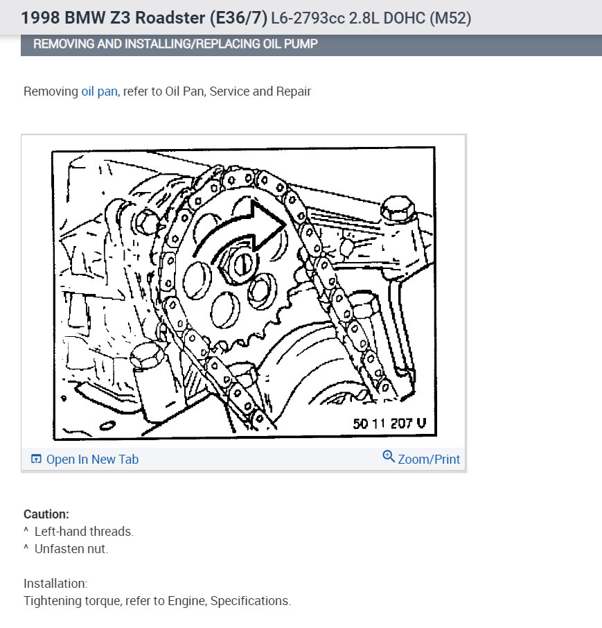

Changed oil for heavier weight. Added Lucas stabilizer. Replaced oil pressure sensor. Checked with oil pressure gauge. Virtually zero at idle 40 at 3,000 RPMs. No noises. Engine starts immediately. No oil use between changes. Little or no signs of blowby. Thinking of changing out oil pump pickup. Need to know if I should also change oil pump. If so, I need instructions especially re chain. Thanks, Mike
