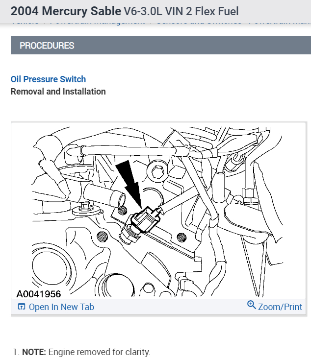

I cannot find the oil pressure sensor to change it out!
Sep 17, 2023 at 3:07 PM
CERTIFIED EXPERT
53,854 POSTS

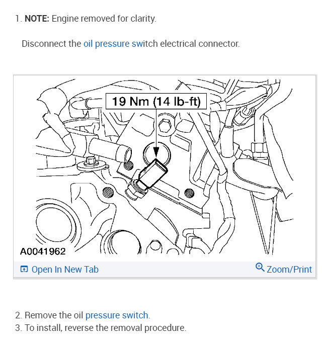

The oil pressure sensor is located at the rear of the engine behind the cylinder head on the right side. Check out the images (below). Please let us know if you need anything else to get the problem fixed.
