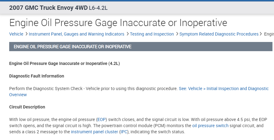

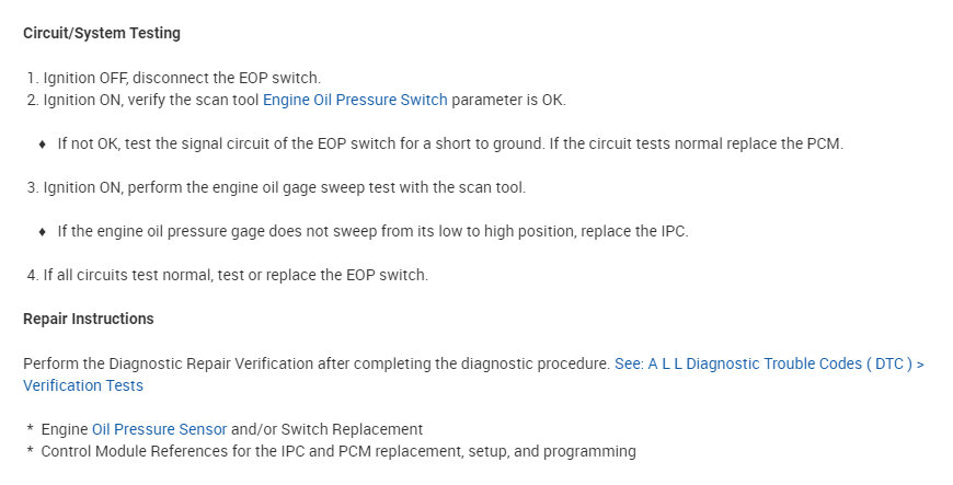

My gauge was fluctuating a little at first but now it stays at 80 PSI. I just changed the pressure switch, but it now just stays at 80 even when the engine is off. Any advice would help.
